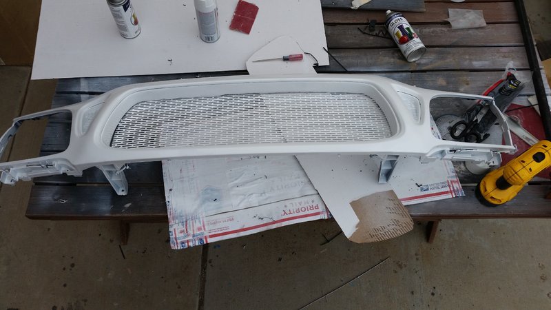

    i know this is late not sure if anyone is still looking at this but I'm going to be making one pretty soon, i read almost all of the posts but i will follow it step by step when i have everything. should i use the combo of bondo and fiberglass? or just bondo? I'm only going to do the middle part of my grille.

    I used both.

    Yea i used both, fiberglass for structoral support abd bondo to smooth it all out

    Thank you for this thread. I just finished the grill an hour ago I love the way it came out.

    [​IMG] I spent the past few days working on it. The bondo and fiberglass were not my forte by any means. But I'm happy with how it came out. I might revisit it and touch up, but for now it should look good unless they stop to inspect it.
    Here it is hanging up to dry tonight. I'll put it on tomorrow. I'd like to put in the metal letters Tacoma across the grill. any suggestions? I heard EGM (fabrication?) does it.

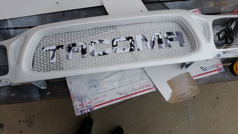

    Thank you my bondo experience wasn't the best but I did tbe best I could. It's not perfect but I like it. For the you can get them from east coast grille fabrication. That's where mine are from. I used 3m double sided tape and centered it as best I could. I'm not sure about uploading pictures I do it from my phone, there should be a upload file button then select the photo you want I'm not sure how you don't multiple photos at once

    It's pretty much the same process my buddy is doing one for his. You just have to buy the mesh and letters if you want. I still have to cut it out to fit mine

    its not the best but its the first time ive ever used bondo and fiber glass, im pretty happy with the way it looks
