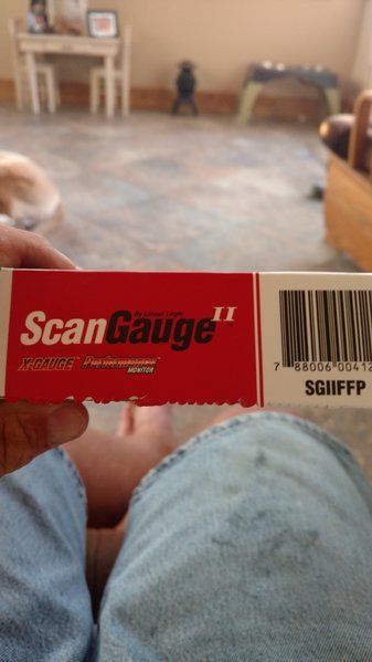

    Is there a specific model number Scangauge for 2016+ ?

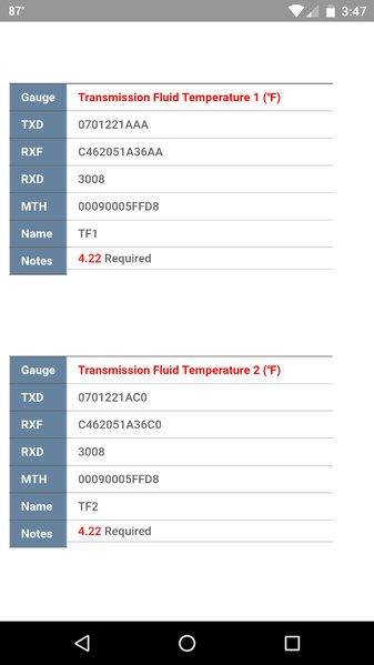

    These are the codes I found on their site and used.

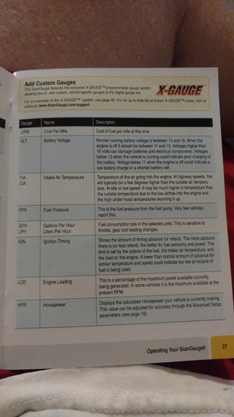

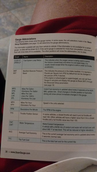

    The screen will display four sensors at a time. Each slot will scroll through all the standard sensors and using xgauges you can add additional sensors like the two transmission temp sensors. It is a code reader and can clear codes. It has the setting that update the unit slow, medium and fast. I have mine set up on medium and would guess it updates every few seconds. I didn't realize all sensors these newer trucks have on them. I have a list of all them I got off the website but don't have it with me right now I will try to post it later. There website is really good and their customer service is really great. It took.me about twenty minutes and I was set. That enough to get you to part with 159.00! Good luck.

    Thanks. The code worked for me. Hopefully it works with the shift sense

    I setup my scangauge today using these codes. I was curious if anyone knew where these 2 sensors are located? They give 2 (slightly) different temps.

    TF1 is in the pan and TF2 is at the converter.
    That's why one is slow to respond but shows the overall temp and the other shows the fluctuations as you drive.
    I use the pan temp for monitoring while towing. The other one would drive you crazy because it's changing so fast..

    The Xcodes are available to change it to metric;
    To monitor the transmission temperature in Celsius, change the MTH from 00090005FFD8 to 00010001FFD8. If you have any questions, please let me know.
