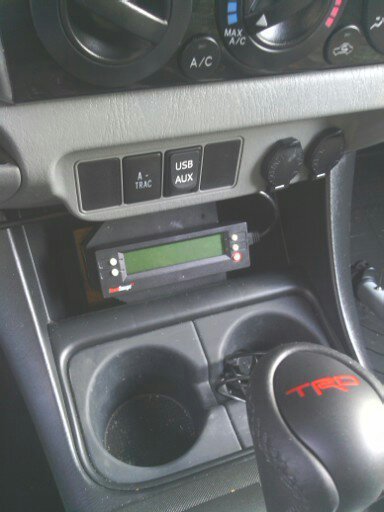

    Purchased the ScanGuage2 and pic of cab location. Found a speedsheet online with several topics to program into the unit. Very satisfied with my purchase.
    DJ Funktacular likes this.
