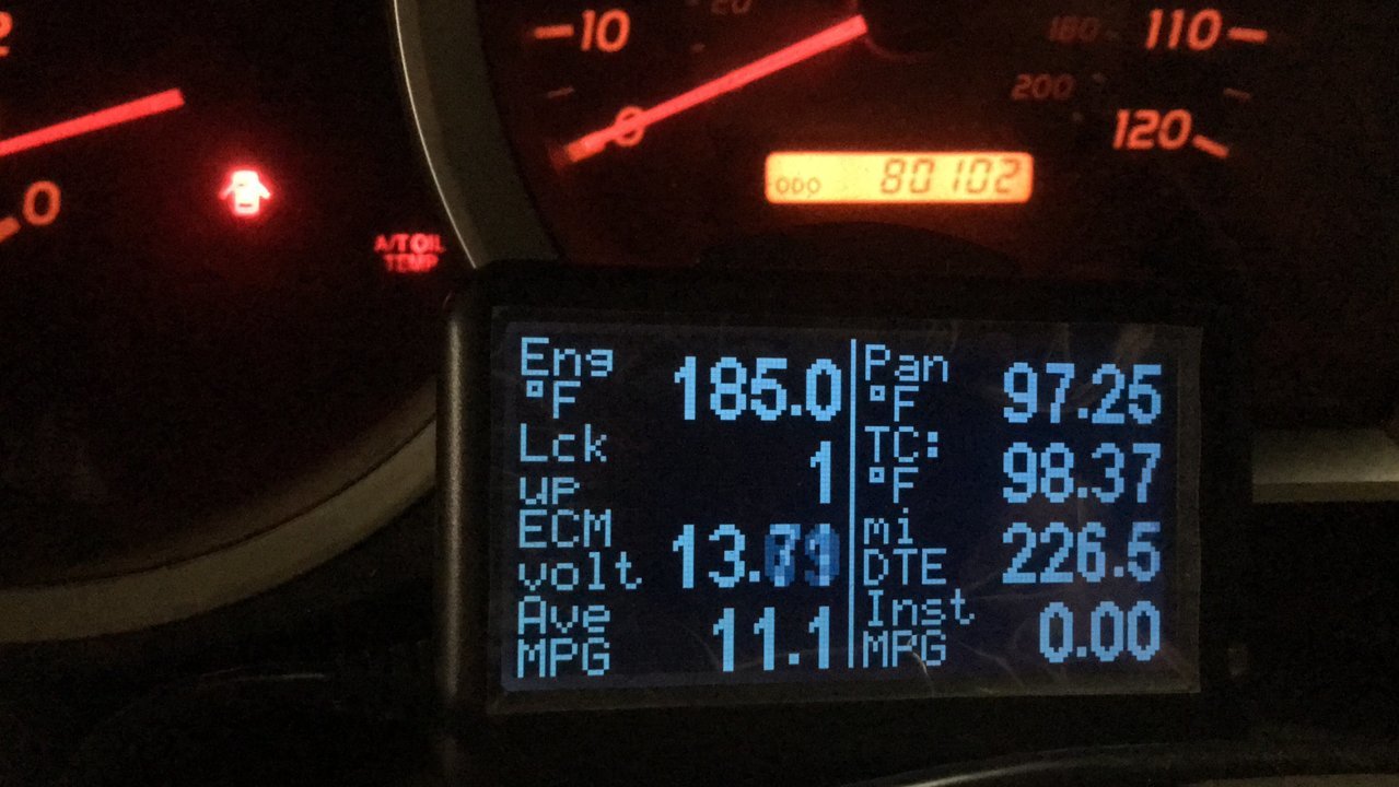

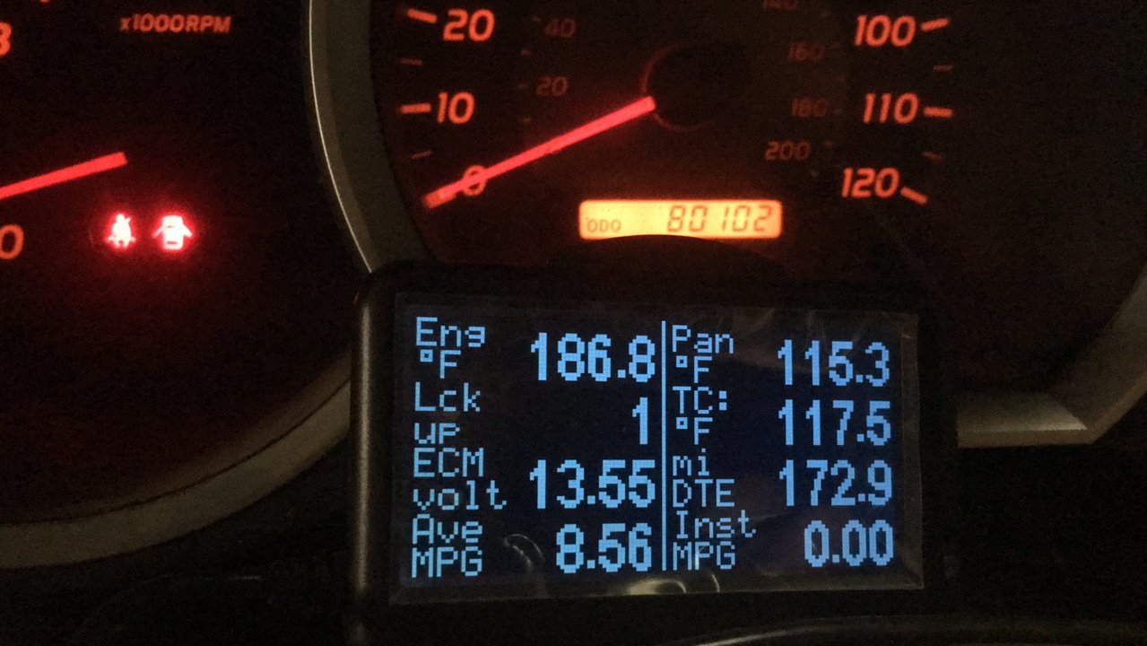

    I checked my fluid level the last time using the temp check mode and verified it using my ultragauge. I initiated temp check mode, then pulled the wire out and plugged my ultragauge in, the temp check range for my truck was 97-115 degrees F at the pan. At idle in park, the pan and TC temps are within a couple of degrees of each other.
