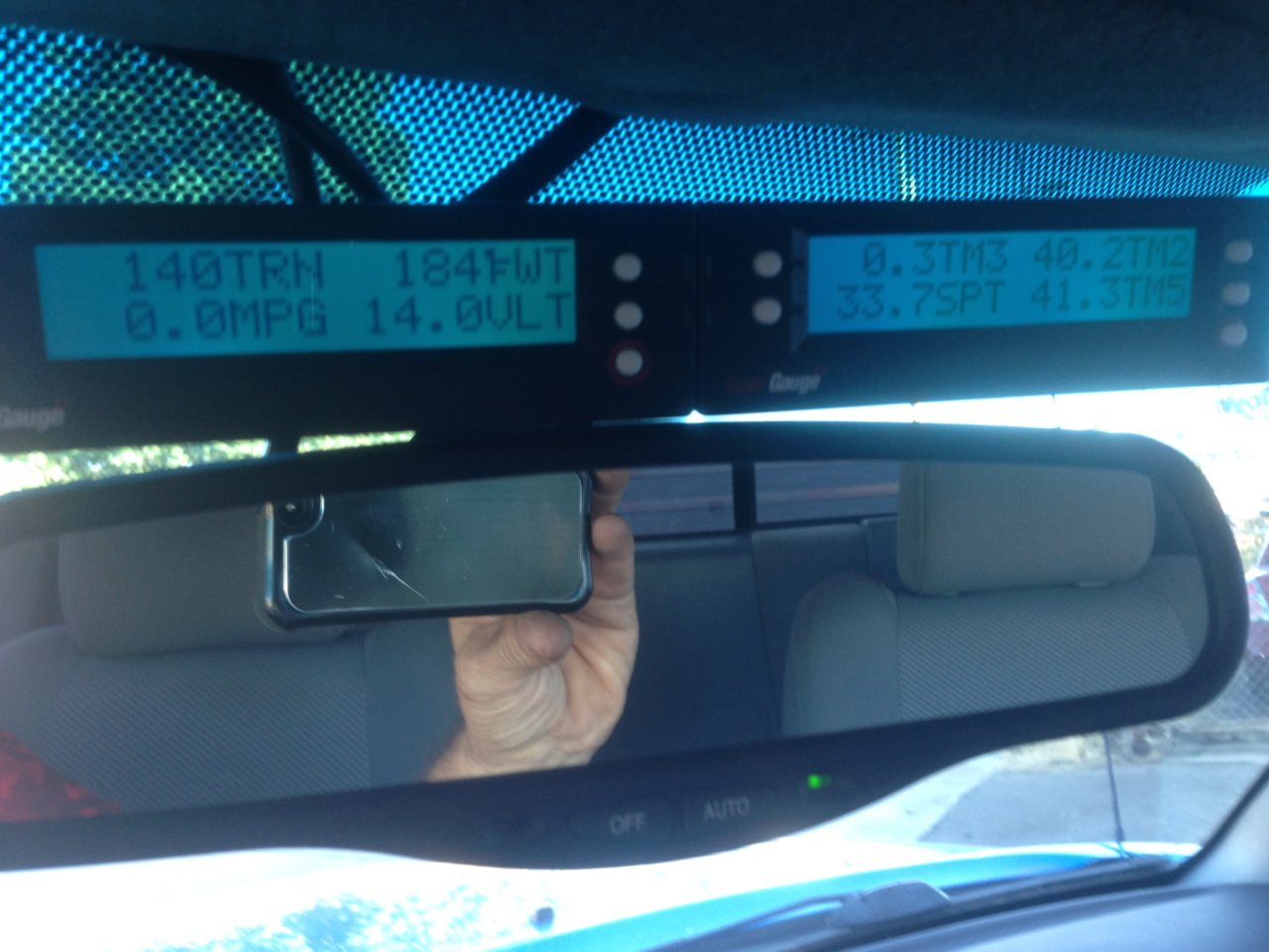

    The only real thing you're missing is the ability to show TPMS pressures. Not a super big deal because it's a pain to switch between different things showing on the screen. I run 2 Scangauges. One has the latest firmware. The other does not. Here's a pic. I don't have all my sensors installed in this pic.

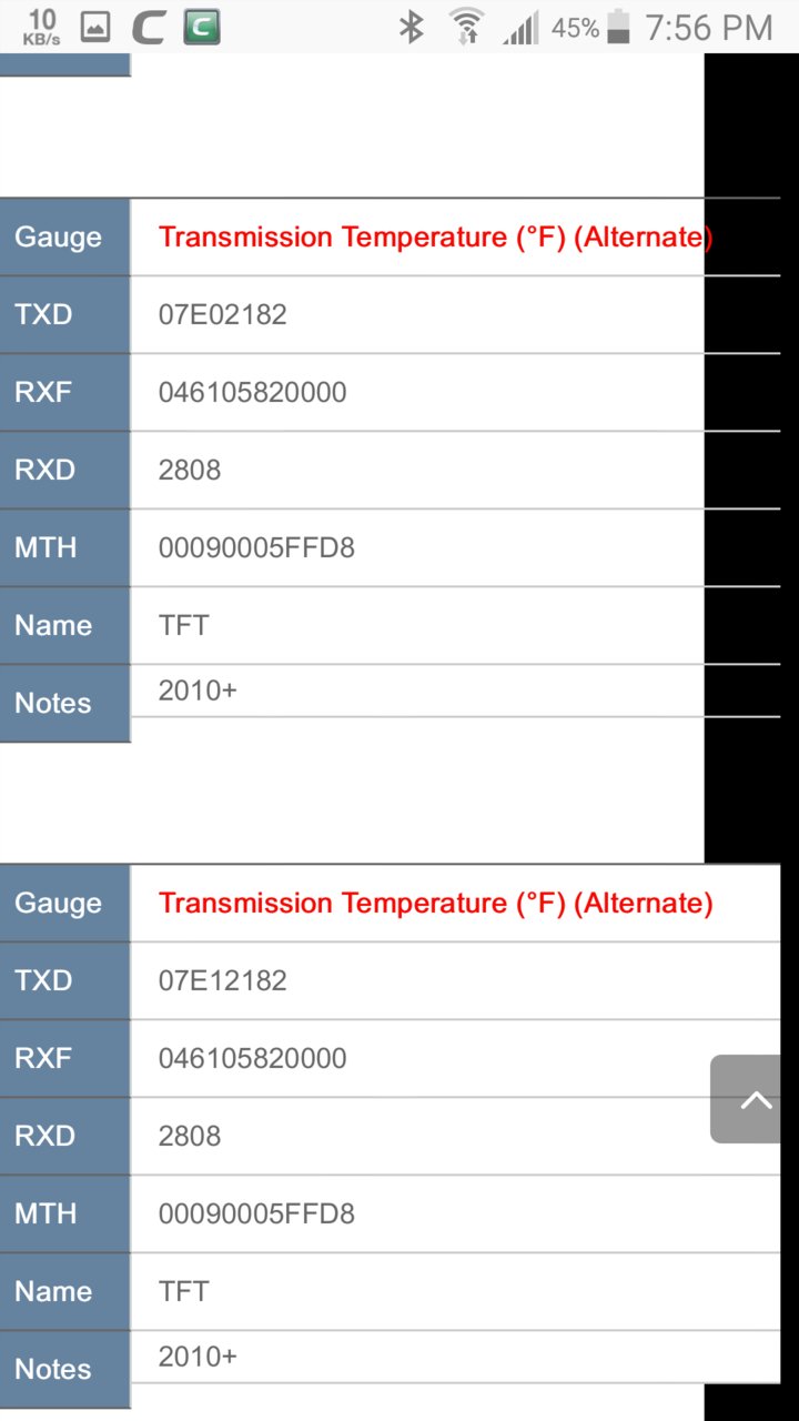

    I have never updated my scangauge II but always wanted the transmission temp sensor to read but have never been able to set the X gauge

    Wow thanks for clarifying that. It would be nice to be able to read TPMS, but I'm not too concerned about it. I think I'd only do it if I decide to run two gauges like you.

  10. Sep 13, 2019 at 2:54 PM
    ancient11
    ancient11 Well-Known Member
    Dec 23, 2013
    #119094
    519
    robert
    tallahassee
    2019 4 cyl srsx ac
    Found these, and many more when on the scangauge websiteScreenshot_2019-09-13-17-51-03.jpg
