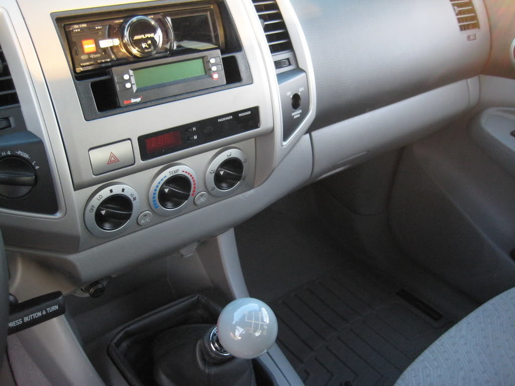

    Has anyone ever thought of mounting the ScanGauge right under the AC control unit? I just ordered a ScanGauge and was wondering if it would work. Thanks.

    Yeah I did, will go get a pic in a bit

    08 TRD Off Road
    The velcro included with the Scangauge didn't hold more then a couple weeks so I went to Home Depot and bought Velcro Brand/Auto designed for vinyl applications and it has stayed put for several months with no sagging since

    Yeah that's why I went under the selector switch, it is easy to see and the buttons are just beyond the shifter so easy to reach.
    Now my eyes just glance down every now and then just like they do for any other gauge on the panel.
    The only time I can't read the display is if the sun is shining directly on the display panel.
    You're gonna love the scangauge, it retaught me shift points and easily paid for itself with fuel savings.
    Before I was getting 16 - 17mpg and after the install if I get below 20 mpg it's cause I'm playing around

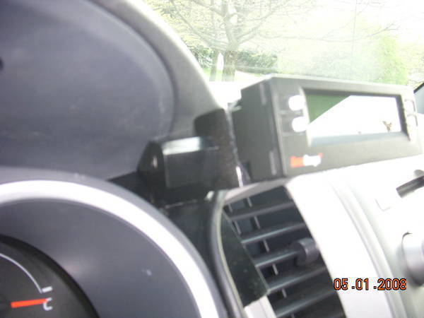

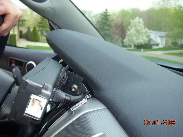

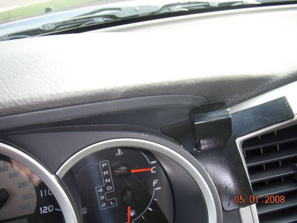

    No problem. What you'll need is some aluminum, some 3M VHB tape and a lot of patience as the construction involves a lot of back and forth from the truck to the workbench. Basically, start with a template for the arced piece before you cut out the alum.
    The first two photos show the two pieces welded together. The entire construction involves (3) alum pieces. I suppose you could bolt the two pieces that I welded but you'll have to use a flat-head screw(s) and make sure they don't come loose (loctite) because once they're taped to the dash, you won't be able to tighten them later.
    The welded-arced piece is mounted to the dash with 3M VHB tape. I forget which one I used but it was gray and I believe .045 thick. Do a google search and you'll have no problem finding it. DO NOT SKIMP - USE THE 3M stuff as I've never had this tape fail on me (i.e. in the sun during the summer, in the exreme cold of N.E. Ohio, etc) in many vehicle applications not just this one.
    The most important and time consuming part of this is to get that arced alum piece to fit to the dash contours. You want the maximum amount of surface area to contact the dash with the VHB tape. I thought about using my kids play-doh to form the contour but ended up just going back and forth and back and forth like 25 times.
    The block (about 3/4" x 3/4" x 1/2" - I don't remember and can't measure it anymore because it's been changed for my Aeroforce gauge) is only tack welded to the arced piece. It's tack welded because too much heat will warp and change the angles of the arced piece that you've worked so hard to form to the dash.
    When I reworked this piece for my Aeroforce gauge, I two-tone painted the arced piece to match the black/silver line of the dash and it blends in even more. See here: http://www.tacomaworld.com/forum/general-automotive/52493-new-aeroforce-interceptor-scan-gauge.html
    Photo below shows the 3rd piece bent at about 100°. Heat this piece before you bend it to minimize cracking it. THIS IS WHERE YOU WILL WANT TO MOUNT THE WELDED-ARC PIECE FIRST (to the dash) BEFORE BENDING THE 3RD PIECE. Having it mounted will help you when you go to measure/test fit the angled piece. The bolt will allow for up and down adjustment but you want to make damn sure you have the left-right angle just right as there is no adjustment in the left-to-right direction after they're bolted together. Do this out in the sun too as I found that the back window would glare onto my gauge at the time so it helped me during fit-up to refine the right angle.
    The ScanGauge below is velcro'ed to the bent bracket. I did this because I wanted to be able to use it to scan trouble codes in other vehicles so I thought it'd be nice to have it quickly removable.
