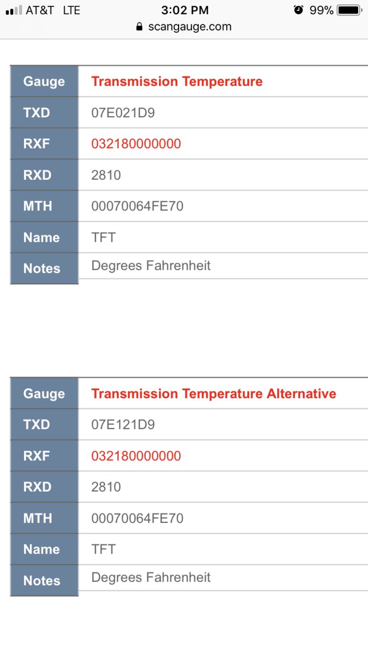

    So the SG website (was) wrong. :annoyed:
    CORRECT CODES:
    per @Trouble_The_Tacoma
    Transmission Temperature 1 (Degrees F) 2010+
    TXD: 07E02182
    RXF: 046105820000
    RXD: 2808
    MTH: 00090005FFD8
    NAM: TF1
    Transmission Temperature 2 (Degrees F) 2010+
    TXD: 07E02182
    RXF: 046105820000
    RXD: 3808
    MTH: 00090005FFD8
    NAM: TF2

    2015 4x4 DCLB TRD Sport
    Exhaust/Supercharger/OME lift
    Installed mine today. Tripled checked the tranny codes. All I get is -480 on tf1 and 2.

    You used these codes?
    TXD: 07E02182
    RXF: 046105820000
    RXD: 2808
    MTH: 00090005FFD8
    NAM: TF1
    TXD: 07E02182
    RXF: 046105820000
    RXD: 3808
    MTH: 00090005FFD8
    NAM: TF2
  12. Aug 29, 2017 at 2:35 PM
    #72
    Dingus
    Dingus Well-Known Member
    May 29, 2015
    #156322
    87
    West slope of the Sierra
    I did. I was missing a zero on the MTH entry. All is 5 by 5 now!

    These codes won’t work on a 2008?
  17. Apr 5, 2018 at 1:02 PM
    #77
    txtaco87
    txtaco87 Budget Travel Hard AF
    Apr 21, 2015
    #153640
    4,291
    Nik
    Houston, Tx
    08 PreRunner DCSB
    PreRun hard AF
    Never mind figured it all out for my 2008
    Code #1 worked for me
