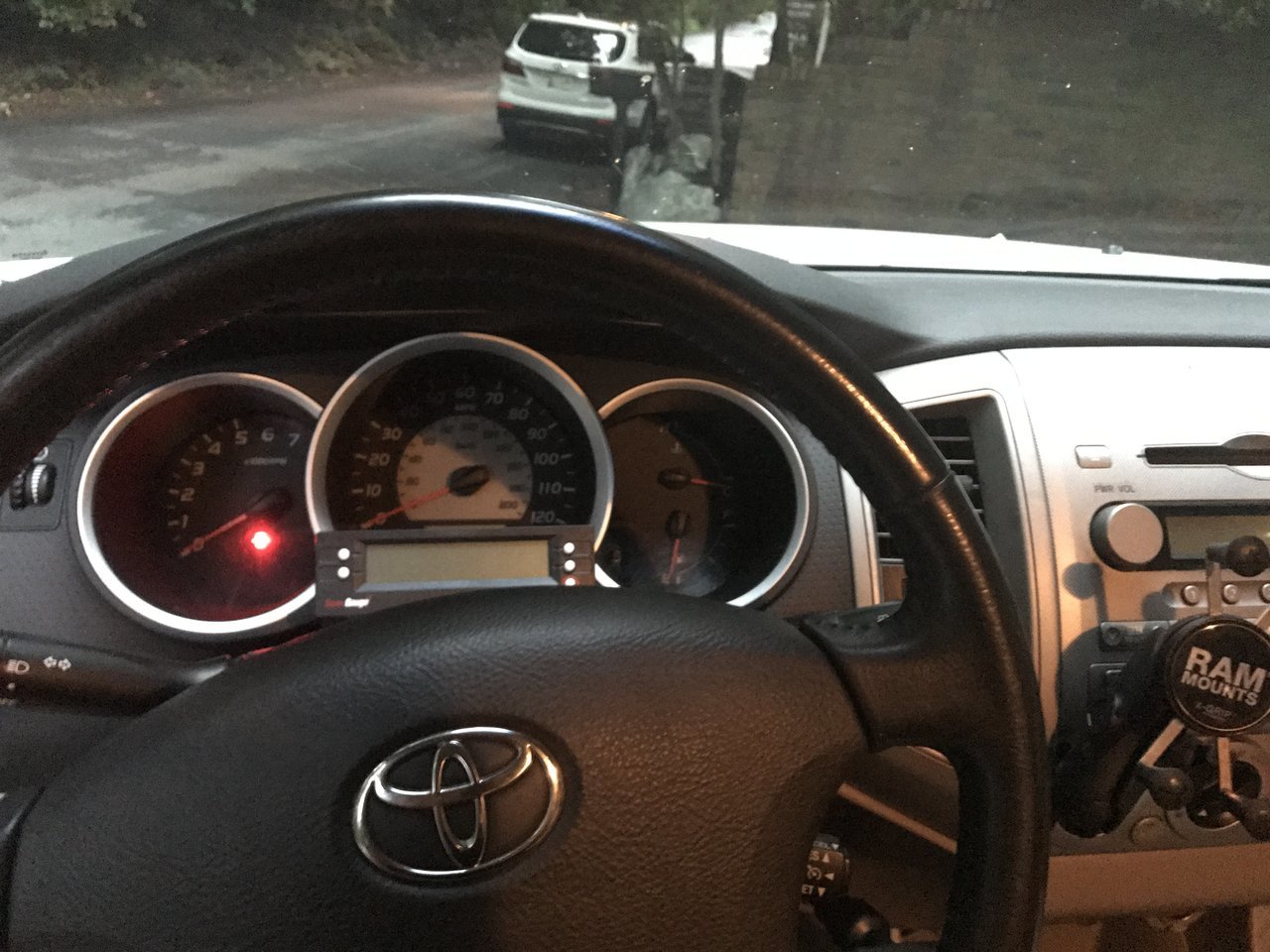

    I decided to mount mine here. Very easy and in the natural line of sight. IMG_1010.jpg

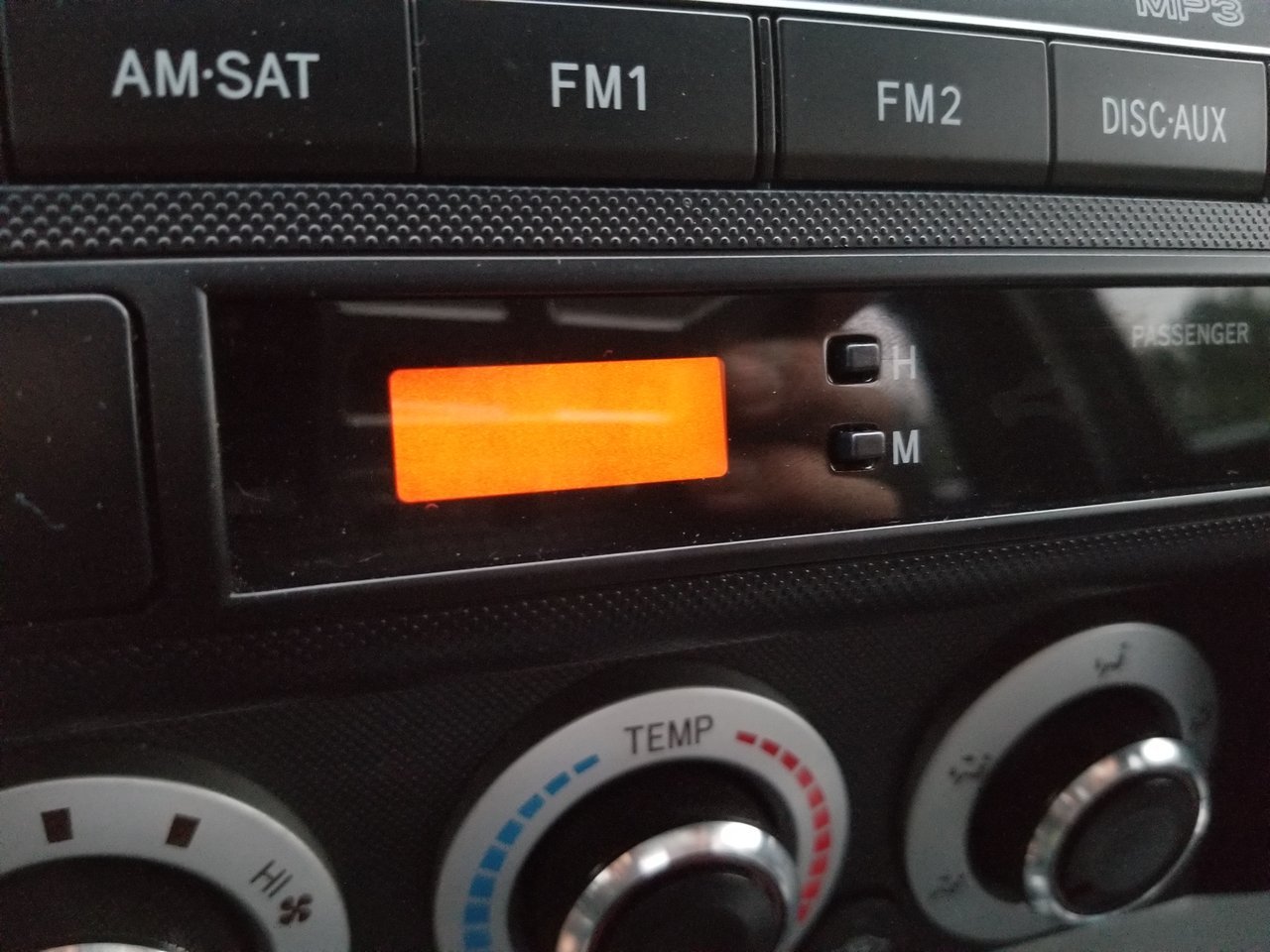

    Got mine!
    But then my clock stopped working... any ideas? Pretty frustrated about this. Amber light still works just lacking numbers

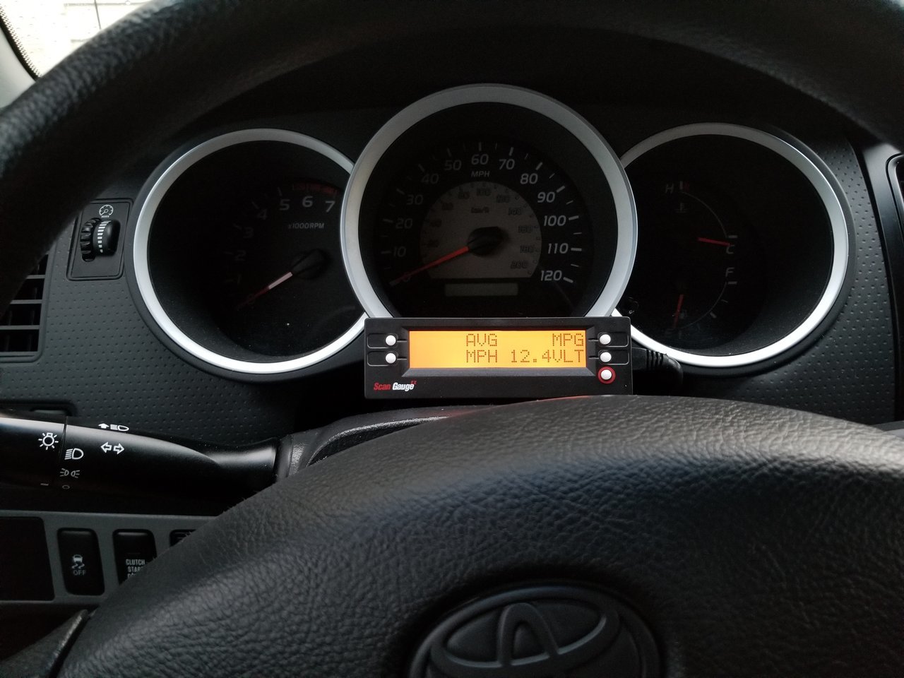

    Strange. The only thing I can think of is your battery. I noticed my SG was powered up even without the key in the ignition, though the back light was out it also had no data in the display when I pressed the button. Is it the same symptoms when started? 12.4 vdc is kind of low.....

    When you first plug the SGII into the truck it will turn on since there is always current flowing to the ODB2 connector. After its first connection it only turns on when the vehicle is running.
    As to the clock going out, unless it is due to low voltage (does it come back on with the truck running?) I am guessing that it is only a coincidence that it went out with the addition of the SGII.
    Mine took all of 10 minutes to install after the BBT left, to include programming the XGauge for Trans Temp. And the clock still works.

    Thanks. I may have it figured out. Raining now so I wont confirm til the morning.. but I noticed that my dome and map lights are out as well. I will check the fuse.
    I have foot well LEDs on the dome light circuit, and while I was running the SG cable behind the steering wheel, I decided to give an extra cinch on the zip tie that's holding the section of LED strip in place. I think that cinch shorted the strip.. cheap roll-type led strip.
    Strange thing is the clock is on the dome light circuit.
    This is all in theory. Otherwise I f'ed something up big time.
    fingers crossed...
    Photo was taken with the engine off, when it's running it reads 13.7v
