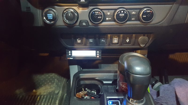

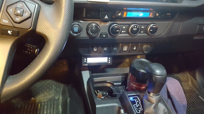

    Scangauge up and running. Sweet. Around town indicating about 175F.20160617_184443.jpg 20160617_184422.jpg

    Congrats...can you see it easily down there? I bought a window mount so I can just glance to the side at it.

    Very easy to see. But more important to me, is during daylight hours it's clear, and with nighttime illumination it's not distracting as I drive with very low lighting.
    I also wanted it down low so as to 1) be out of direct sunlight, and 2) not in direct view to passerbyers.

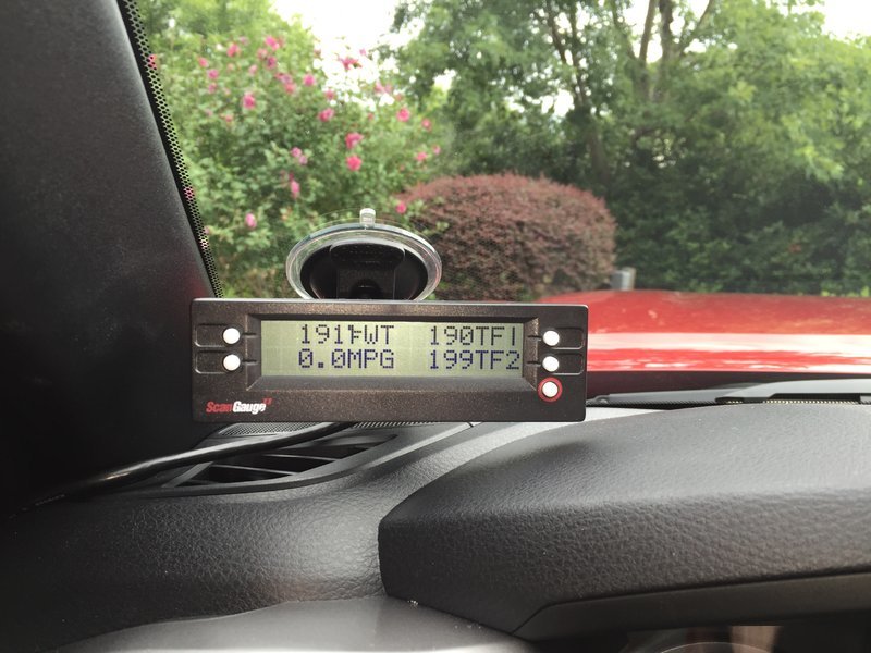

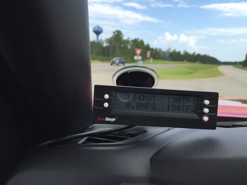

    Drove down to the piers in Biloxi to buy some shrimp off the boats this morning and took photos of the ScanGauge on the way home. In highway driving (70 mph) both TF1 and TF2 read about the same, at one time they were both 190dF and a while later they were both 192dF. When stopped for turning the lower number would go up, the highest I saw was 199dF when I stopped at home.image.jpgimage.jpgimage.jpg

    kinda odd that the temps are the same. previous setups had a bigger difference between the two temps. readings came from the pan and the converter.
    the pan temp should be way lower than the converter temp.

    This was highway driving..I was under the impression that the temps would be close if the converter was locked as it is in that kind of driving. I didn't take photos of stop and go driving because 1) it's not safe and 2) I didn't have time even if it were. The bottom temp in that case was higher as you can see in the last photo which was a short bit of stop and go into my driveway.
