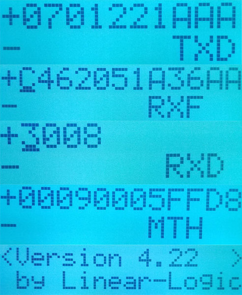

    I have no hope right now. :pout:
    From post #12 (and LL website):
    Transmission Temperature 1 (Degrees Fahrenheit)
    TXD: 0701221AAA
    RXF: C462051A36AA
    RXD: 3008
    MTH: 00090005FFD8
    From my SGII:

    I double-double checked your work. It looks legit. Maybe give Linear Logic a call. They are really good at customer support.

    did you also enable TF2? What does it say on the main screen when you choose to display TF1 and/or TF2?

    Tried both. Both show a big fat blank.
    Could there be some other setting that might be affecting me? Something like PIDS all vs PIDS supported? Update rate? (I think I have just about tried every permutation.)
    I'll mess with it a little more then contact Linear Logic. I'm just worried Toyota changed something. I probably got the most recently built truck possible (ordered from San Antonio to the distrubution center in Houston to the 'burbs). I also have one of the oldest SGIIs (like 10 yrs???).

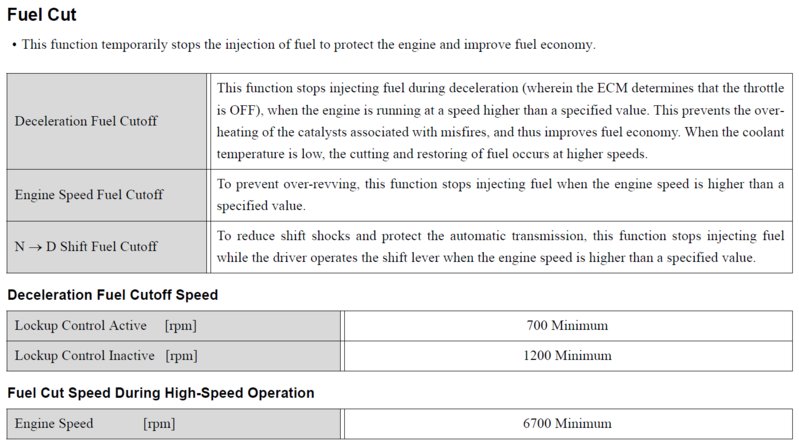

    TL;DR: SG fuel cutoff setting should probably be set at 15 for 2GR-FKS.
    Looks like the throttle goes down as low as 14%. With the SG fuel cutoff set at 15 you will still occasionally get 9999 mpg. If you set it to 14 you probably won't get 9999. Lowering this setting to 14 does seem to have reduced the SG mpg error from ~15% to ~10% in my 10 mile city trips. But, if this engine does cut the fuel; then, it probably needs to be set at 15 to account for it. For example, with the cutoff at 14, moderate engine braking causes the SG MPG to go way down which would indicate the SG is not factoring in any fuel cutoff. So, it looks like 14 would give a massive error while engine braking down a long steep grade. (This is all rather preliminary due to my limited testing and lack of gradients here.)
    EDIT: Now I think it should be set at 1. See post #119.

    tacoma doesn't cut fuel 100%, ever.
    if it did it would be able to carry PZEV status and sticker.

    After I set mine back to 15 I didn't get 9999 anymore as expected. Raised it some more and still didn't get 9999. Did some more driving today and the 9999 came back. This time I got 9999 with the fuel cutoff setting all the way down to _1_ just on level coast down. Hmm.
    This suggests to me that the engine does cut fuel; but, only if certain conditions are met. Perhaps the conditions are emissions related (e.g. the catalyst needs to be hot)?
    TL;DR: Now I think the most appropriate cuttoff setting may be 1 and/or that the SG is just not sophisticated enough to approximate fuel use of 2GR-FKS at no load.
