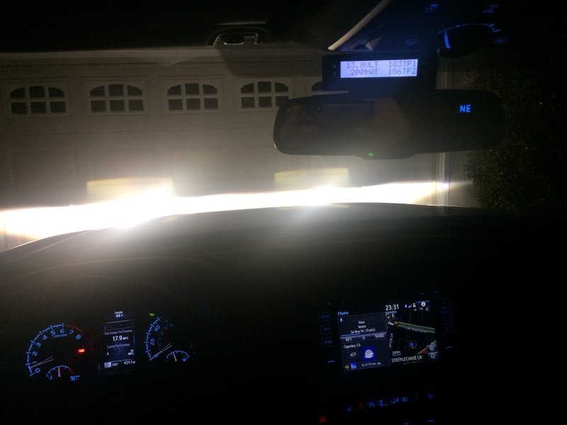

    Here is how mine is installed. Does anyone know what TF1 and TF2 actually mean? For example, TF1 is fluid temp before entering cooler and TF2 is after the cooler.
    Definitely not too bright and not an eyesore having matched the oem interior color. I used a bendmount to attach to the mirror
