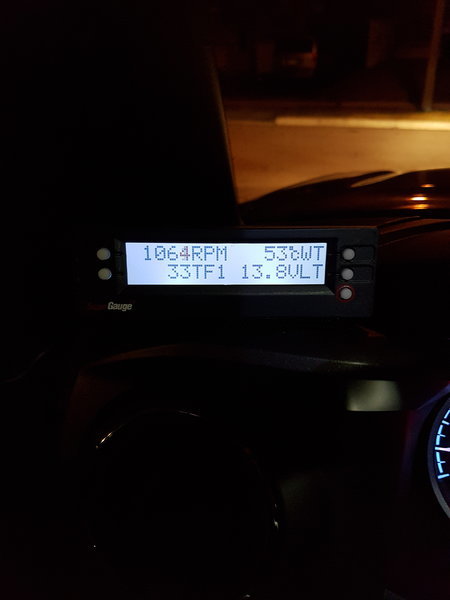

    Just tried the first one.
    Water temp is 48, outside is 2 degrees. Saying 32 for trans since truck wasn't running. Seems like it would be accurate to celsius. Thanks dude
    Tharris242[QUOTED] likes this.
  6. Jan 23, 2017 at 6:53 PM
    #146
    Joe23
    Joe23 Canuckistikian
    Oct 5, 2015
    #165909
    11,299
    The Great White North
    2017 TRD Off-road DCSB
    Doesn't specify if that is celsius but given the read out, temp outside etc seems about right of what it should be and all that was changed was the MTH code to 00010001FFD8
    Cheers to @Tharris242 for the code.
    Just curious what would be an alarming temp to see (F or C I can convert)

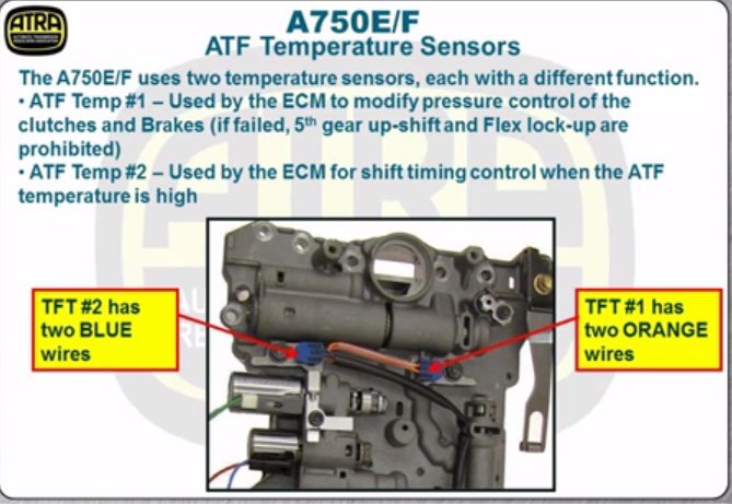

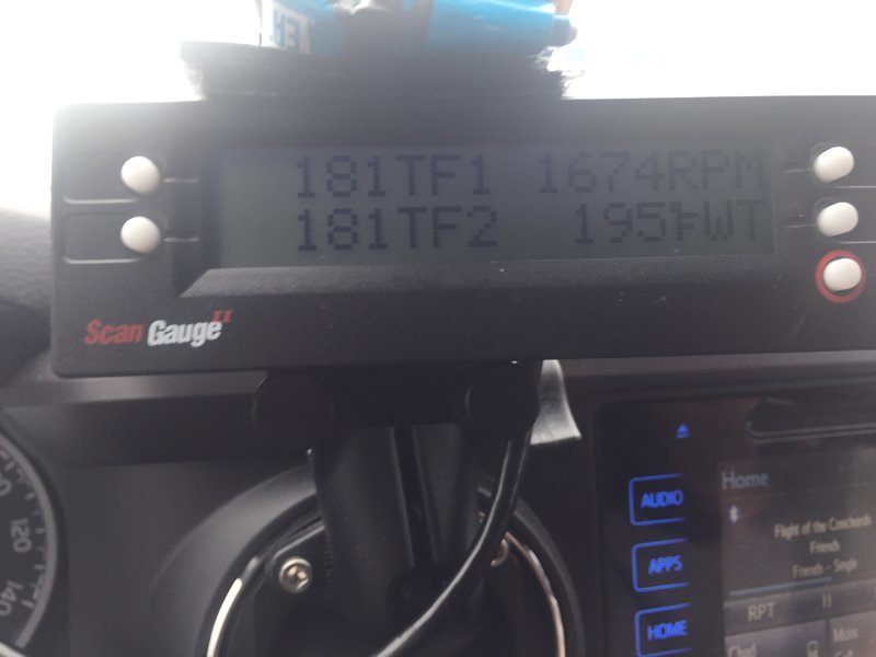

    Just wondering has anyone notice tf2 runs hotter and fluctuates a lot more? Found while moving it drops more than at idle.
  17. Jul 9, 2017 at 8:36 AM
    #157
    Exracer2
    Exracer2 Well-Known Member
    Dec 7, 2016
    #204304
    1,516
    Colchester Ontario
    2017 TRD Off-Road Alpine White ACLB
    BRO grille, KICKER speakers, Key amp, Hideaway sub
    It does fluctuate like you said. I assumed one was after cooler and the other after torque converter. That would explain the fluctuation.
