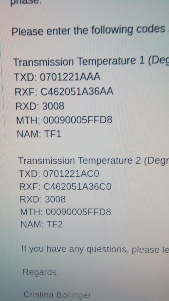

    Got this yesterday from ScanGauge folks and it appears to work:
    Engine Oil Temperature (Degrees Fahrenheit)
    TXD: 07002210F6
    RXF: C32400000000
    RXD: 2008
    MTH: 00090005FFD8
    NAM: EOT
    Notes: Requires firmware 4.22+
    Tharris242 and boynoyce like this.
  18. Jul 22, 2017 at 1:14 PM
    #178
    rewted
    rewted Well-Known Member
    Feb 27, 2016
    #179574
    137
    2017 Black TRD Off-Road Double Cab Short Bed
    Warn Zeon 10-S, BFG KO2 265/75/16, Bakflip MX4, Split Dual Battery System, TRD Pro Grille, Tokonsha P3 Brake Controller, ScanGauge II
    TF1 and TF2 temp codes are listed on their website. just google it.
  19. Jul 22, 2017 at 1:16 PM
    #179
    jsey21
    jsey21 Well-Known Member
    Nov 9, 2016
    #201943
    497
    2016 Black Tacoma Sport DCSB V6 4x2
    OVTuned https://www.tacomaworld.com/threads/rear-diff-vent-behind-the-tail-light-mod.286097/ https://www.tacomaworld.com/threads/rust-on-frame-with-a-c-drain-mod-fix.444138/ https://www.tacomaworld.com/threads/ultimate-led-turn-signals.486423/ https://www.tacomaworld.com/threads/premium-audio-upgrade-for-less-than-250.510424/
    Here are some others they gave me to try:
    Description TXD RXF RXD MTH Notes
    Transmission Fluid Temperature 1 (Degrees Fahrenheit) 0701221AAA C462051A36AA 3008 00090005FFD8 4.22+ Required
    Transmission Fluid Temperature 2 (Degrees Fahrenheit) 0701221AC0 C462051A36C0 3008 00090005FFD8 4.22+ Required
    Fuel Pressure Sensor (PSI) 0700221078 C46205103678 3010 00640161DBBE 4.22+ Required
    High Pressure Fuel Pump Duty Cycle (%) 0700221072 C46205103672 4008 000100020000 4.22+ Required
    Engine Oil Temperature (Degrees Fahrenheit) 07002210F6 C32400000000 2008 00090005FFD8 4.22+ Required
    High Fuel Pressure Sensor (1000's of PSI) 0700221078 C46245103678 3010 00010023FC5F 4.22+ Required

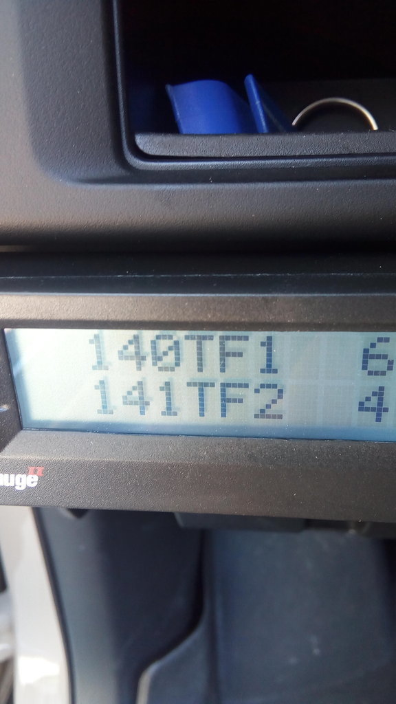

    boynoyce
    boynoyce .
    Feb 23, 2016
    #179183
    6,228
    16SR5AC4X4V6QS
    Purchased Scangauge II from Amazon July 1st, installed July 3rd- trans temps codes above and displayed results- working!
