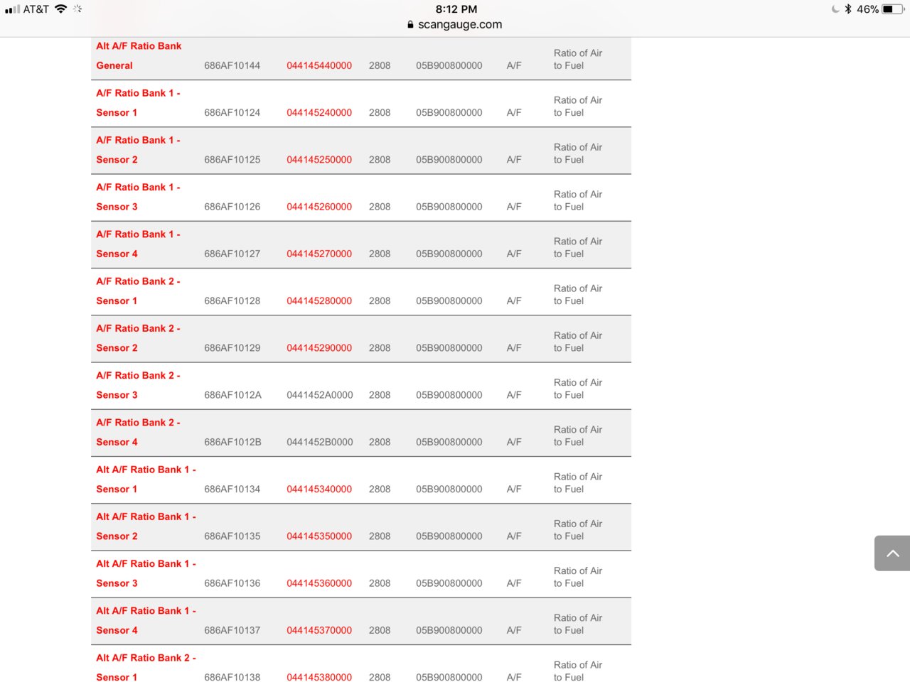

    I installed my scanguage a month ago and I see that one of the add on xguages is
    AF AIR FUEL RATIO.
    Has anyone added this to there guage? If so is it accurate?
    I see there are a number of codes to try so I’m lost as what to do, what code to add.
    What RXF code worked for you as there are 17 total?
    Can’t get any to work

    I don't think the 1st gens report the actual A/F ratio
    look at the edit in the first post here: He talks about getting the A/F on 99+ 4runners with california emissions.
    I know this isn't scangauge, but the codes are ultimately the same.

    I don't believe these will work since you are narrow band, not wide band O2.

    @drr did you happen to note the configuration for AFR? I have a wideband in my 2003.

    If you don’t figure out the xcodes long and short trims, I will see if I can get into my unit if they show them

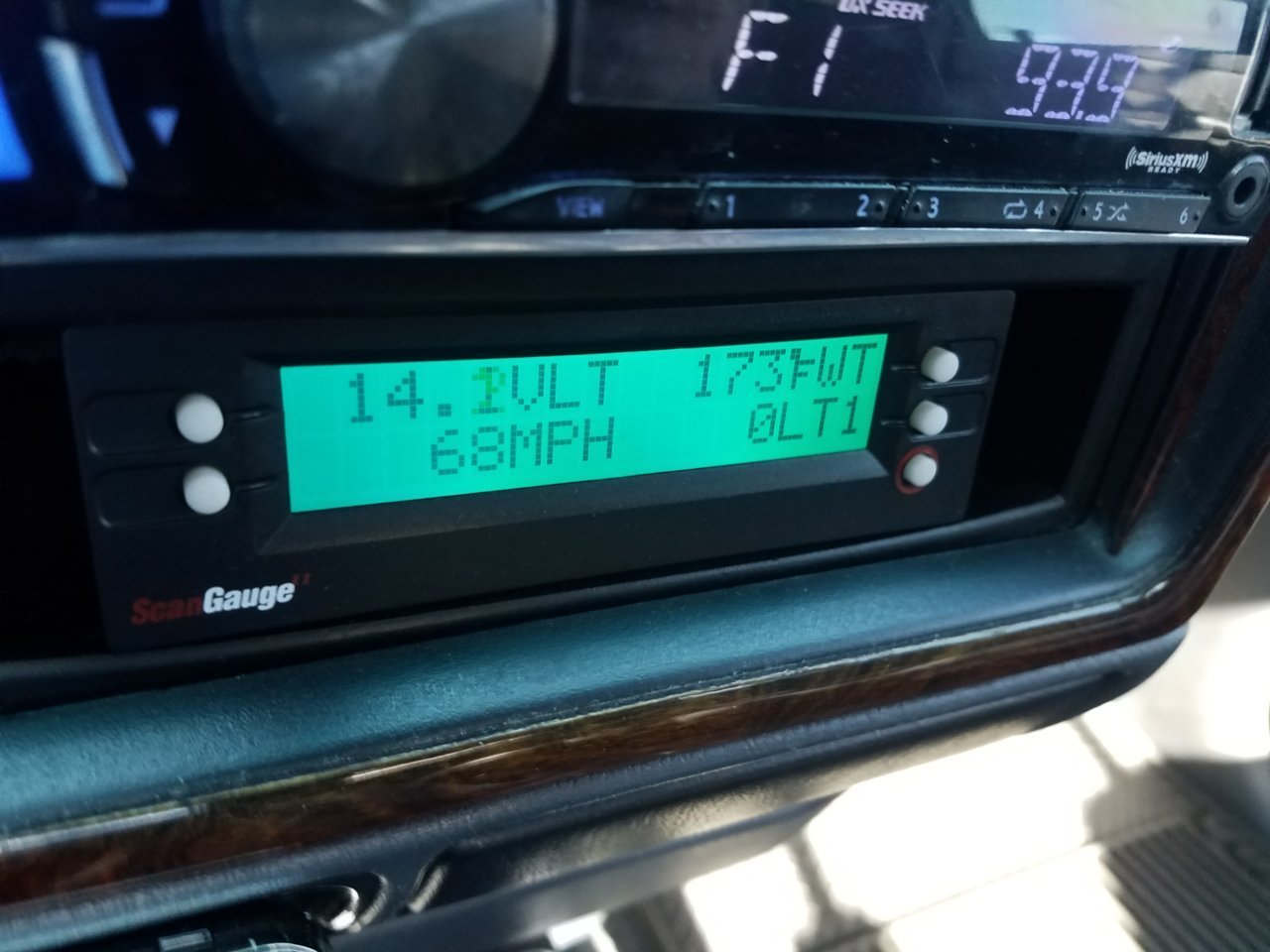

    I just played with my gauge. If you go to the edit, you can cycle through the config screens for the values and then press the cancel button to not accidentally change them. Something like More > More > (arrow until you see X-Gauge) and then arrow through until you see your LF1 storage slot.

    Yea and you will have to program the Correct numbers for your truck for the different slots
    Long Term Fuel Trim
    TXD: xxxxxxxxxx
    RXF: xxxxxxxxxx
    RXD: xxxx
    MTH: xxxxxxxxx
    If I remember you need to program both long and short with there own slots,
    Unless these has been changed since I bought mine

    I’m pretty sure these are your input numbers for the short trim.
    Install them and let me know
    • Gauge
    • TXD
    • RXF
    • RXD
    • MTH
    • Name
    • Short Term Fuel Trim Bank 1
    • 686AF10106
    • 044105060000
    • 2808
    • 00C80100FF9C
    • SF1
  20. Oct 9, 2019 at 5:35 PM
    #20
    1997tacomav6
    1997tacomav6 [OP] V6 5sp,RegCab,TVS1320 Supercharger,Haltech, 800k
    Oct 5, 2013
    #113940
    10,386
    John
    Denver
    97 reg cab, v6 5sp 300hp supercharged, Methonal Injection, 800,001 plus miles, Original Owner
    V6 5sp,RegCab,TVS1320 Supercharger, 56mm pulley, methanol injected Haltech ECU, AC Tvs1320 supercharger,(MUST DO) every 125,000- 150,000 needs rebuild Projector headlights HID 5 speed manual Amsoil for all drive train Smaller 56mm custom pulley, (MUST DO) 2004 DESNO fuel injectors, zero ping ping, 2004 side door mirrors Dick Cepek Rims, Michelin tires LTX, ATM Pathfinders Dynopro ATM ( that last 100,000 miles) Now running Dynopro ATM mud and snow tires KN cold air intake Cat back dual exhaust with ss exhaust tip, Raised exhaust tail pipe to 2" below body line Optima*dry cell battery,red top Alpine sirius radio, 200 watt amp, focal is165 split door pod speakers Focal door speakers Subwoffer behind seat Viper alarm, Electric Locks Dark tinted windows, bucket seats corbeau lg1 Tacoma Rubber floor mats TRD fender extenders, Bilstien shocks, King shocks JBA UCA trailer iv hitch, electric brake control, Drilled slotted brakes, High carbon steel (MUST DO) EBS green stuff 7000 series pads(MUST DO) TRD engine oil cap TRD stick shift, Marlin crawl shift kit. Rear sliding window 2002 4Runner functional hood scoop cut into Tacoma hood, 4Runner dual overhead map light Gentex Auto dim + Compass + Temp, garage,rearview mirror Snow Methonal kit stage 2 Custom 3 core aluminum radiator Linex bed liner Haltech stand alone ECU, Intake supercharger gauge. Stainless steel brake lines, Custom leather wrapped steering wheel, Haltech stand-alone ECU,
    And this I’m thinking is the correct input numbers for the long term trim.
    Let me know.
    “0” is your idea long term fuel trim number to shoot for
    Long Term Fuel Trim Bank 1
    TXD: 686AF10107
    RXF: 044105070000
    RXD: 2808
    MTH: 00C80100FF9C
