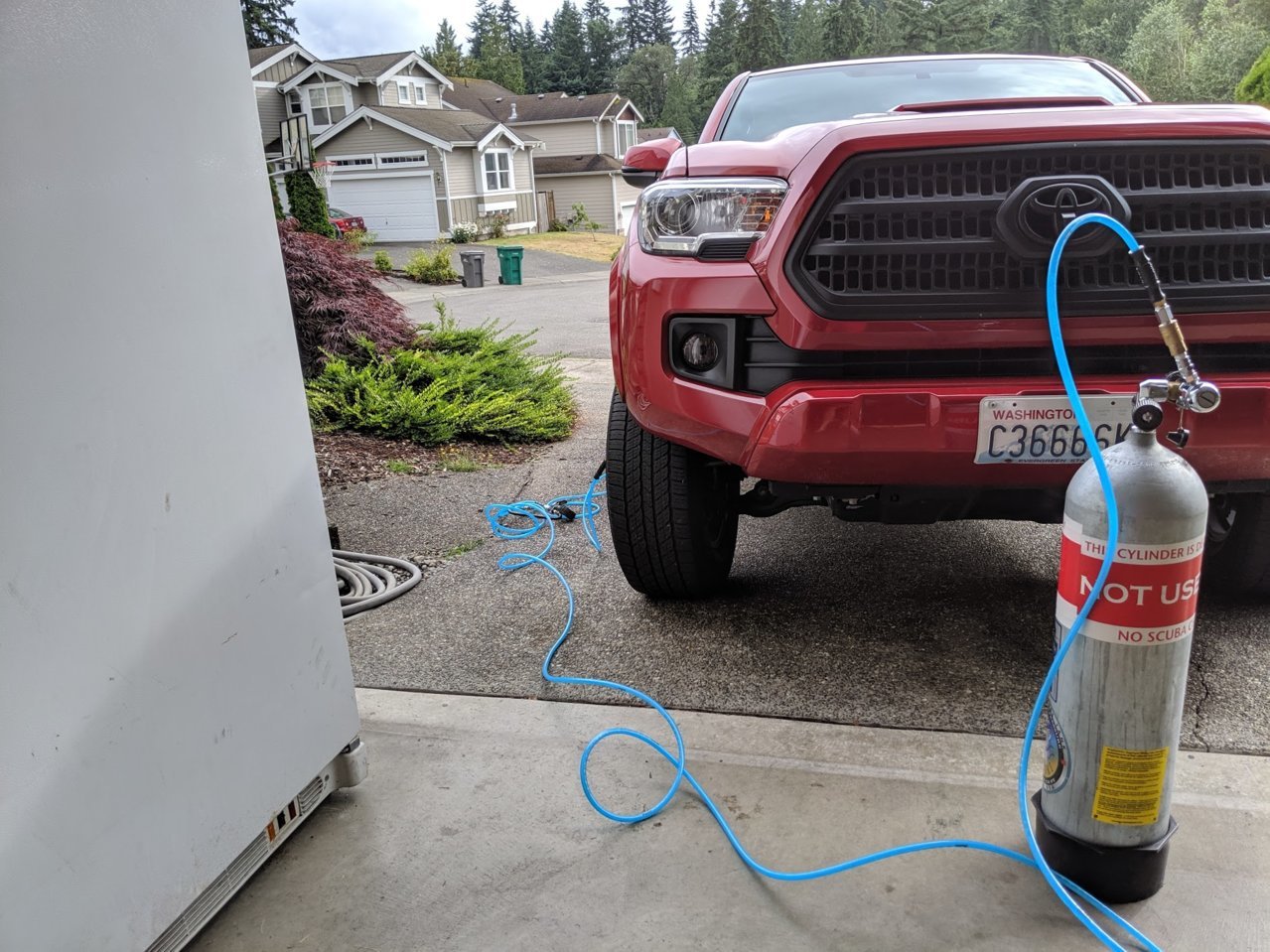

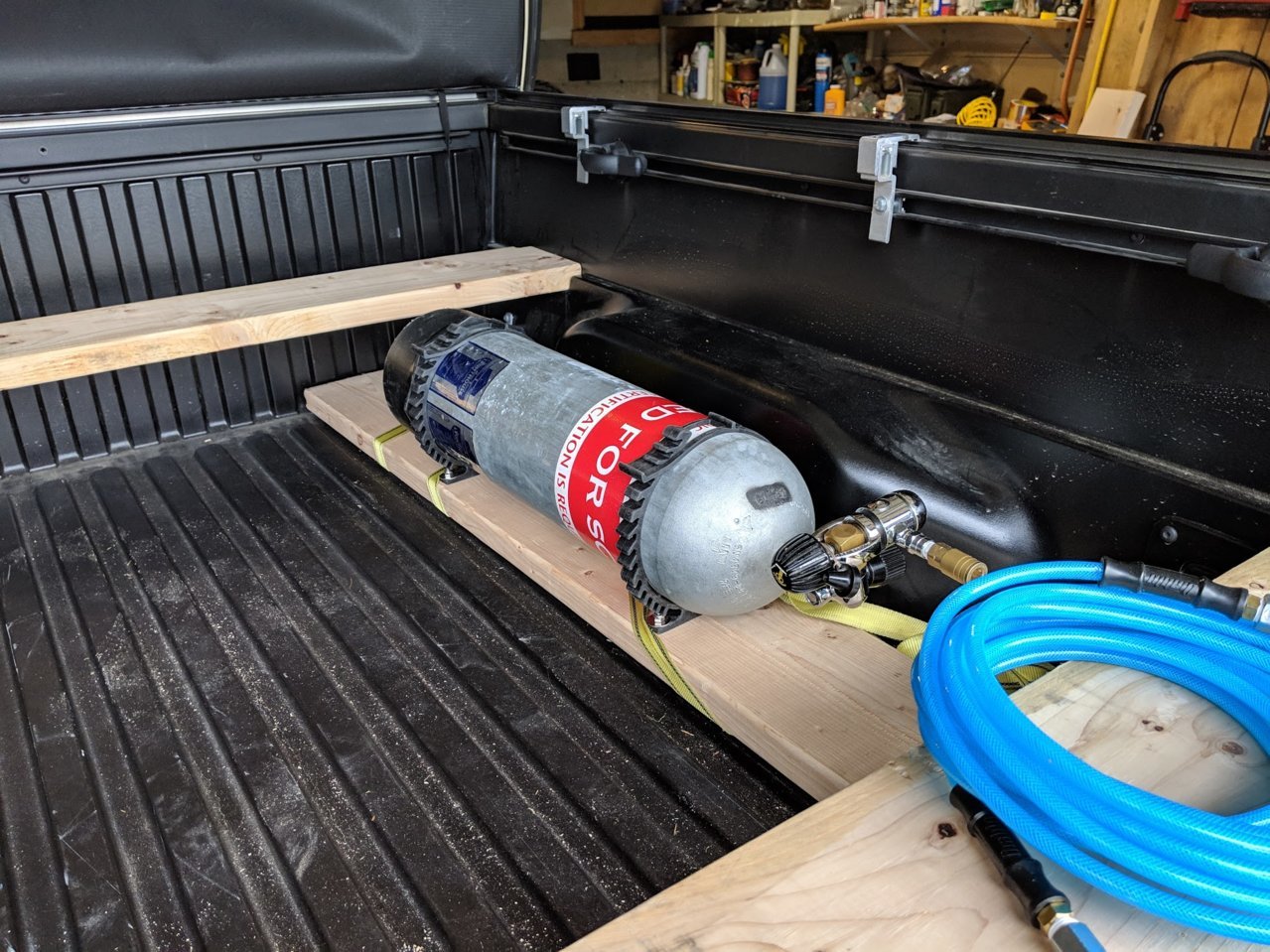

    I have a 120CF 3,500lb tank that I have used to go from 20psi to 35psi on two stock Tacos and a JKU on wide 35s. Plenty of air leftover. I would guess that your 60lb tank will fill yours at least a few times.
    Weigh your tank empty and full. With one of these, you can roughly gauge the amount remaining:
    https://www.amazon.com/gp/product/B00A8SXGKA
    I made a mount for the bed:
    https://www.tacomaworld.com/threads/strapping-tie-down-question-complete.577901/
    If you're going this route, you will need a 1st Stage reg to drop the pressure. I use mine for shop air.

    Completely. 40.2lb empty and 49.0lb full. It should seem obvious, but I'm not weighing the tank on the trail. I weigh it before I head out to decide if I need to visit the dive shop or not.
    What would you do to judge the fill?

    Not if you're not a diver. The OP said nothing about being a certified diver, just that he has a tank, a standard compressor, and a shoebox compressor on the way, and most people that I know with tanks are not divers either.
    My pics clearly show that my tank is not for diving at this time, and I clearly state that mine is used for shop air.
