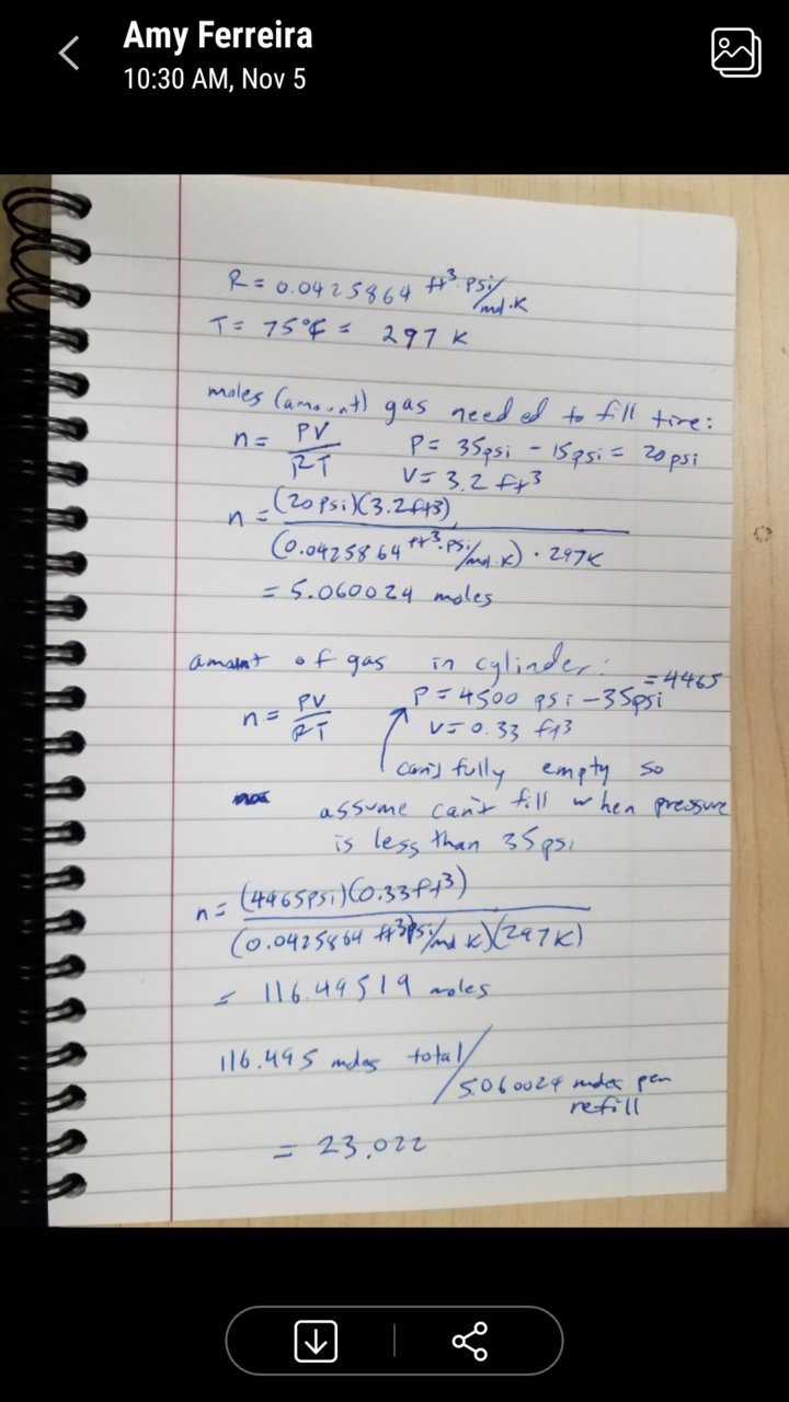

    Hey everyone,
    Thanks for the contributions. I still cant do the math, but my sister did this. Pick it apart, and let me know what you think.

    The math looks reasonable, although I'm a bit lazy to verify the tire volume. 23 fills does seem like a lot for my 120cf 3,500psi tank. Relating that to 60cf 4,500psi has me wondering. In the end that is ideal gas law, so there will be losses. If you either assume half to 3/4 of that and / or check the amount remaining by weight or a gauge, you will develop some feel for what it is in real life.

    Yeah, it was just a theoretical exercise. Once I get it, I'll run a couple tests. It was mostly for fun trying to figure it out on paper.

    Yeah. Running the numbers can be interesting. It gets the head going.
    I think you will be happy with the tank. A lot easier than a compressor and good for a lot of other stuff.

    A pressure gauge is $25 on Amazon. Zero equations.

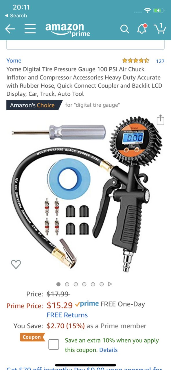

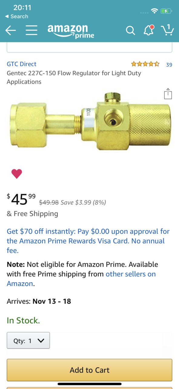

    DDDCDA83-290C-4E90-B042-A849CBCFA838.jpg 05C3BB6E-6A89-4CD0-A16F-4DF01B9F118D.jpg
    Then I bought the quick connect fittings and heavy duty 25’ hose at harbor freight tools
