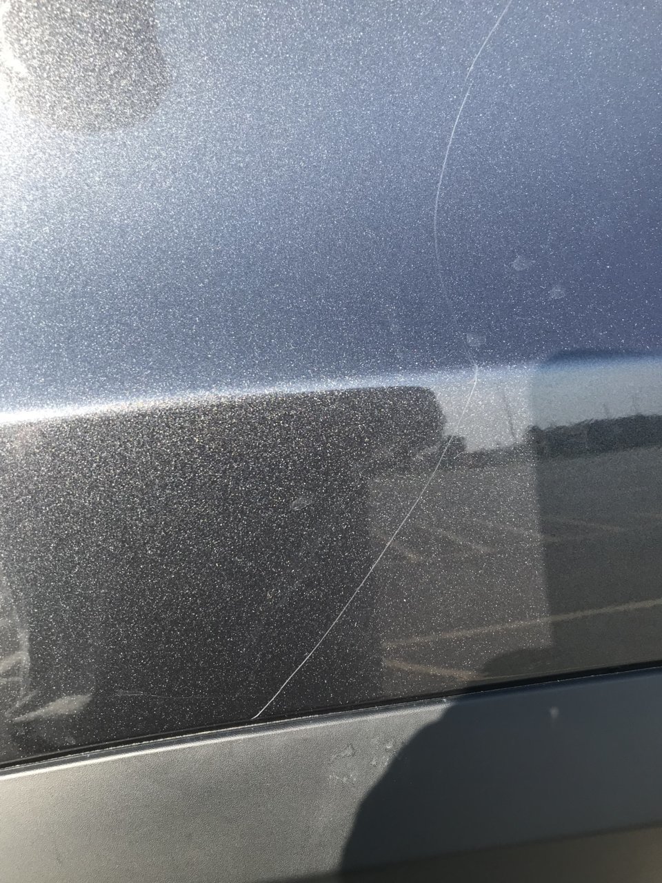

    Any scratch removal tips? Saw a few items but no idea if they work .

    If you can feel it with a fingernail, aim for improvement and NOT total removal. Or you'll risk going through the clear coat.
    A buffer is your best bet for improving the appearance. Least aggressive method (fine polish) first.

    That type of correction will require a machine.
    I highly recommend a DA (dual action) polisher not a rotary buffer. Rotary buffers require a skilled hand or you will buff through your paint job very quickly.
    If you can catch the scratch with your fingernail you will not be able to completely remove them.
    A DA polisher and some light polish will help clean them up to make them less noticable.

    Can’t feel them it at all, I live on a dirt road so next to impossible to keep clean, the dust has already blended them lol but I will look into a polisher

    Water sand it with 3400 grit, then polish it with a high speed buffer or by hand. If your don't level it down your doing nothing but polishing the scratch.

    My experience tells me by looking at the scratch posted in the pic earlier is to wet sand it down. You can use a mill gauge and then you will know how much paint there to work with. I still disargee. But I think experience in dealing with it on a daily basis a true professional would do it and still have the same results.

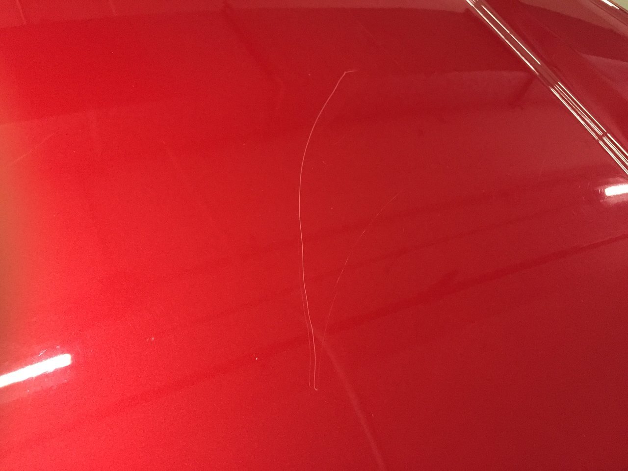

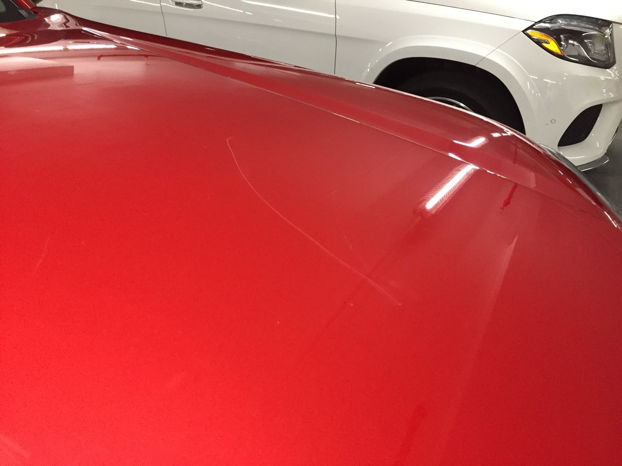

    Went to get my truck "professionally" cleaned. Left with a giant scratch. Ended up re-painting the hood
