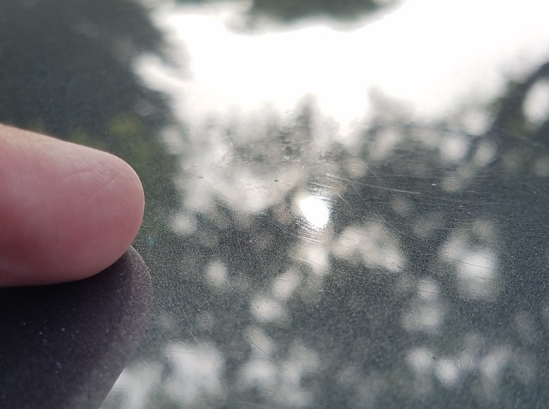

    I should have clarified my post. OP should always start with a polish/compound and go from there. I tried both with a DA, and MY results didn't change. Hence why I said "for what it's worth."
    But, since were on the same topic, this is the damage I have.
    I can BARELY catch a couple of them with my thumb nail, but the rest are completely smooth to the touch. Again, caused by a fingernail. Was I doing something wrong? What type of pad should OP and I be using? Should we clay bar the surrounding areas before trying Scratch X (again for me)?

    What type/brand pad did you already try? And what polish/compound?
    Megs Ultimate Compound on a Lake Country Orange pad might be a good place to start. Slow arm speed, moderate pressure, speed 5 on the DA?

    Given the what I see in the pics that should come out with a DA. What was the setup you were using?

    I've gone the "college student budget" route so far. Harbor Freight Variable DA polisher with the orange cutting pad. I first tried Ultimate compound, then after seeing that didn't work, I cleaned the area and tried the same setup with Scratch X. ~4000rpm, light to moderate pressure both times.
    A neighbor of mine used to do car paint jobs (among the other many things he's done over his lifetime) and now does wood restoration projects, so he has a fair amount of experience in the art of "finishes." He suggested that I start with 1000 grit and LIGHTLY wetsand, then move to 2000. This was supposed to be my project last weekend, but after reading everyone's responses, I'm glad I waited.

    I would not wet sand that, not without experience. Like Ace said should be something you can get out with a DA Polisher. You probably aren't using an aggressive enough compound. I personally do not care for Mequire's anything. Some of the detailers here use the higher quality stuff and stand behind it, their cheaper stuff I think sucks.
    I would go with a more professional quality compound and buff slow. Don't do fast passes, take your time. I would say you might want to look into a two-stage polish. That scratching is decent. Might take a compound with a little more umpf to buff it out.
