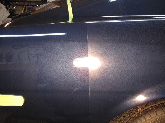

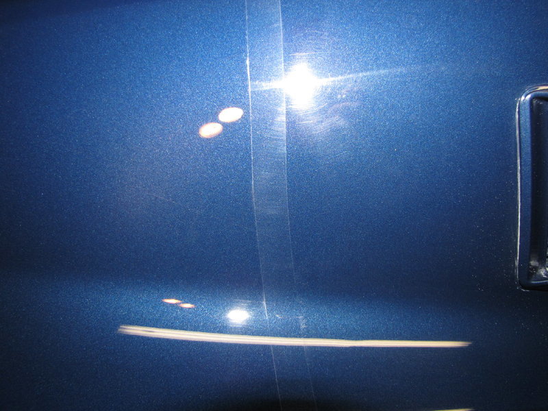

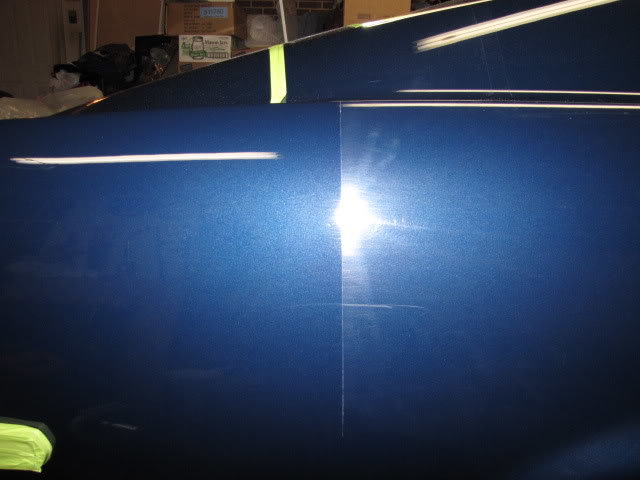

    -Maguire's m205 w/ Lake Country White polishing/finishing pad for light swirls (2 passes)
    -Maguire's m105 w/ Lake Country Orange cutting pad (2 passes) followed by Maguire's 205 w/ Lake Country White polishing/finishing pad (2 passes) for heavy swirls. I'd consider yours on the heavier side.
    50/50's of this process
    Leave the wetsanding alone. Always attack with the least abrasive method then move up if you don't achieve your desired results.
    Benzdriver81 likes this.

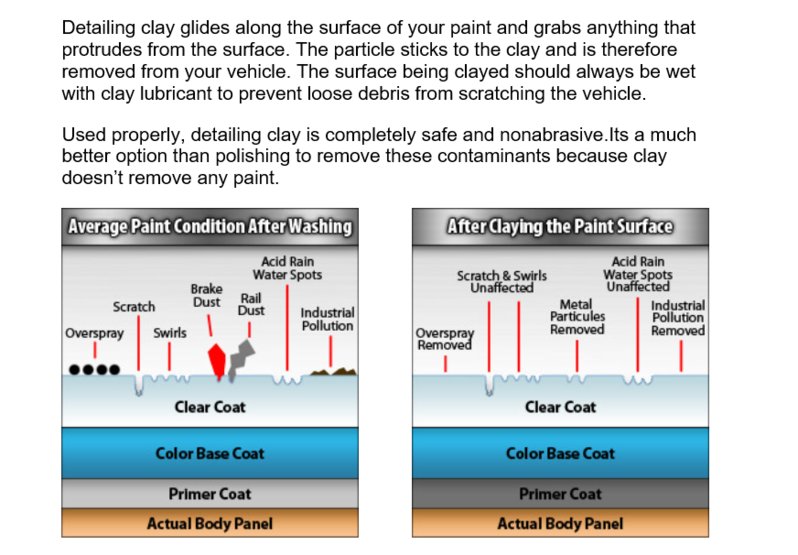

    Also here is good information to show what claybar does.
