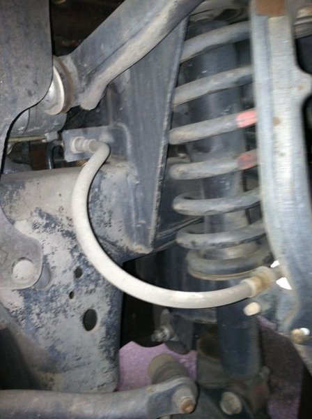

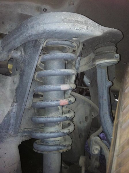

    How do your front coils look? When I put wheel spacers on the frame rub stopped but I rubbed on the inner part of the fenderwell and fender flares. My coils were shot so I needed a new suspension so decided to get a suspensions lift instead of a stock height setup. :D The new lift eliminated rubbing with 265/75/16s

    Ok I guess, i've attached pictures.
