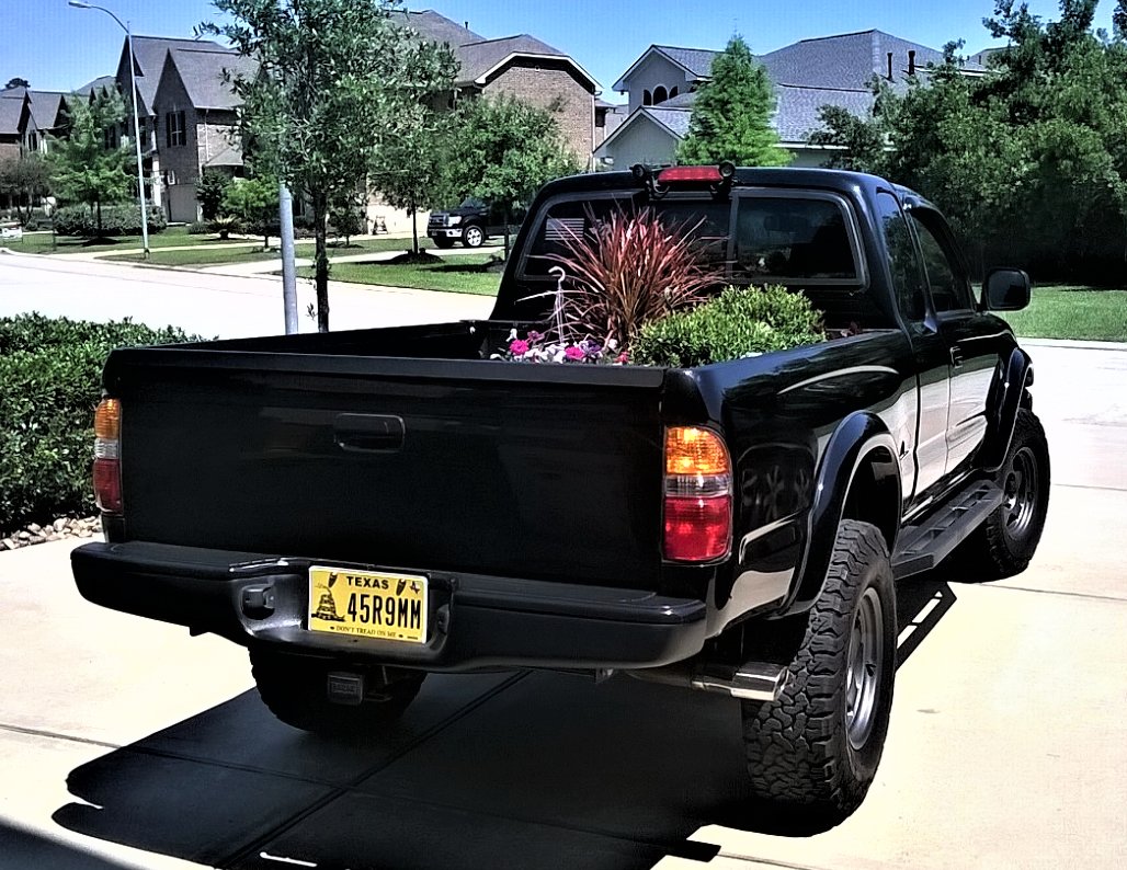

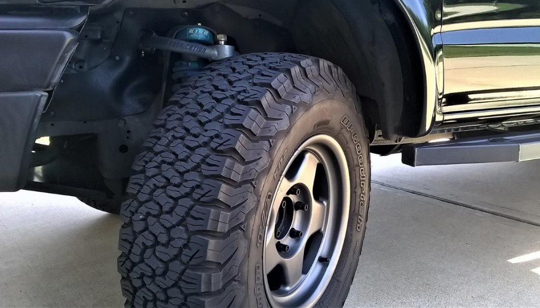

    Here I am on 16X8 and 4.5BS, 275 size, 3" lift. No rubbing. I have a pic from behind too so you can see the stance, about .5" past the fender. The issue you will have is at 3.5BS you will need to start cutting as your tire's "real estate" starts plowing into the fender and pinch welds. Take a run through that thread I pasted here on 285 fitment.

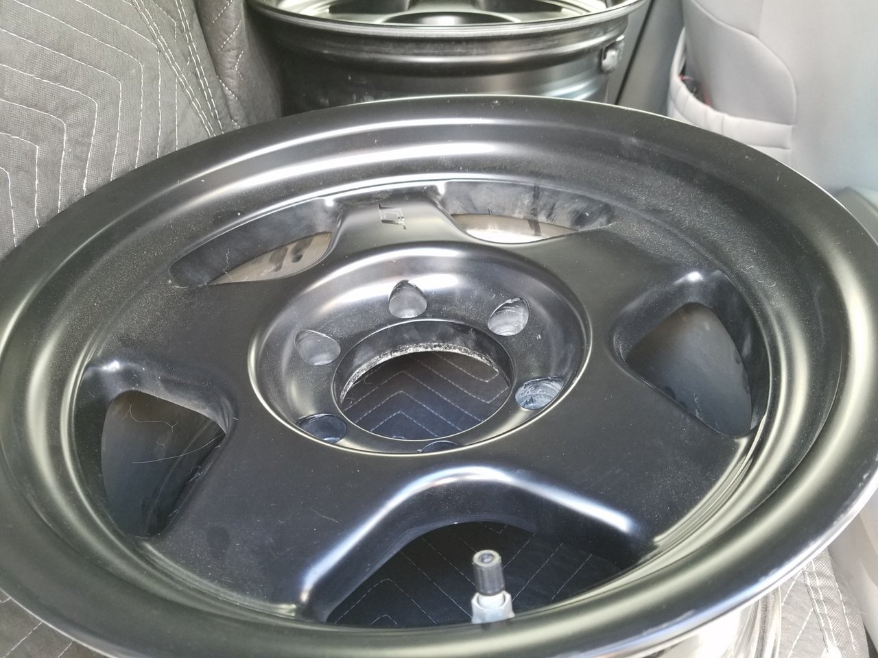

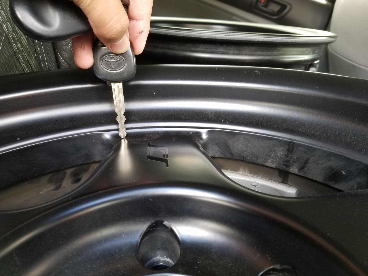

    I just bought 16x8 F5s, and I’m not sure what the backspace is. How does one tell, other than measuring?
    EDC5F406-2C0F-4527-A4B0-56F0EF7C0D3F.jpg 88C871E5-3958-4A7D-B4D3-A32C7689C308.jpg
    Also, I have 255/85/16 on there, and they are rubbing the cab mount badly, even though I have around 1.5-2” lift. Is that common?

    Are the spokes right on the inner lip or set back about an inch?

    Looks like 4.5 in that picture? You can compare with others here

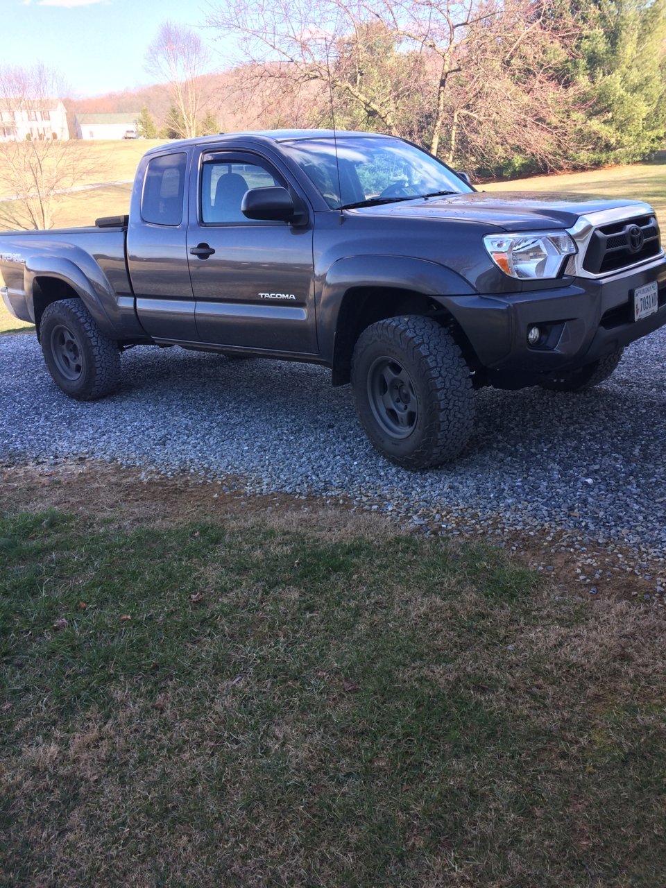

    These are 16x8 with 4.5 backspace if it helps. maybe compare the dish on outside. the 3.5 bs should have more i think.im running 1 1/2 - 2 lift with 265/75R16 and no rub.

    So 3.5 like I originally told you! @ChadsPride ’s photos were throwing off my perception.

    You’re right, looks deeper than dewayne’s.
    Chad’s are 17x9, so they have an extra inch to go deeper.

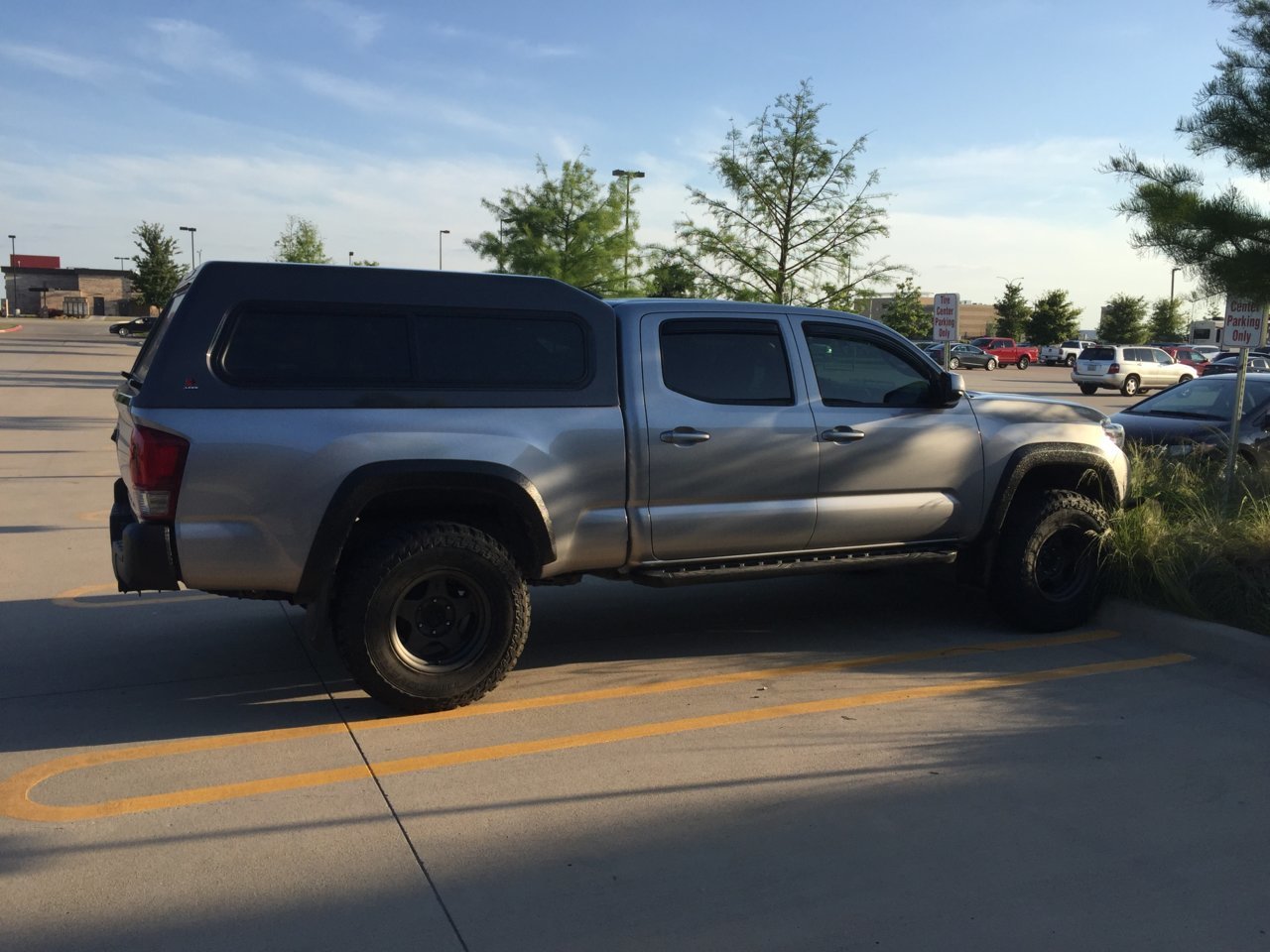

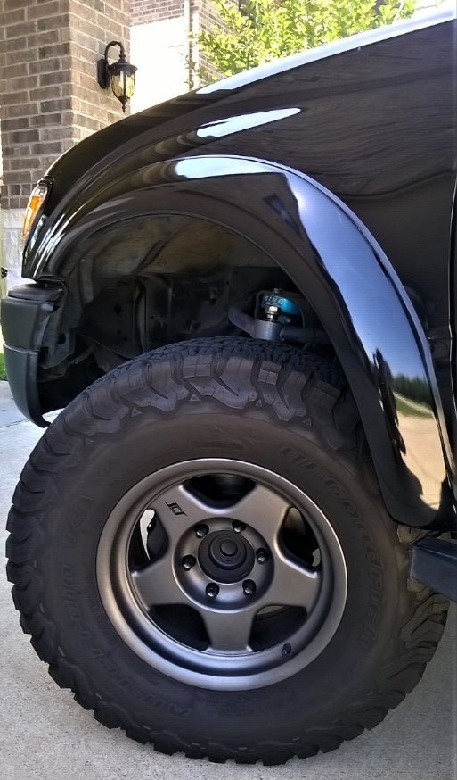

    I took one pic before pulling them off for now because of rubbing.

    Looks GOOD! Tires are meaty af

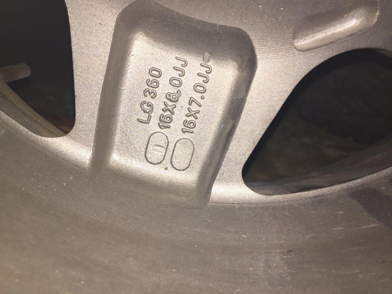

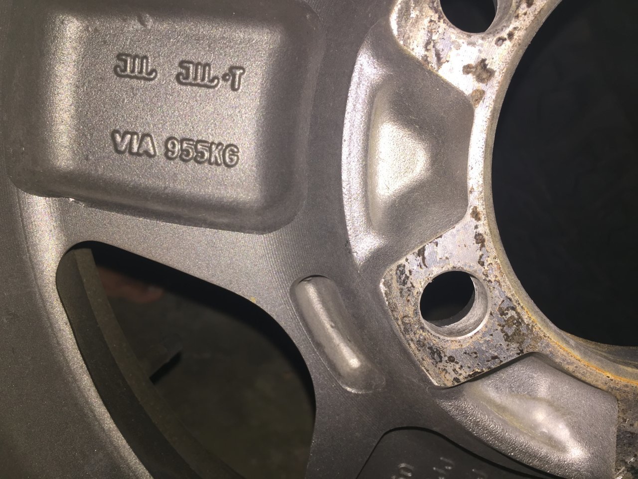

    So going by what you described above - the set I just scooped up (used) would be a back spacing of 4.5?

    Yours is 3.5" bs.
    Yours is 4.5" bs.
