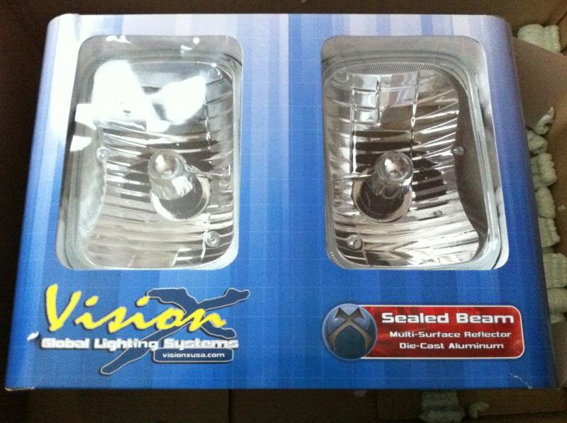

    So I'm buying parts to convert to a 95-97 front end.
    Bought new headlight assemblies as part of it. I truly don't know what "sealed beam" headlights are but always hear people bitching about the 95-97 OEM ones because you have to remove the whole headlight assembly in order to change the bulbs.
    So when I was vetting parts, I wanted to steer clear of that ordeal. I wanted to buy assemblies that I could just change the bulbs out from the back of the assembly (still attached to the core support).
    Originally was looking at the popular roundeyes replacements. Those are on back order for another 5 months.
    Then I was looking at these (the 5x7 ones): http://www.autoanything.com/lights/74A5157A0A0.aspx
    These say "conversion kits that replace sealed beams...Your Rampage Halogen Headlight Conversion Kit works with most factory wiring harnesses and hardware running stock 50/60W sealed beam lights"
    But when I was on the phone with the autoanything rep, he convinced me to buy these: http://www.autoanything.com/lights/77A5582A3720338.aspx
    These just say "sealed beams... Plug-&-Play design means no modifications needed (includes H4/9007 bulb plug adaptors when required)"

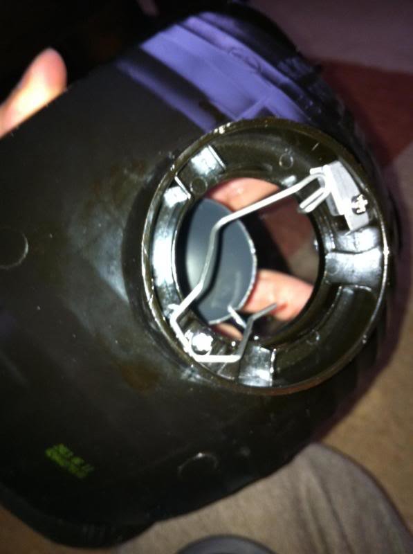

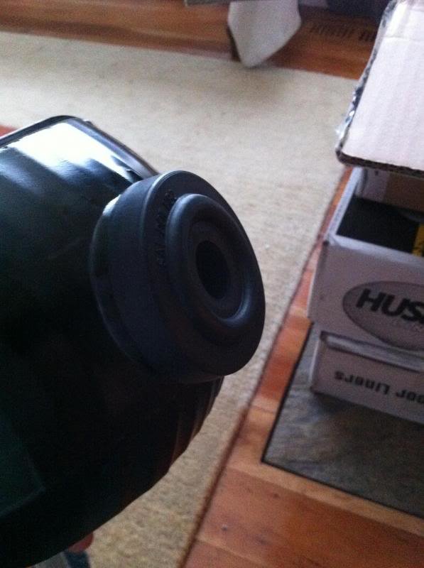

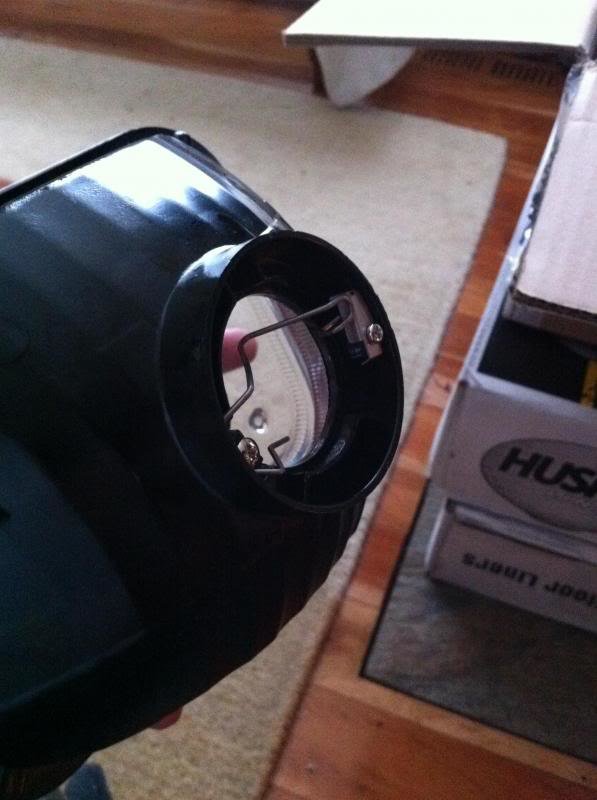

    Below are pics of the headlight assemblies. What the hell did I buy? Can I simply replace the bulbs from the back of these assemblies without taking the whole thing off the truck? Will my 1998 factory wiring harness, etc just plug and play? They came with a rubber seal on the back of the assembly (see pic 4)

    you bought just a lamp housing.
    Says it comes with adaptors for H4 or 9007 bulbs. Since yours are H4..should just go right in. Go out side and test em :p
    Yes it looks like you will be able to just leave the housings in and just swap in new bulbs when the time comes.
    a real sealed beam would not have that hole there. Just a plug with the bulb sealed inside.

    In general, a "sealed beam" headlamp is one where the entire headlamp assembly is a single piece, replaceable unit. The 97 4X4, and 96 and older Toyota trucks all use this type of headlight. When the bulb fails, you replace the entire thing, lens and all.
    The conversion kits (which I have in my 97) use H4 type bulbs. In this case, when the bulb eventually fails, I just replace the bulb (Just like you normally do now in your truck)
    The pictures that you posted in your OP shows basically what I have right now. And if the bulb does burn out, you do NOT have to remove the light to change out the bulb.
