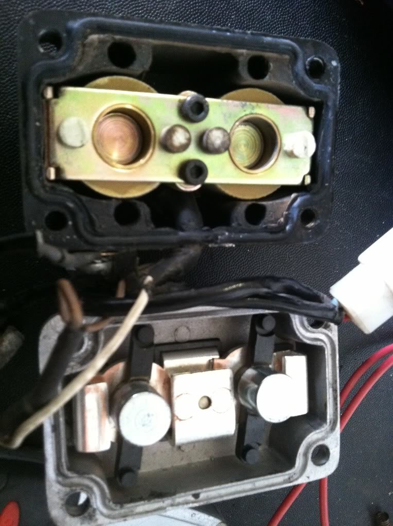

    So with a few years and lots of wheeling on this thing it started giving me troubles.
    Pulled the solenoid apart, a little bit of arcing but no corrosion! Worked perfectly if I jumped the pins on the connector so I figured it was either the other side of the connector or somewhere in the controller.
    Turned out to be a really shitty crimp job on the other side of the connector.

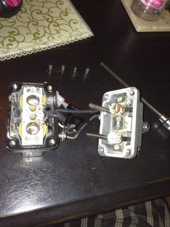

    Does anyone happen to have a picture of how the wiring goes on the solenoid?
    I didnt take a picture before pulling it all apart and got sidetracked before I could put it back together.
