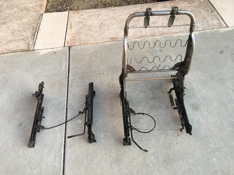

    "fabbing" means fabricating. I'm doing a seat swap with 2001 Lexus ES300 seats welded onto the stock Tacoma rails. Since I have an ext. cab, I wanted to keep the sliding mechanism intact so I grinded down the Tacoma rails until I could weld angle iron on. From there it's as simple as welding the Lexus chairs to the angle iron and wiring it all up. The motorized controls and heated pads are a nice touch. Check out my thread for some info.
    As for your question no there aren't any direct bolt on seats (off an existing vehicle at least). Even 3rd gen 4Runners which are identical with our 1st gens have one offset foot which will require modifying.
    Your only choice are racing seats. Corbeau makes brackets that mount directly to the Tacoma floorpan. Only issue is racing seats are expensive. A setup will run you $1,000+
    Lexus ES300 Seats
    Tacoma 60/40 Bucket seat rails
