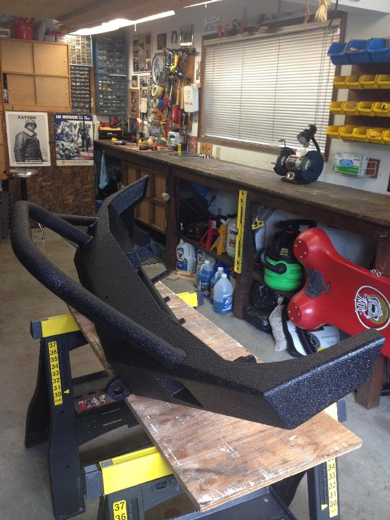

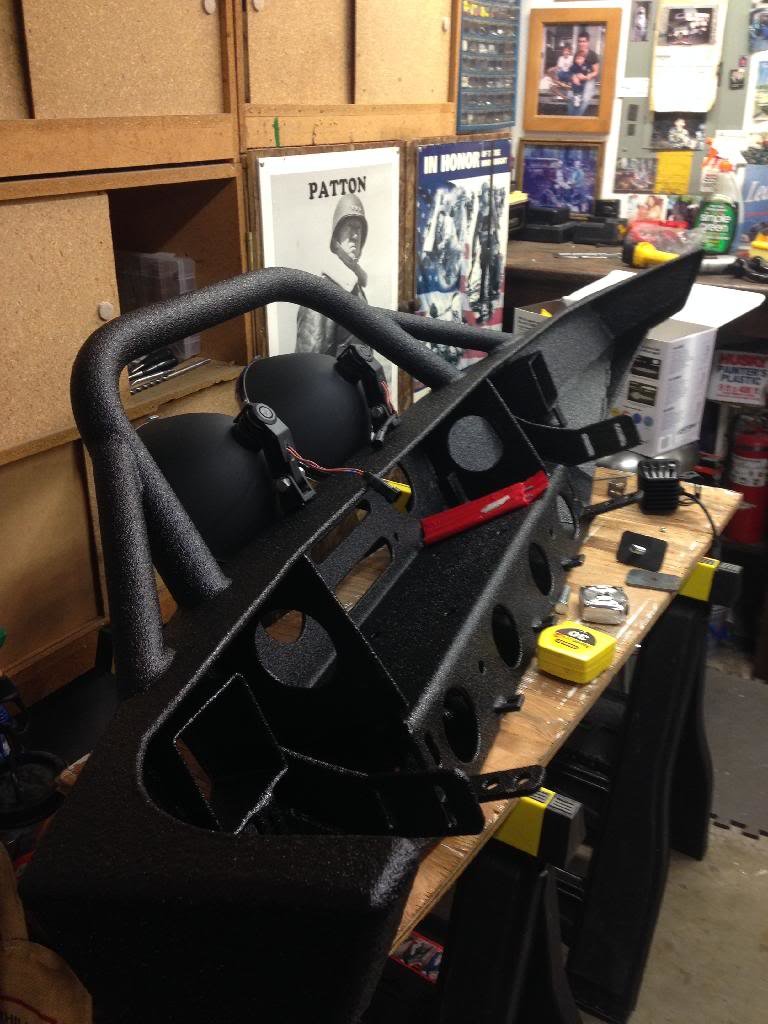

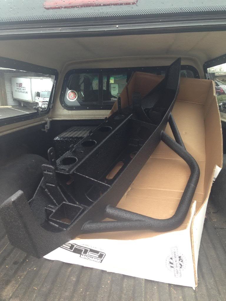

    Fresh out of Line-x
    F53F4C81-8C9E-4CD0-98AF-BF3522618D9B_zps_2094a328a11537e69c54eb5386d5c60ce0eb1290.jpg

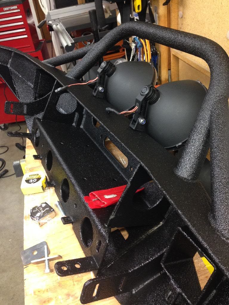

    Ready to start fitting
    75C38C15-EB4C-49D5-81E6-4C0455CC2BC1_zps_aa1cc26f7c5ca211f7367ec058f664925da72211.jpg

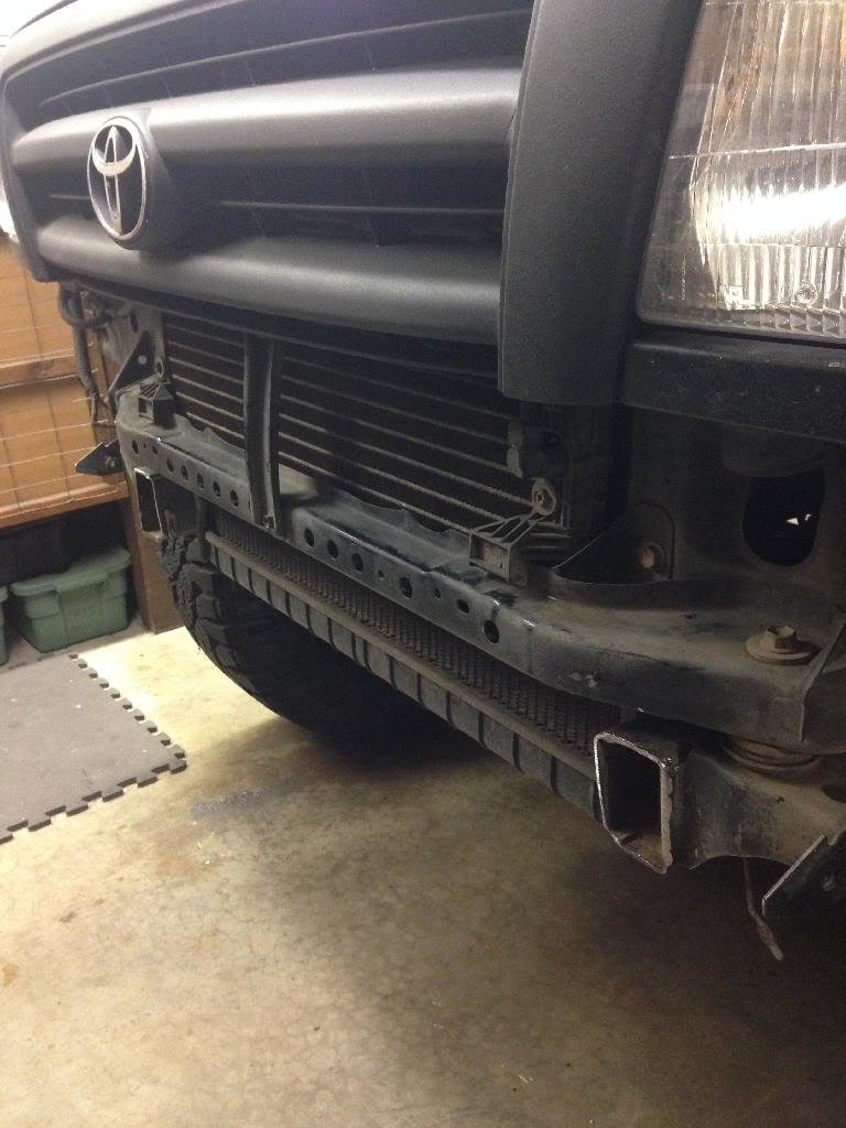

    Bumper fitting is taking longer than expected. I had to grind away 1/4" off the holes where the frame plate mounts into. Probably test fitted the bumper 10-15 times, oh what fun.
    Pics will come tomorrow

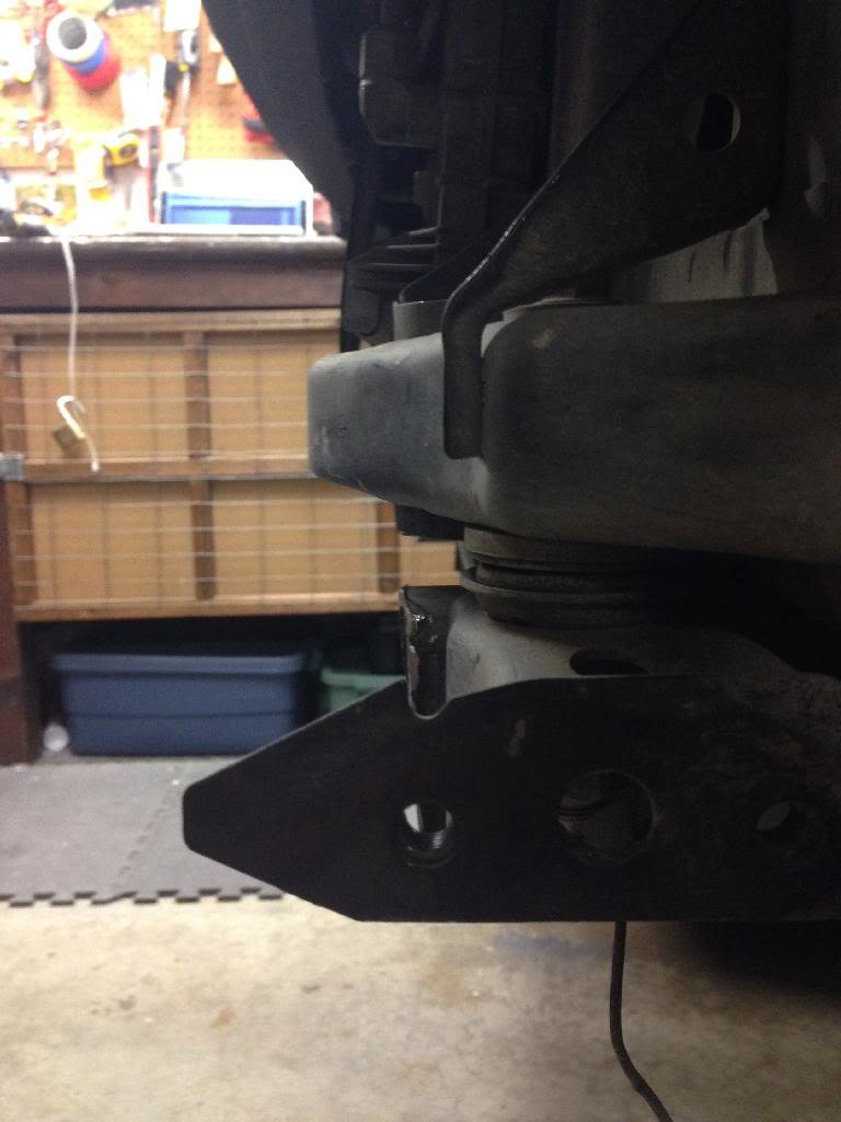

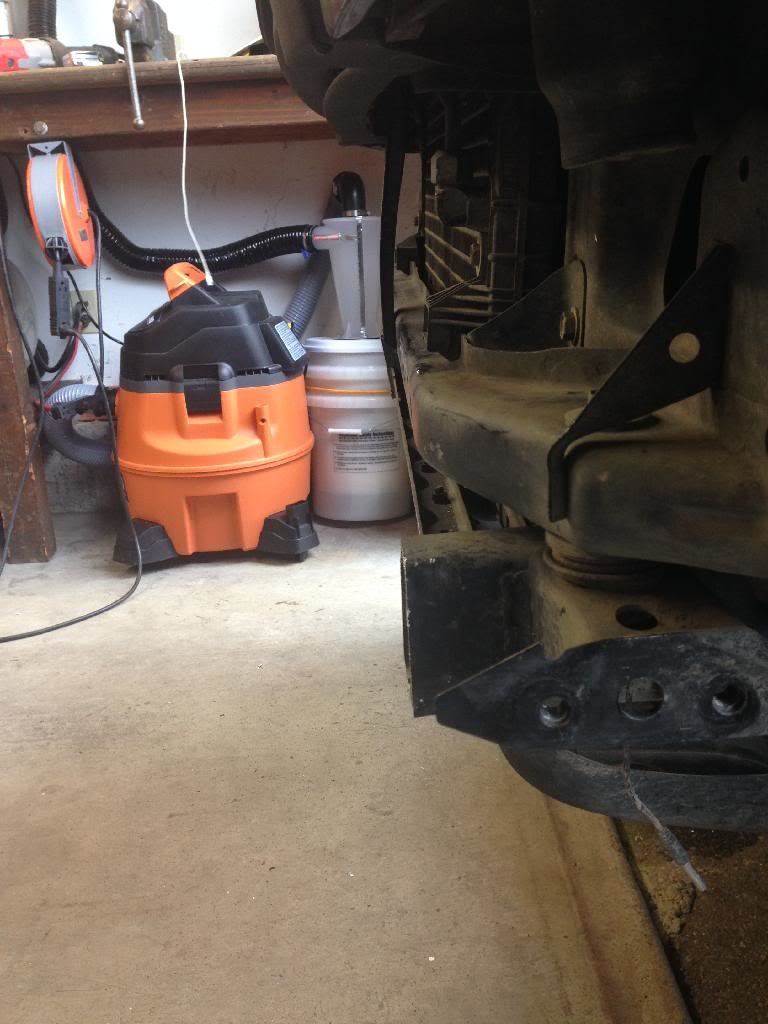

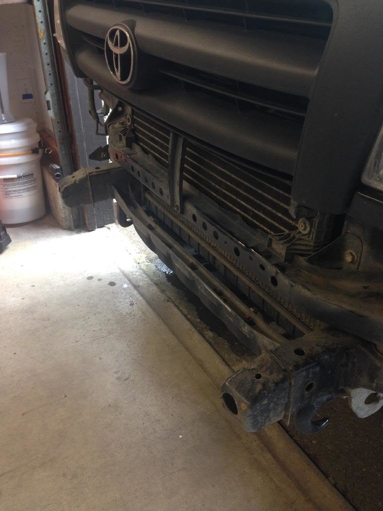

    I took off the bumper and here were the frame horns
    751625FB-4B79-4114-BE0C-9F3934DDE5CB_zps_89886eaae2d36249392754530029a5bace8b7203.jpg

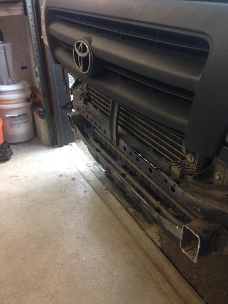

    So I cut off the horns and had to grind the frame ends smooth and even
    FDFCBB71-3704-4F42-8906-216C126DCA40_zps_0a89597f657fb25b56eff0166a33691c52e98218.jpg
    C0E94038-14CE-4433-9F20-CDF3FECB3AE2_zps_8c0c629919b19a1cca9f68a85cfb3411c9038b7d.jpg
    8969607F-359B-4E05-9EC7-E41157E5375C_zps_f15339ee444c235320bd597186f5e8ebabe8f1d7.jpg
    D5806F72-2680-4FBA-B149-746985A7791C_zps_620d90db110da3c8ca7fcacd458f59ac1675a368.jpg
    C7C80B6E-8115-4AC0-A891-67E30F30D704_zps_16fb88370d181e5525d58cc5bdceda9547dd7e6b.jpg

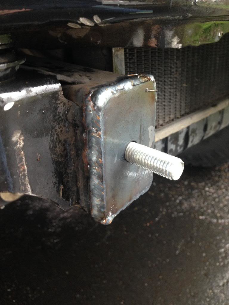

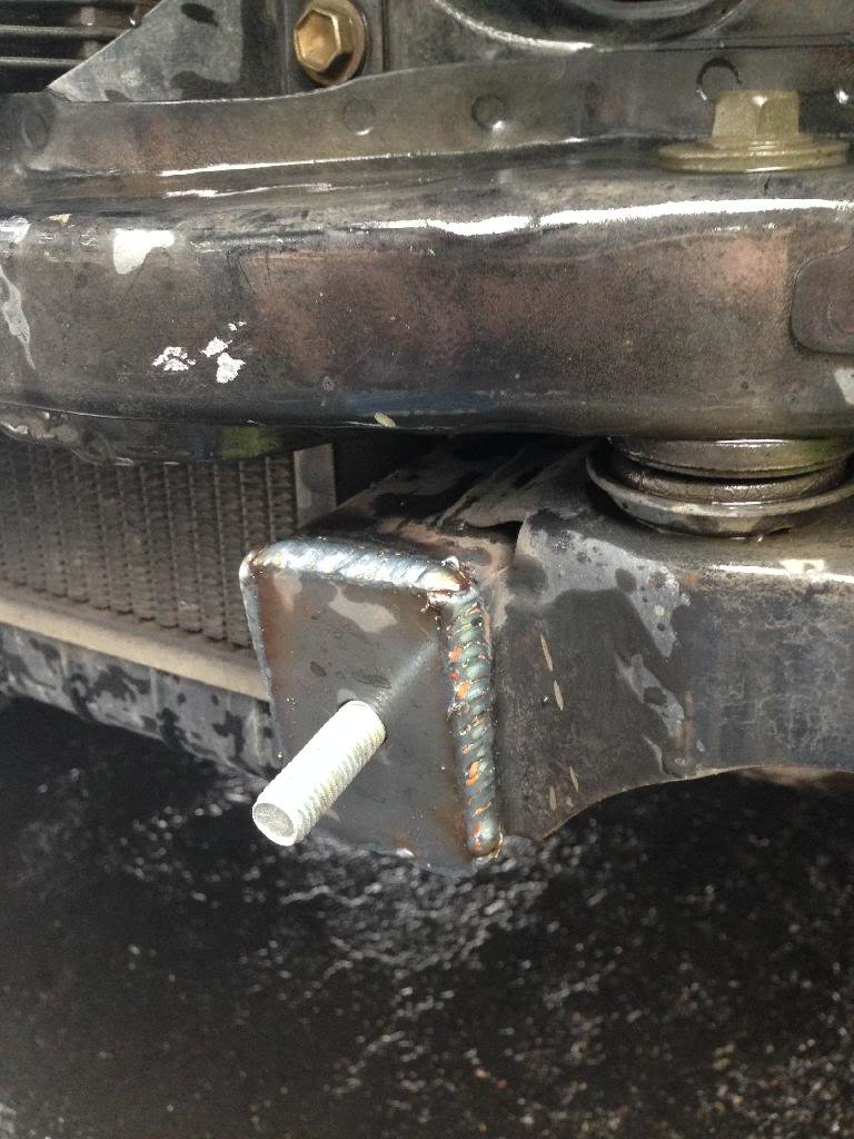

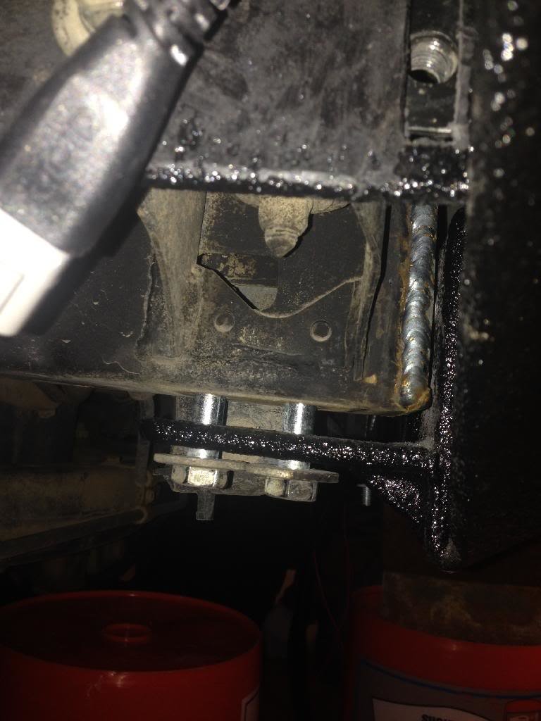

    Got the frame plates welded on:
    67AF99E2-C931-4B58-AE9D-E19B67F68E83_zps_71e951e2ee88d1891daf57a348cac605ae049cae.jpg
    CB007C88-4014-42BF-B45A-781130FCF9CF_zps_b6674bee210507f3a2248efbaa2626b715ef2782.jpg
    87C360D6-A536-4AF0-8DDC-4A9EEA4D3859_zps_4ac6b03b29fdce5a1d9c66f6fc7c3f633be49129.jpg
    2EE4DA95-CF74-44CD-B2BA-CD1605731345_zps_f42fcd2c625540661b0ed64b6c2ac1e506dee6ed.jpg
    One of the major issues that I faced was the holes where the frame bolt mounts onto the bumper needed to be shaved about 1/8-1/4" on both sides in order for the bolts to fit into the holes
    NO PICTURE
    The second issue is the bolts that screw into the bottom wouldn't go up all the way, they were done tightening when there was 1/4" left
    37D8473F-2317-4F57-9399-C747B4A77117_zps_bb8e0279f8eb09b9088cf6bbe39b46990dd8b776.jpg

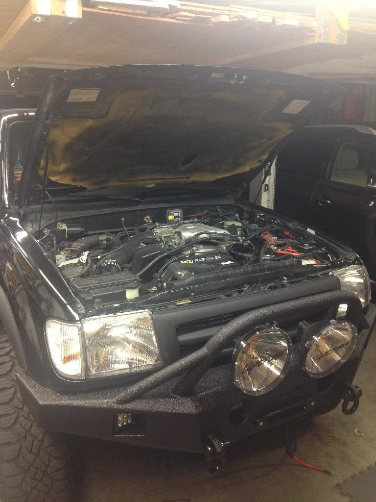

    Mounted up:
    97F2571C-CE1A-4D6C-9E44-BABB6990E53B_zps_634dd19a3a9be5f0f8b965c54e55db0438a19fe2.jpg
