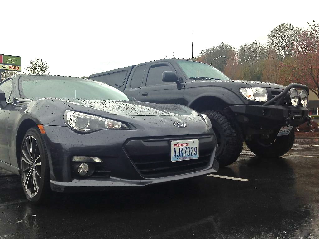

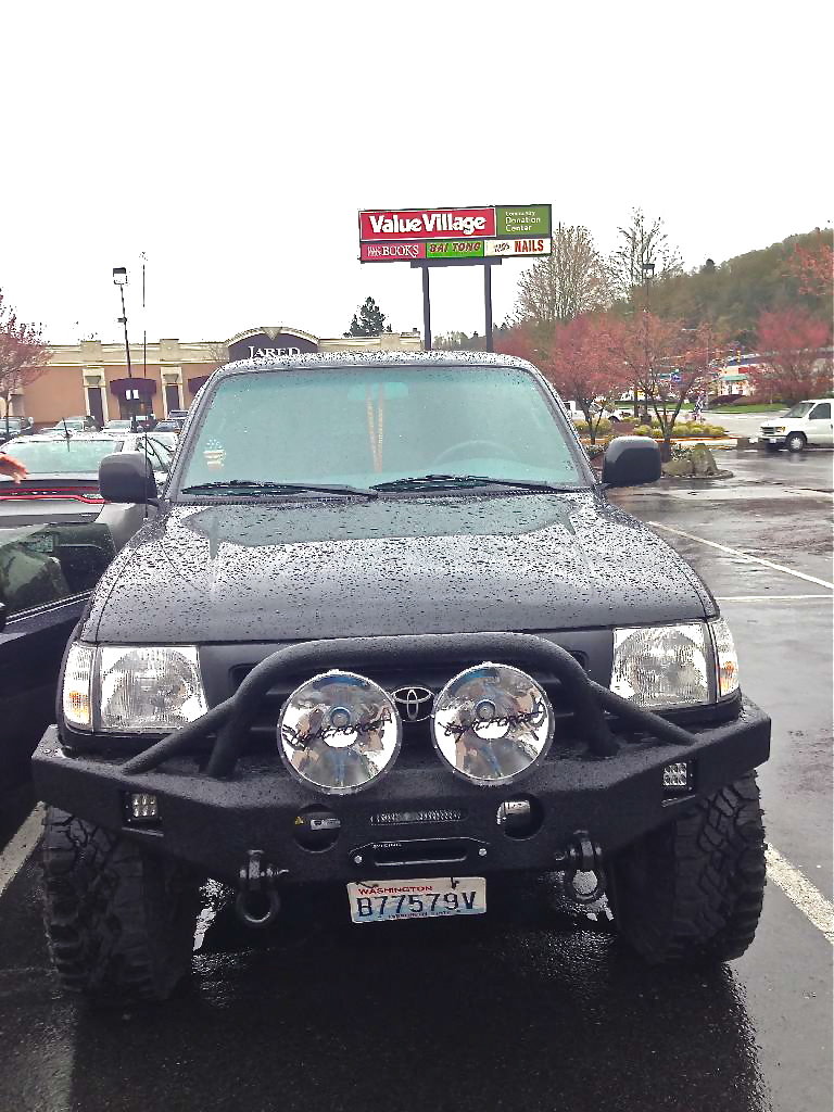

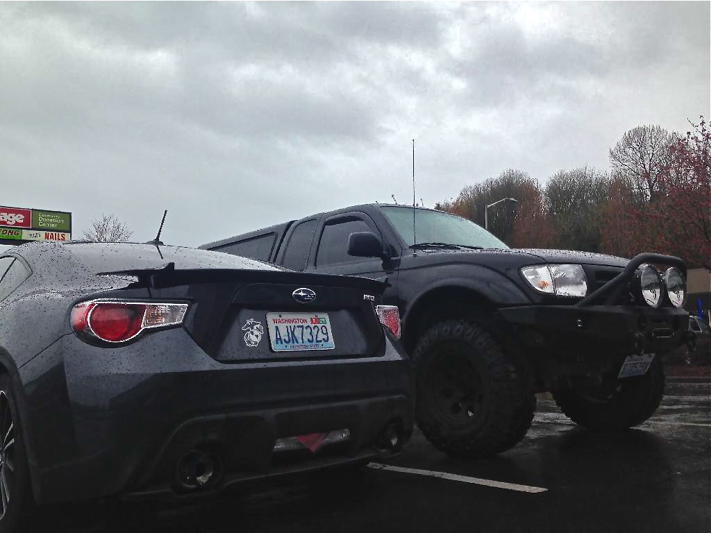

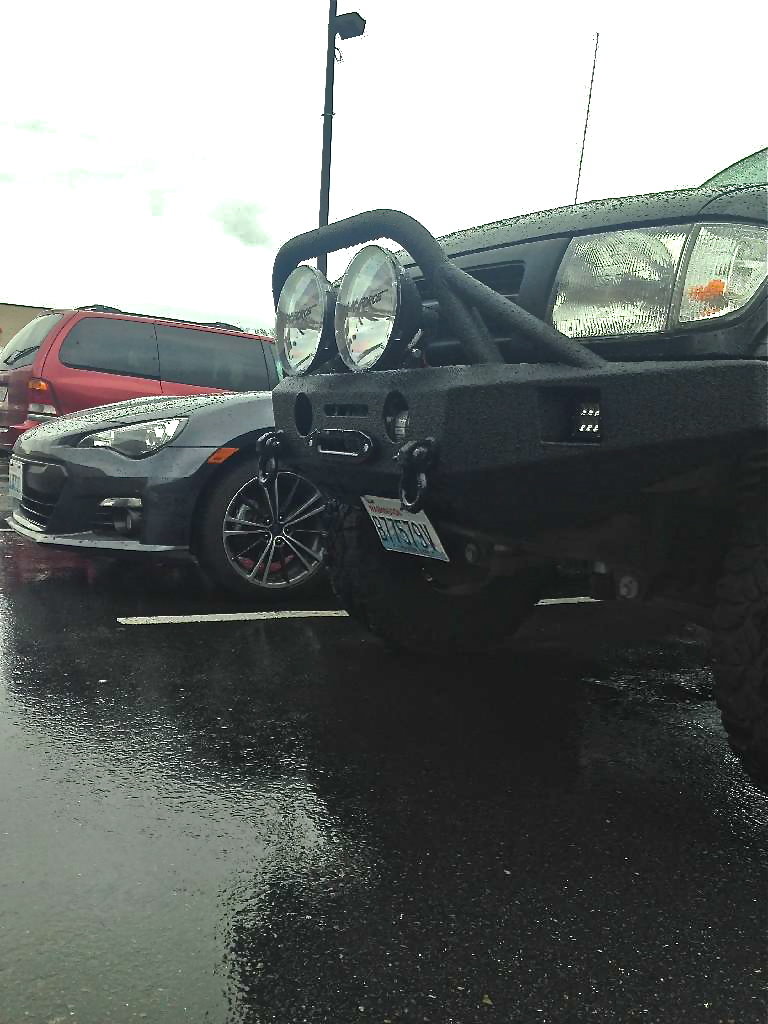

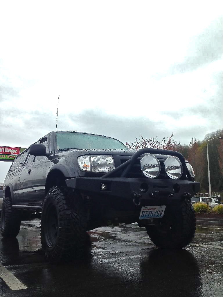

    Elite was just under 1k for the bumper itself. Sandblasting was $80 and then the Line-X was $325 so in total it's $1,400 or so.
    Great point, I'll be picking 4 of those bolts up in the AM from Lowes!
    As promised, see the following post
    Ah gotcha, yeah I might have to get to that tomorrow or whenever I come back home to get my truck after these next 2 months of training.
    A LONG time coming haha. Thanks for the compliments!
    Doubt I'll be able to get together for a meet tomorrow before I leave on Tuesday morning but in the future I'd love to get together with you all one last time before moving to San Diego for good
