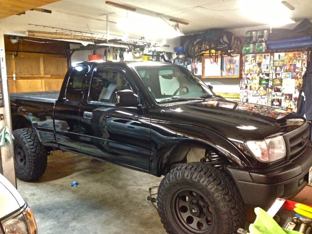

    Truck looks awesome!

    3.75 backspacing? That's the exact setup I'm looking to do.

    Thanks Lumpskie!

    Nope, 4" backspacing

    looks good! i love my duratrac's

    Yeah I told a buddy of mine who recommended these for an All Terrain tire, that I was sooooo glad I didn't go with the BFG A/Ts.
    These are much more aggressive looking, hopefully don't turn into racing slicks in the mud & are surprisingly quiet.
    On a side note, when driving around town on my way home (took the long way home :D) I did not notice a significant power loss like I thought I would with these 285s. I really had to pay attention to notice that it didn't have as much giddy up.
    Just a thought for anyone considering this size of tire like I was before I made the leap..

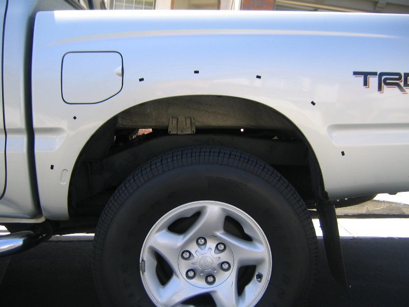

    Dude! Looks awesome. Definitely the correct tire size for your truck / lift combo.
    Looking at your truck makes me wish I didn't have fender flares though, that offset looks killer. You're gonna sling mud & water like crazy when it rains lol. :cool:

    Take your flares off... that's what I did. I still need to wash/wax & paint a few spots that my flares were hiding so we'll see if they stay off. I didn't think 0.5" would make that big of a difference. Yeah these Seattle prius/smart car drivers are gonna really love me :rolleyes:

    *defeated sigh* you pre 01 guys have it so easy, remove a couple bolts and take the fenders off.
    Unfortunately the 01-04 Tacomas have holes in the fenders for the little clips that hold the flares on. So if I take them off I'm left with this awesome look:
    That will net you more rubbing in the pinch weld area FYI. 4" of BS seems to be the ideal number for 285's. Now if you want to run 33x12.50 tires then 3.75" seems to be the magic number. I run 4.5" of BS with 285's, 881s, 10mm spacer and do not rub on the pinch. I rub on the frame :rolleyes:

    I want to know what the genius was thinking when he thought of that engineering idea... :annoyed:

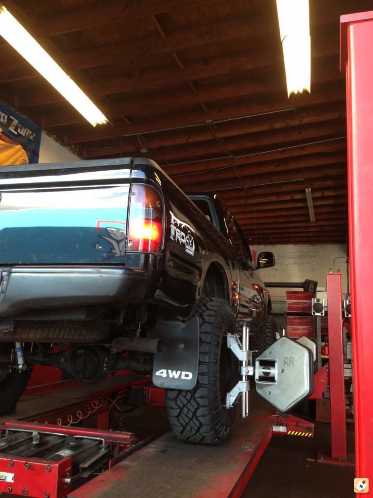

    Waiting for an alignment at Les Schwab

    aaaand now getting the alignment
  17. Sep 18, 2013 at 4:54 PM

    Alignment all said and done earlier, now I don't have to turn slightly right to drive straight :D

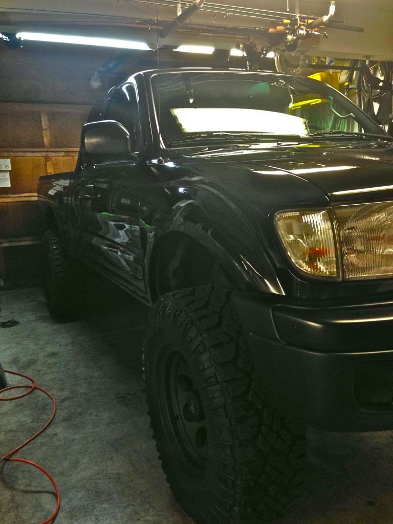

    Now time to wash & wax out the fender flare marks so I can see if they can stay off :cool:

    Last Wax Before USMC Boot Camp
    I'll be leaving for the good ole' Marine Corps Recruit Depot down in San Diego on December 9th, so this will be the last wax that my rig is gonna get before I make the transformation into a warrior.
    A Few Pics I Took Before Waxing:
    http://www.youtube.com/watch?v=fULNUr0rvEc
    Wax On:
    Wax Off:
    More to come (tomorrow) when I do a good ole' photo shoot of her all waxed, giggidy.
