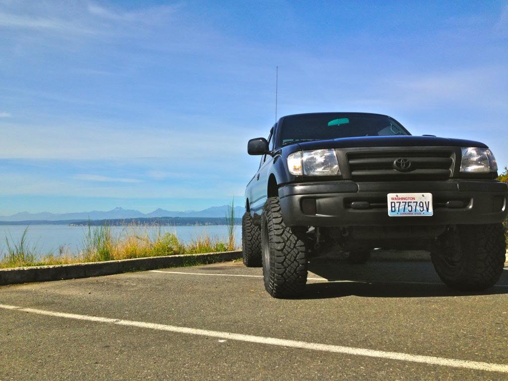

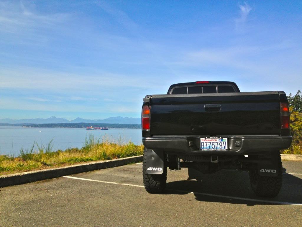

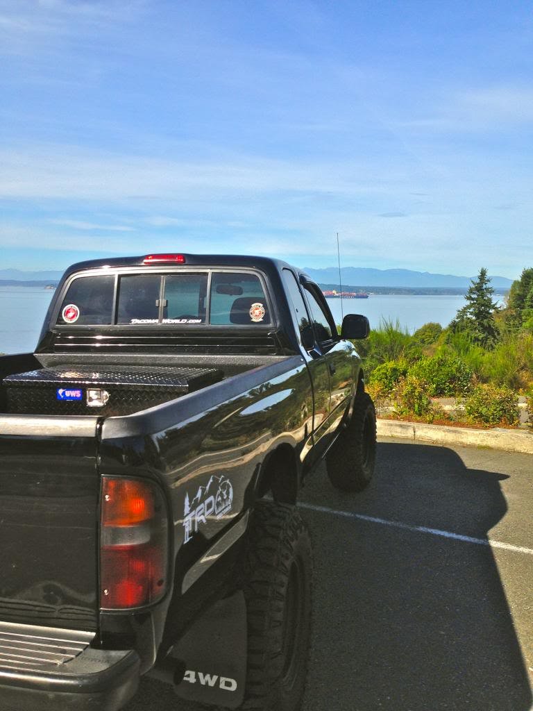

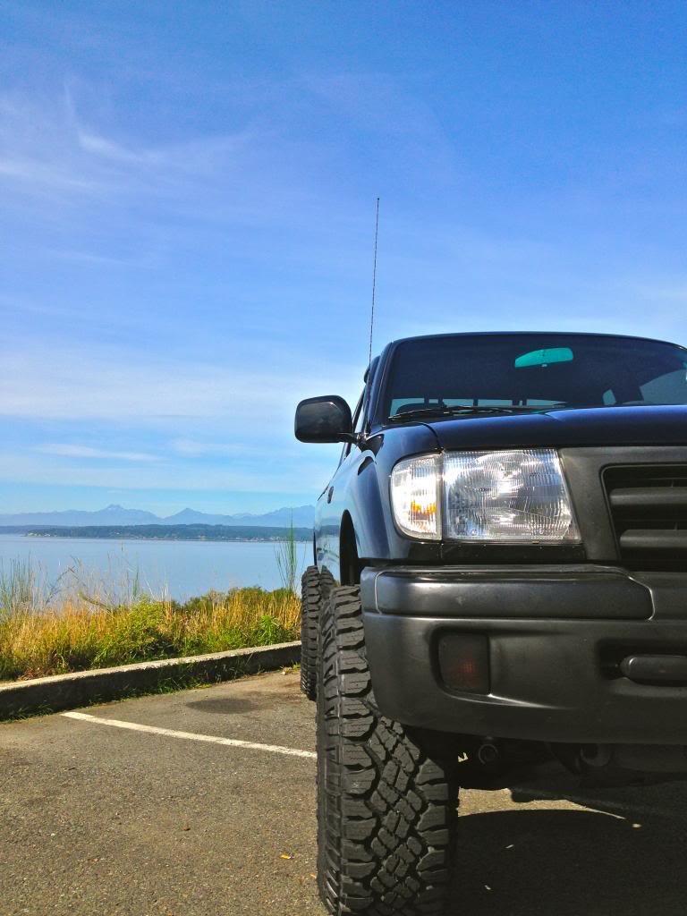

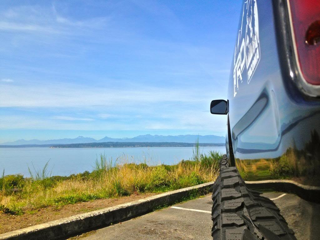

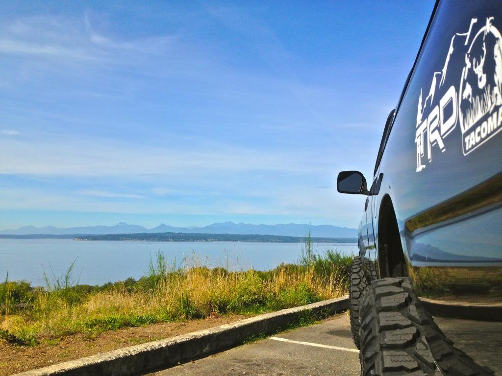

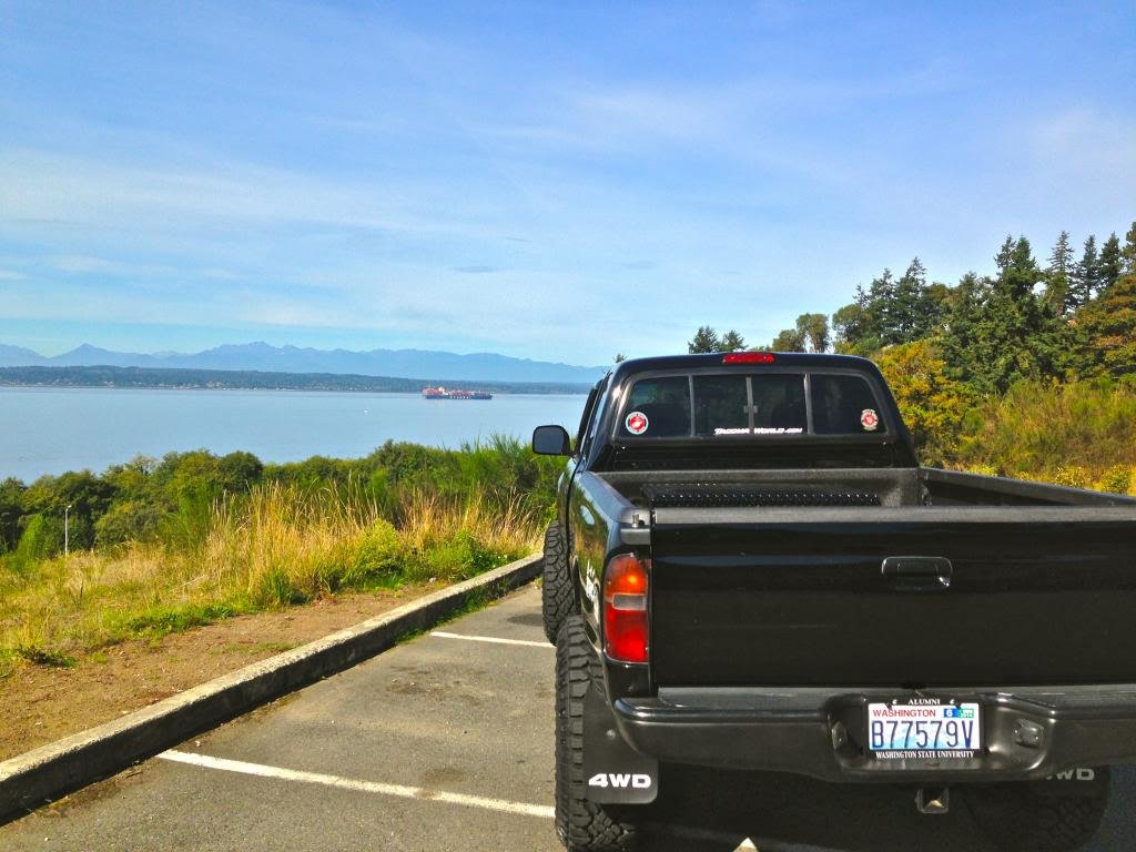

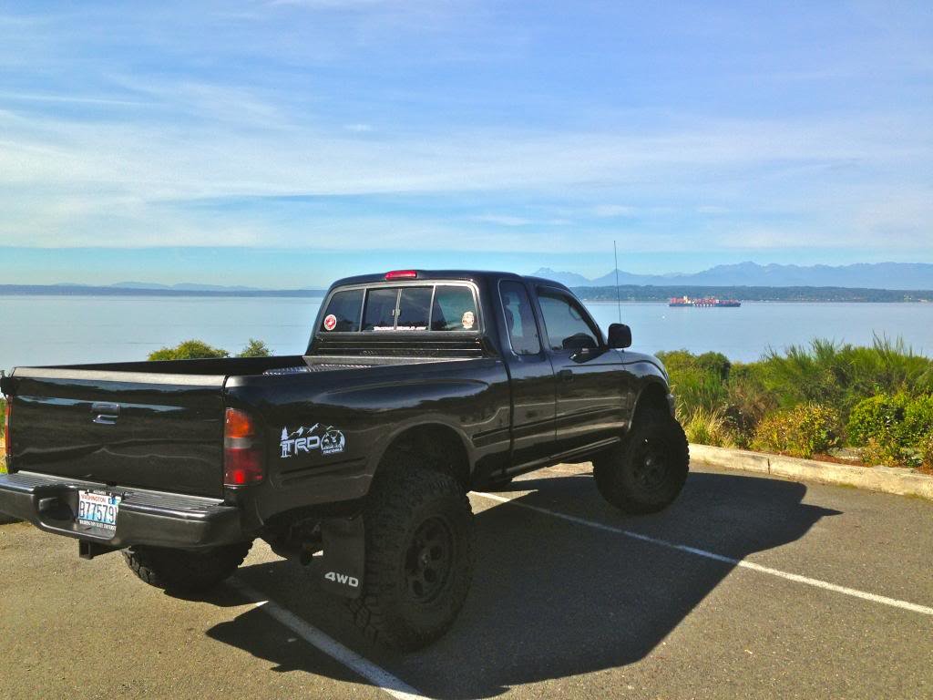

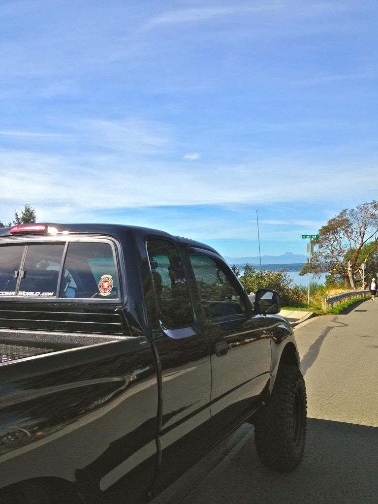

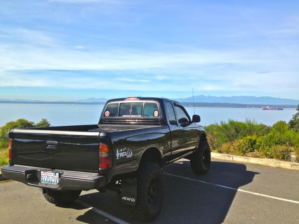

    Had Ourselves A Little Photo Shoot:D
    Gonna post the rear shots first, and then the fronts and a couple miscellaneous photos.
    Here they are, starting with the rear shots...

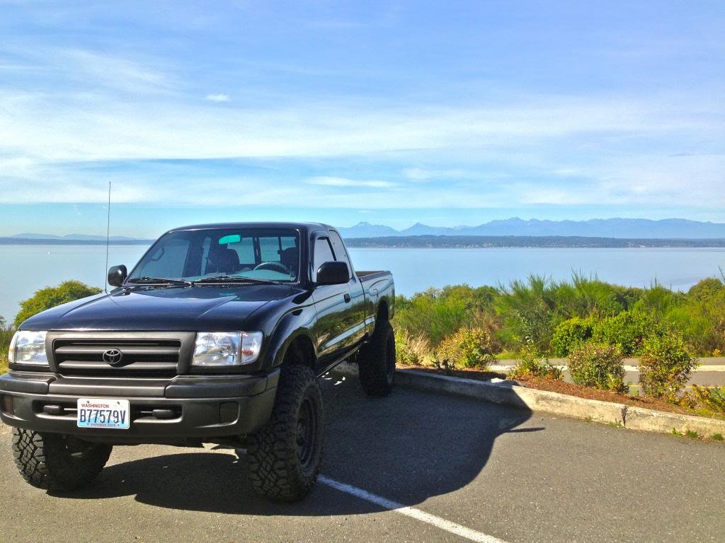

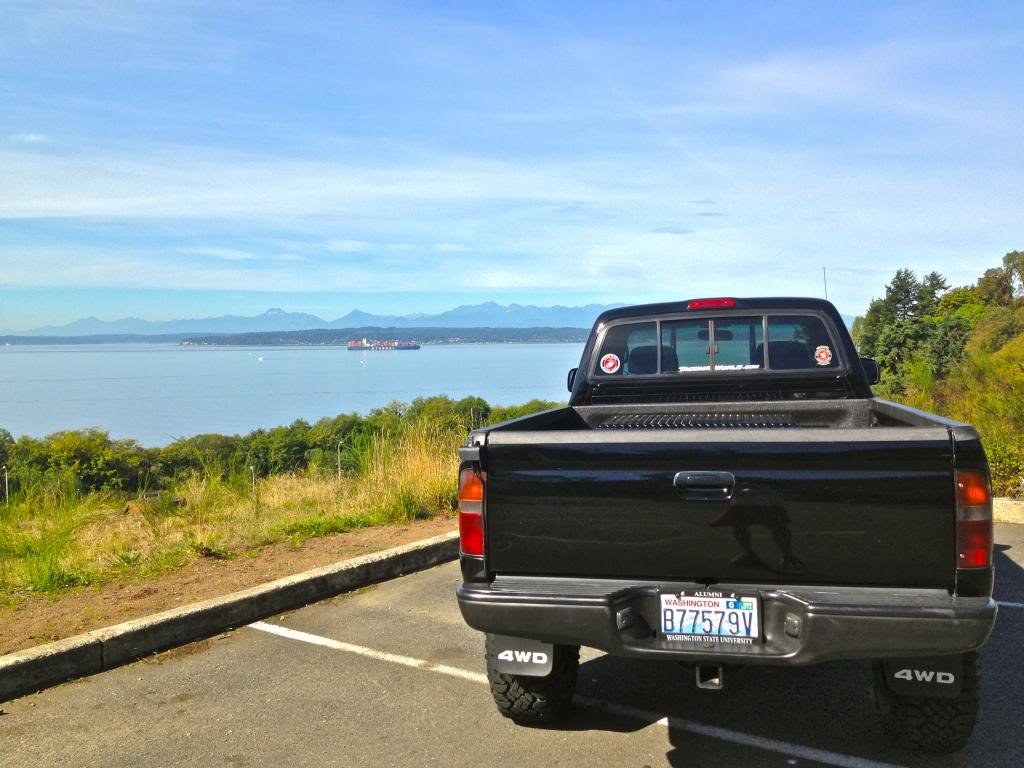

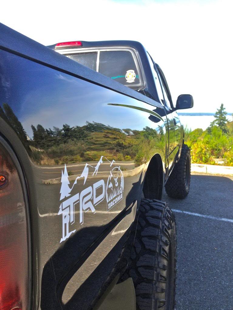

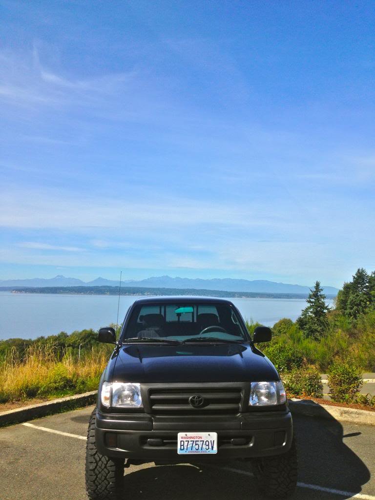

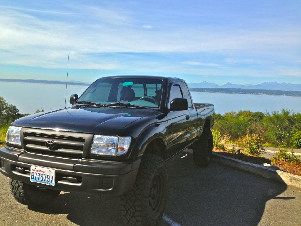

    aaaaaand the front shots:

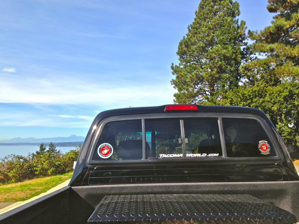

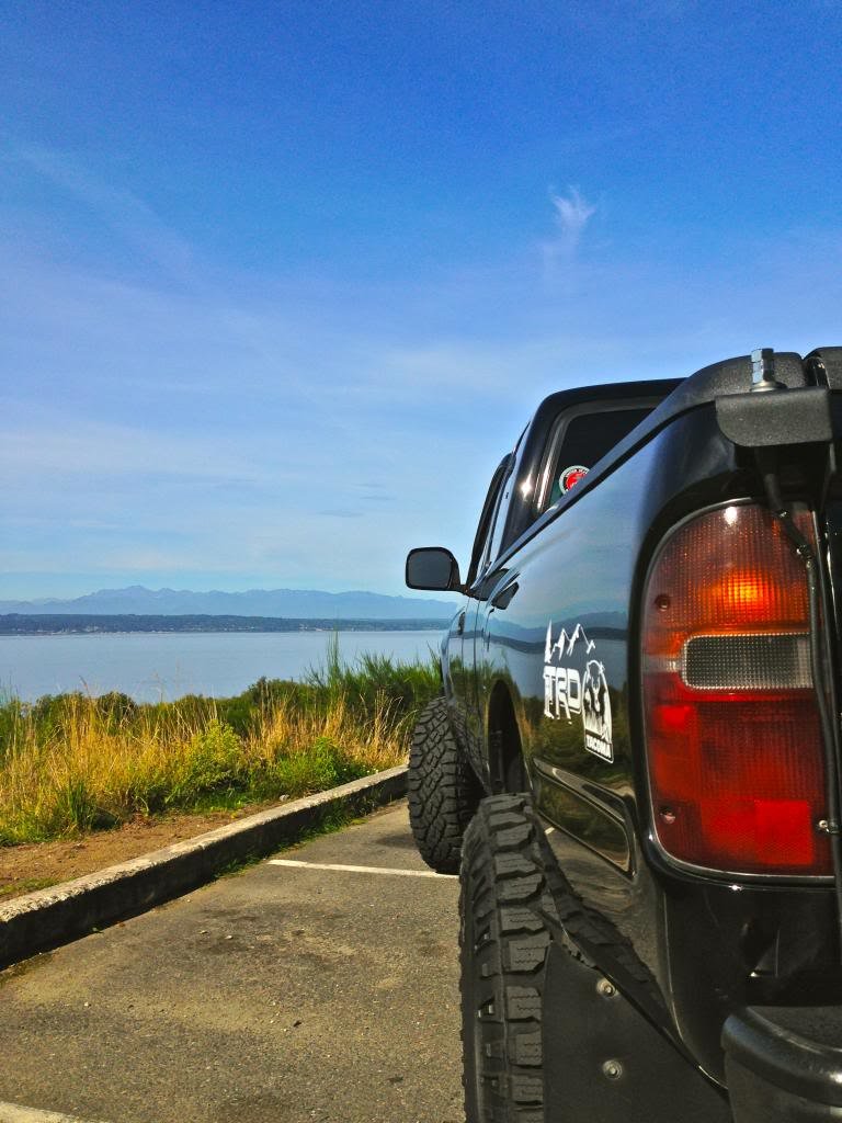

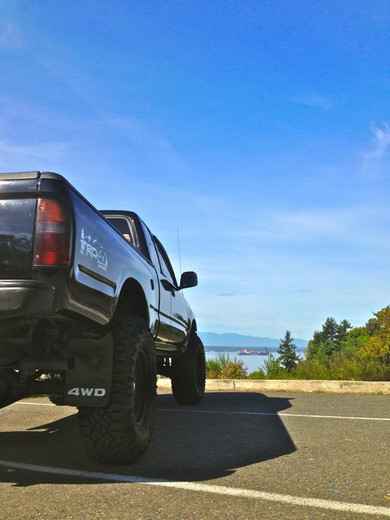

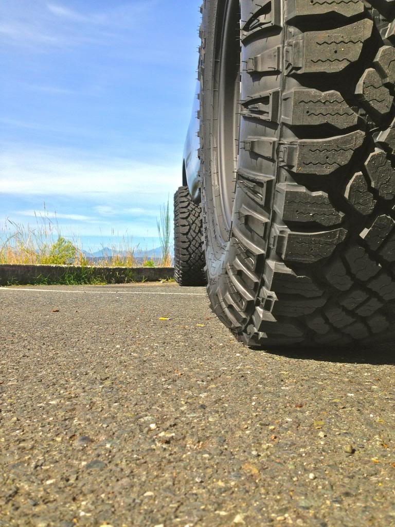

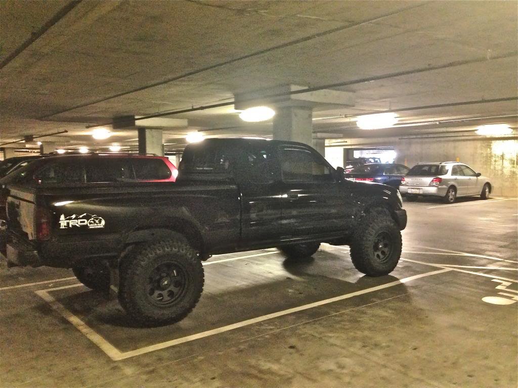

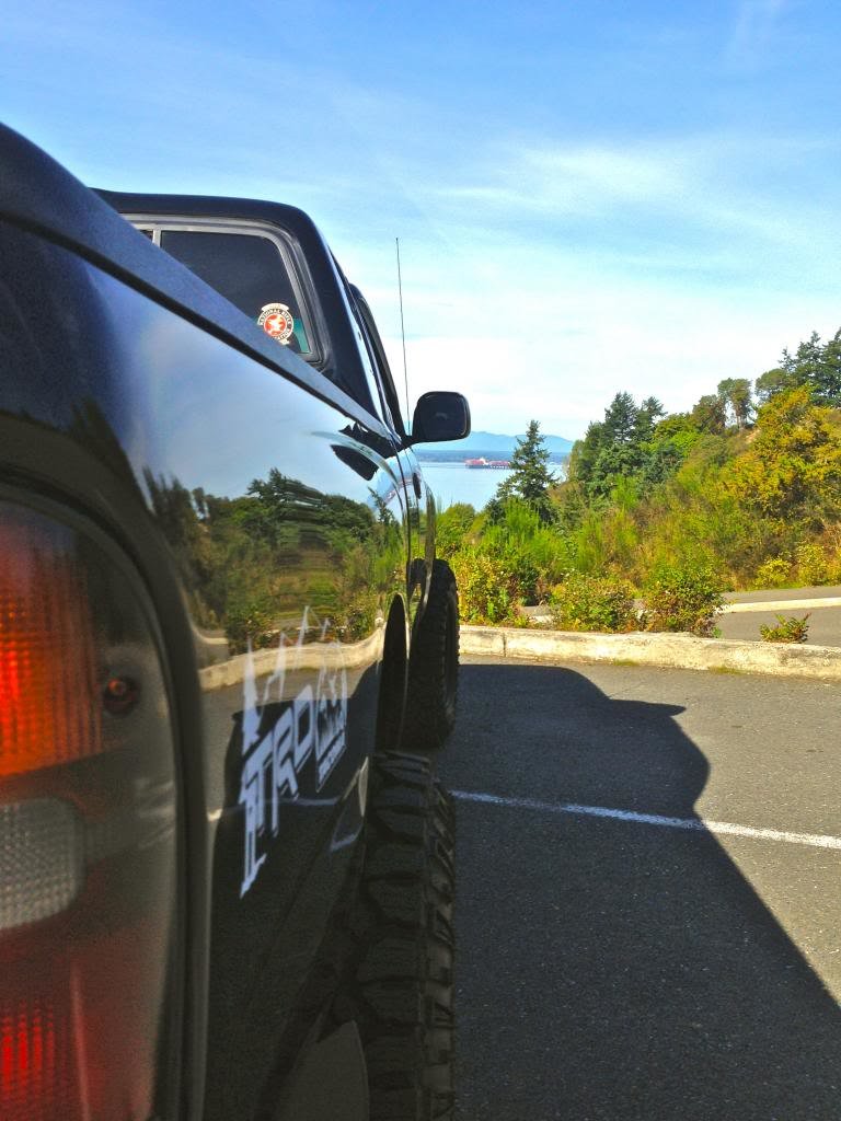

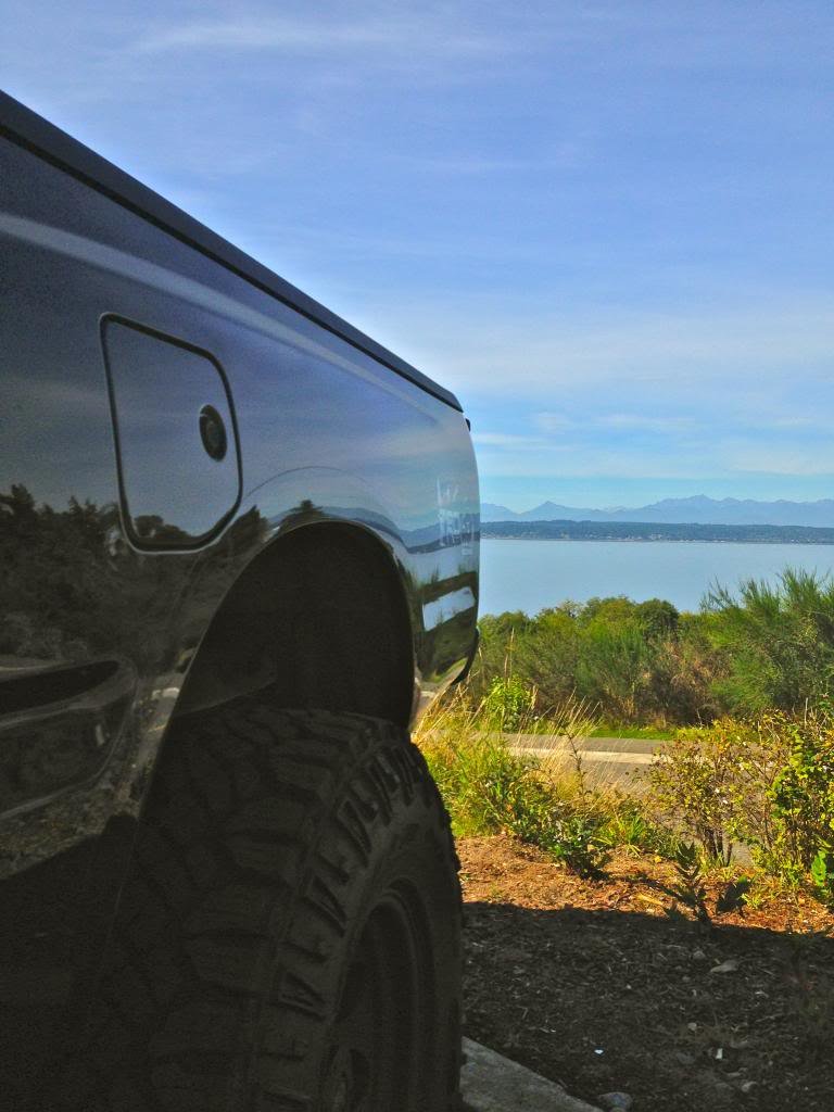

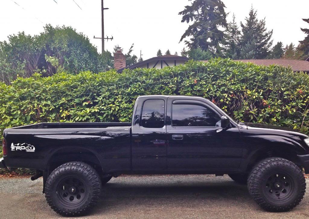

    Lastly, some miscellaneous photos...
    At the top of the park:
    In the YMCA parking garage:

    Super nice truck! Any rubbing issues with the wheels? Looking at the same wheel/tire combination myself.

    Thanks! No rubbing whatsoever; cut off/ground/hammered the pinch weld for safe measures but to my surprise there isn't any rubbing. Probably would rubbing be off road if you flexed it..
    My lift/suspension gives me a good clearance (3-4") so I think that helps a lot. Running Eibach 3" coils up front (more like 3.5") and 3" All-Pro Expedition Leaf Springs in the rear (again, more like 3.5-4").

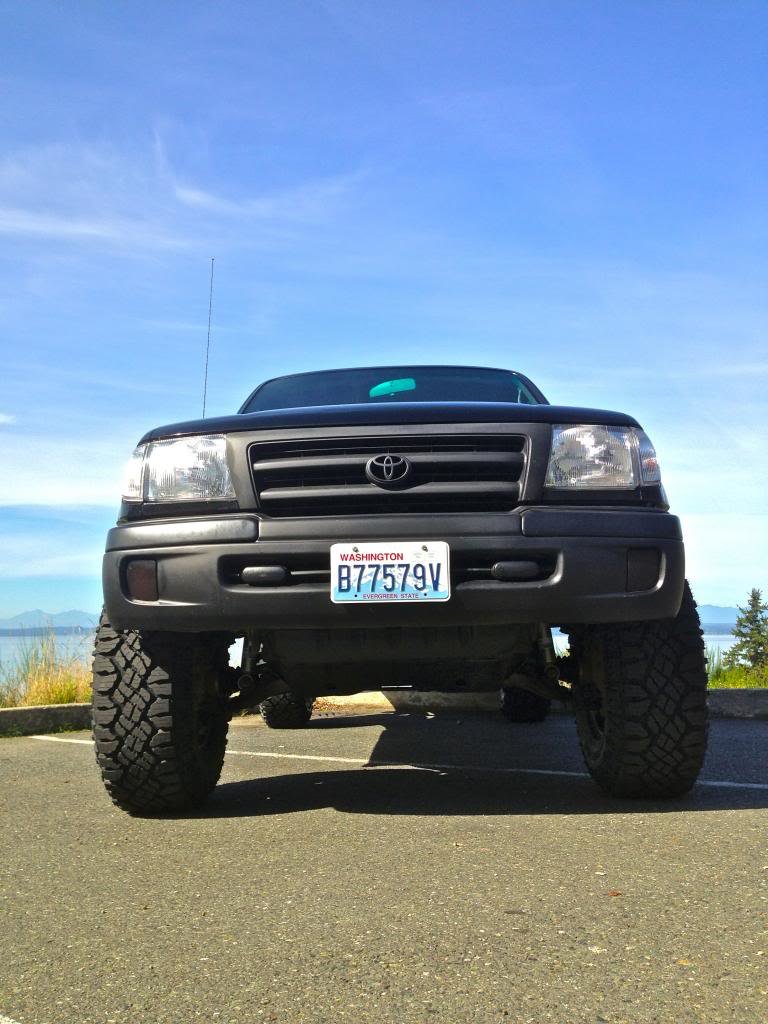

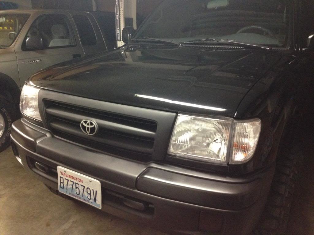

    Messed up on my grille when I originally bed lined it so I took a razor & some sand paper to it (that rustoleum bed liner stuff is actually really tough)
    -- well I kind of like how it turned out. I'll leave it for a few days and eventually black it out if it doesn't grow on me:
    Full Front End Shot:
    Close Up Shot:

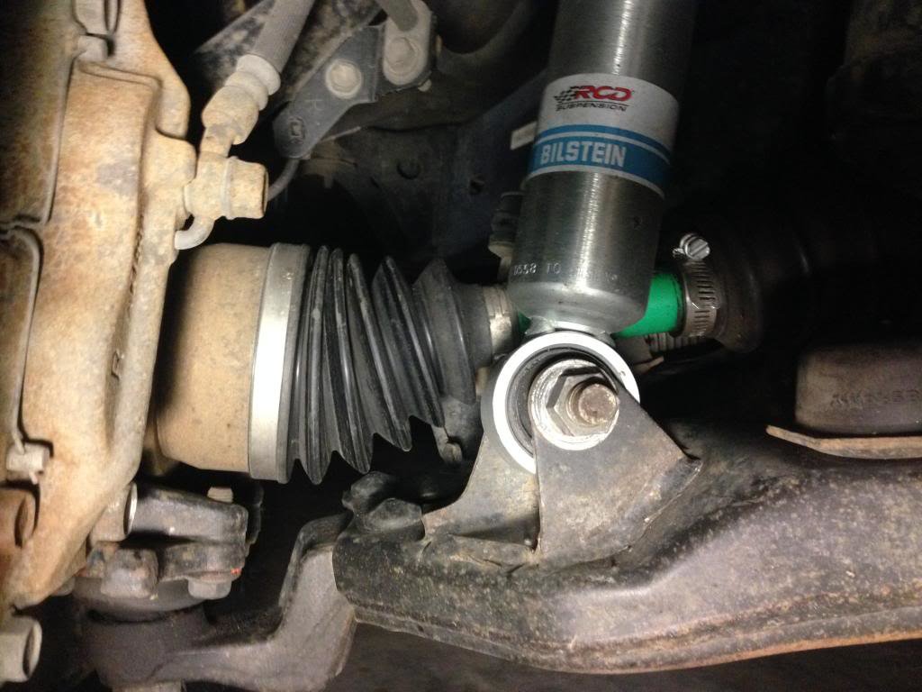

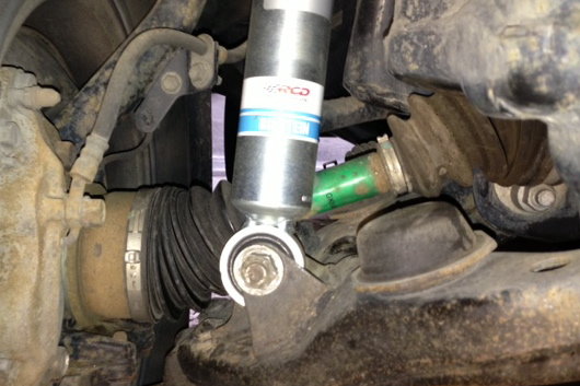

    I looked at my CV angles and noticed they are a bit better than they were with just the Eibach/Toytec coils installed when I was in the dark with All-Pro and their shipping issues for nearly a month.
    Well this is the passenger side CV joint angle before with just the front lift in:
    This is the passenger side CV joint angle after I lifted the rear and put 33" tires on:
    Definitely a noticeable difference, now the CV looks more or less flat as opposed to being so angled. I feel better about not blowing a boot as quickly :eek:

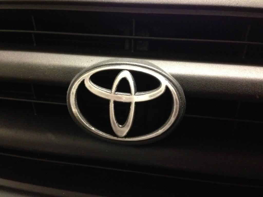

    Another picture of the front Toyota emblem:

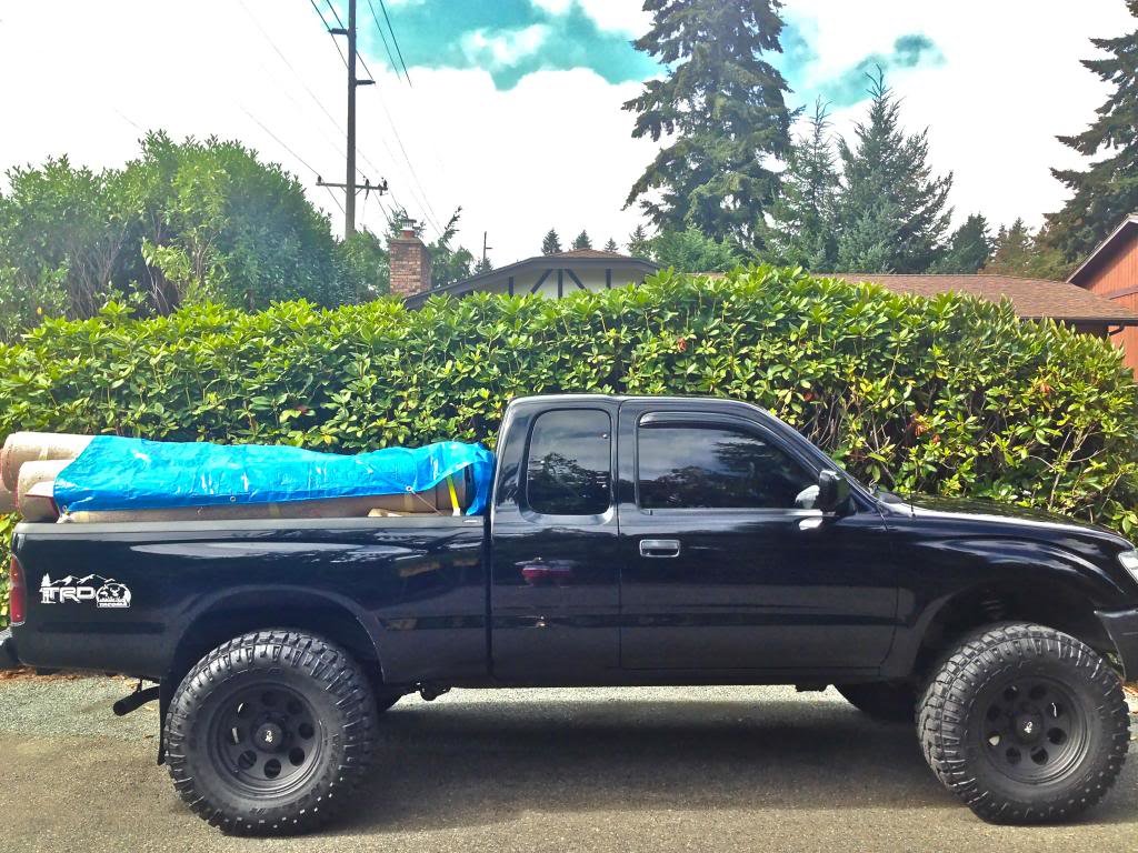

    Took a load to the dump:
    Coming into the dump = 5020 pounds
    Leaving the dump = 4120 pounds
    Total amount I was hauling = 900 pounds
    This is as close to precise when comparing as I can think of with known weights and how the All-Pro Expedition leaf springs handle it:
    Before the Dump:
    After the Dump:
    I tried to get the exact angle again for easy comparison. I think they did pretty good for 900 pounds in the bed

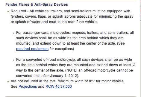

    Trying to figure out what to do with these mudflaps
    They look goofy to me :confused:

    Take them off. I think extending them outward would look far worse then they do now. do you have to run flaps in your state?

    I believe so... either those or fender flares from my understanding. This is what Washington State Patrol states on their website:
    Screenshot2013-09-21at55656PM_zps4de9d3e_b01d37dfdc58ee9c63dca5fb4a3efbecfcac25bd.jpg

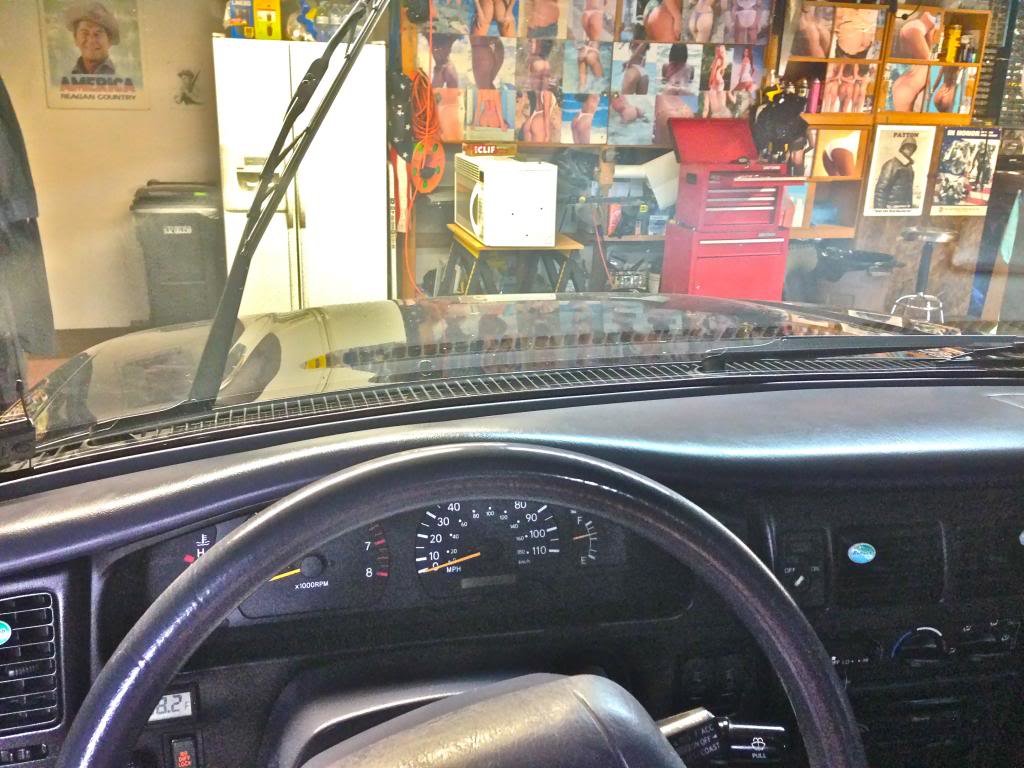

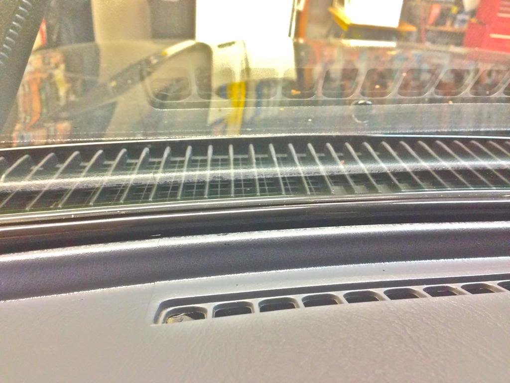

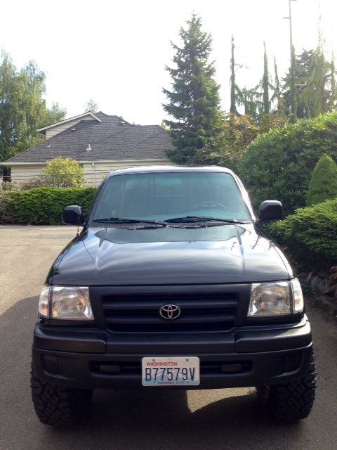

    Well, I fitted my windshield/dashboard rubber a little better...
    Far Away View:
    Close Up View:

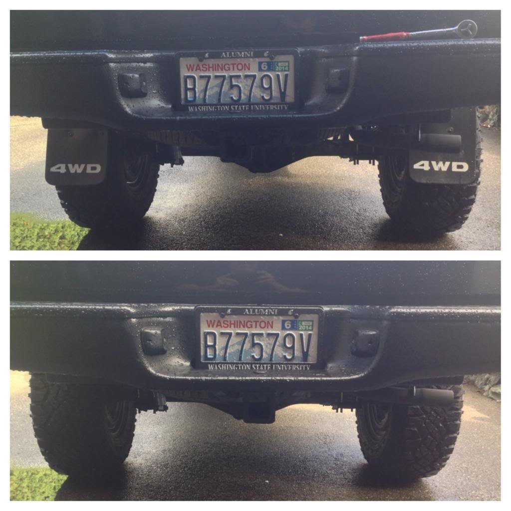

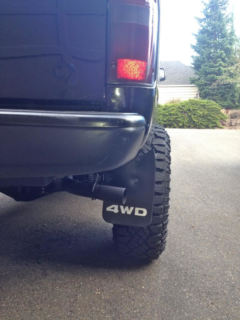

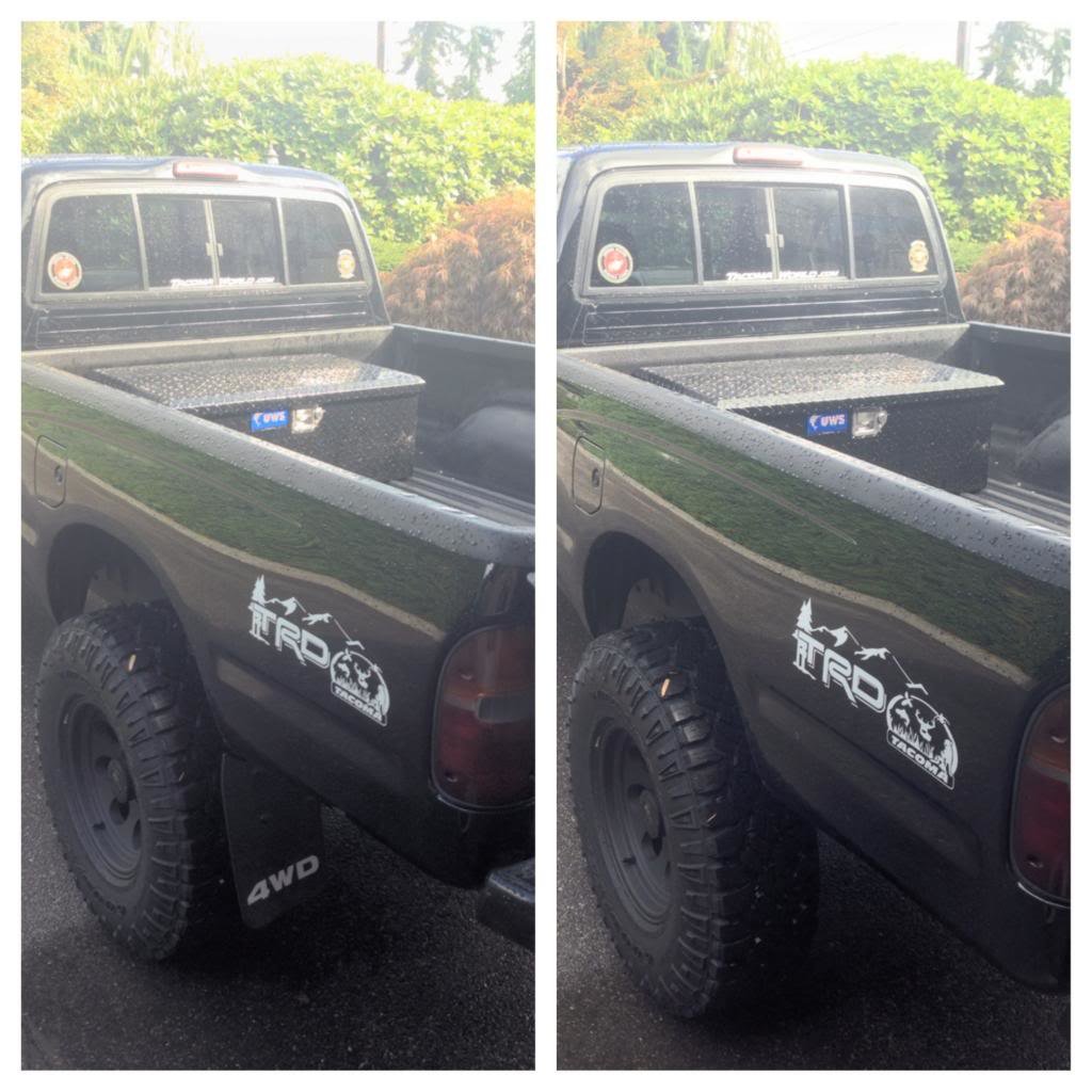

    Took My Mud Flaps Off
    Before/After Pics:
    Rear
    Driver Side
    Passenger Side
