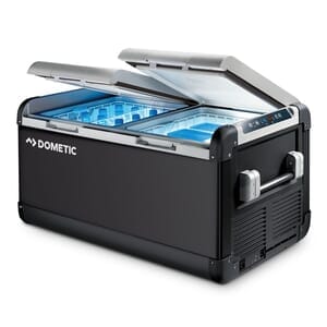

    We have a CFX75DZW, it's pretty massive, and has the two compartments. What we love is that we can choose how much of the fridge we want to use. Short weekend, we will throw the cold stuff in the small side, and all our ambient foods in the large side. The temps can be controlled 100% independently, so we just turn that side off. Gives us three options, small side cold, big side cold, or both cold. I've never used it to actually freeze anything yet.

    I have the same one and love it as well. One thing to take into consideration is the fact that you will no longer be using 1/3 of you cooler space for ice, if you have a 50qt cooler now and its sufficient then you'll probably be just fine with a 35 or 40qt fridge.

    Yep, I was using a 50qt Rtic for all the food, and then a small 12qt soft sided Rtic for drinks. Now not having to use ice I can pack a weeks worth of food and still have one whole side for adult beverages.

    It opens fully if my Habitat is open. Otherwise It opens plenty far I can stick a gallon milk jug in. And i recently figured out how to pop the lids off for easier loading when it's closed, too.
