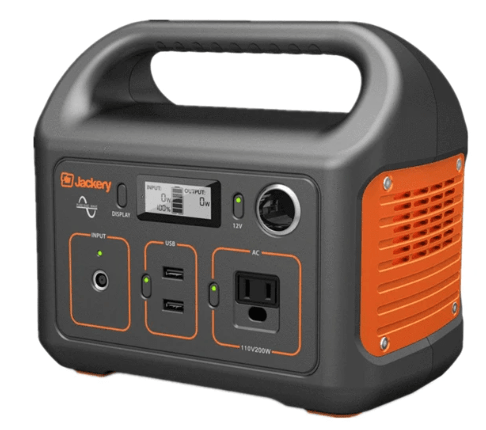

    Sorry, want to make sure I understand the wiring... you plug the Jackery into the Bed outlet... so the jackery has a 120 VAC input and then you plug the fridge into the 120 VAC output from the jackery? And you could also plug a solar panel into the jackery when you are at camp or stopped for a few days??
    thanks for clarifying that. sounds like a super sweet set up, think I might go that route... by the time I get a deep cycle battery and case and solar panel and regulator I might as well get a Jackery that is 1/3 the size and has other features. appreciate your input.

    I am confused how you plug the jackery into the bed outlet... do you have a converter in between?

    No inverter. The Jackery comes with an AC wall outlet charger that I plug into the tacoma bed 110v bed outlet (came from the factory in my gen 3). It will only charge when the truck is on. The fridge plugs into the Jackery 12v (cigarette lighter) outlet. So in the image below you can see where the charger goes into the "input" and you turn on the 12v and plug in the fridge using "lighter outlet". I suppose you can use the ac outlet for the fridge too but I think that is less efficient. If you need more juice they sell a larger one.
    Edit: I guess there is an inverter. But it's the factory setup on the gen 3s. I thought you were asking if I added anything else to connect the jackery in the bed. If you don't already have the factory bed outlet I would just run a 12v cigarette style outlet to the bed. The Jackery comes with a 12v charger also. But honestly. If you are just a weekend warrior you might get away with just running your fridge off the jackery for the weekend and never charging it. Maybe the larger one is worth it to give you more time.

    You got the perfect setup. Just a bit too pricey for me. The Jakery set me back about $250 and I called it done. I'm mostly just a weekend warrior with maybe one extended trip a year. So the factory bed inverter has been good enough to keep the Jakery charged. I might get a solar panel if I see one on crazy sale but honestly with my normal driving on an offroad trip the Jackery has never run out on me. I also run the CFX 35 under a black tonneau. I think the solar panel would really just be for me to geek out over it or for SHTF reasons.

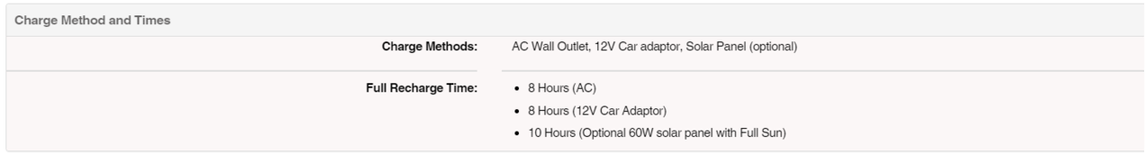

    So the Jackery can’t be charged from 12V DC? I assumed all these GoalZero/Jackery devices could take either AC or DC in to charge? Perhaps that’s why the Dometic PLB40 is so pricey, other than the form factor. With integrated B2B and solar control it’s 3 boxes in one.

    It can. It comes with a 12v "cigarette lighter" style charger. but my stock tacoma doesn't have a 12v outlet in the bed. I can charge it inside the truck but I like to have the fridge plugged in to the Jackery and the Jackery plugged into the bed outlet so I don't have to move things around. Just set it and forget it. I don't see any advantage to adding an aftermarket 12v DC charger to my bed since it wouldn't charge it any faster (edit: found out it does charge a little faster on DC). The only downside is that I have to make sure to remember to switch on the bed outlet when I jump in the truck. The bed outlet doesn't come on unless you switch it on every time you start the truck.
