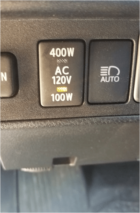

    right on, the jackery is on its way... right, I have a 3rd gen with the outlet... interesting you have to be sitting to get 400 watts but the 100 while driving will be find. Thanks if you have time for the photos would like to see them.

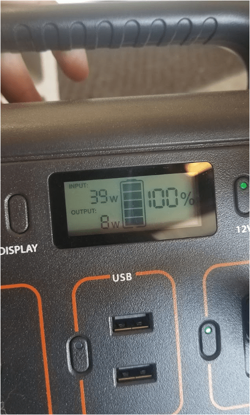

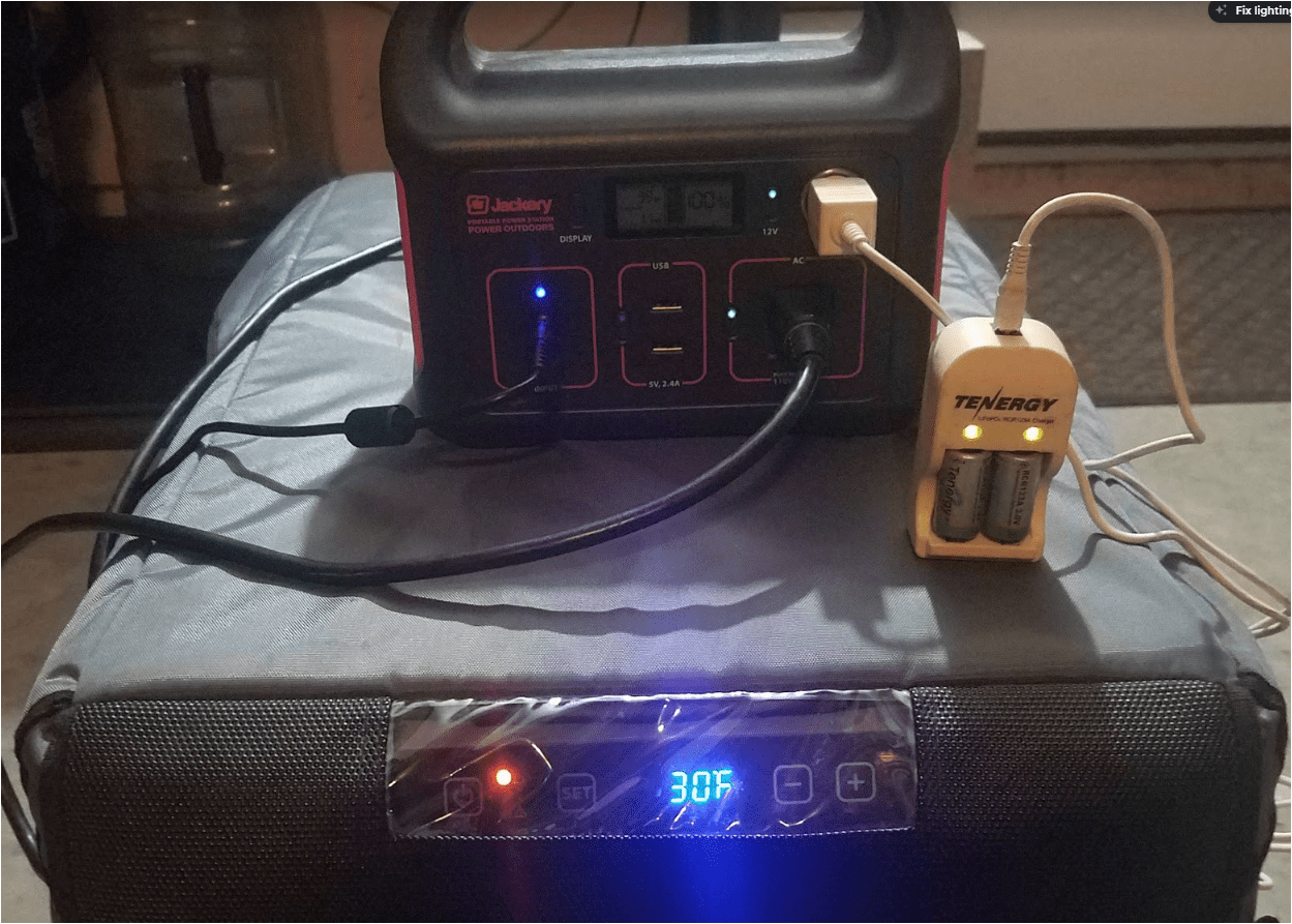

    I set it up in the garage so I could take a picture for you. It works the same in my truck. The jackery is plugged into my wall outlet. My fridge is plugged into the Jackery AC two prong outlet. I also plugged in my flashlight battery charger to the 12v DC outlet to show that it could run multiple devices. The only difference in the truck is that I have to remember to turn on the bed outlet.
    The display shows you how many watts are coming into the Jackery and how many watts are going out. My fridge and flashlight charger were only drawing 8w at the time. I think that's low because my fridge was already at temperature so I don't think it kicked on . I keep it in the garage full of cold beer.

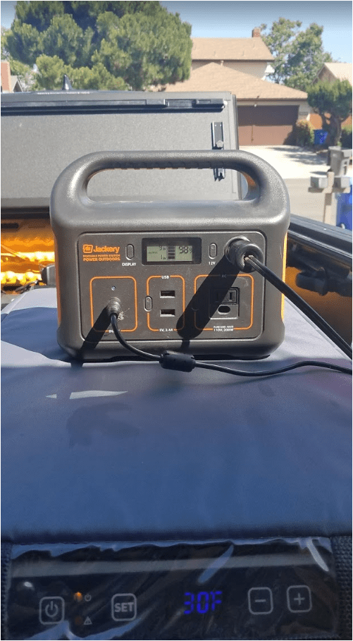

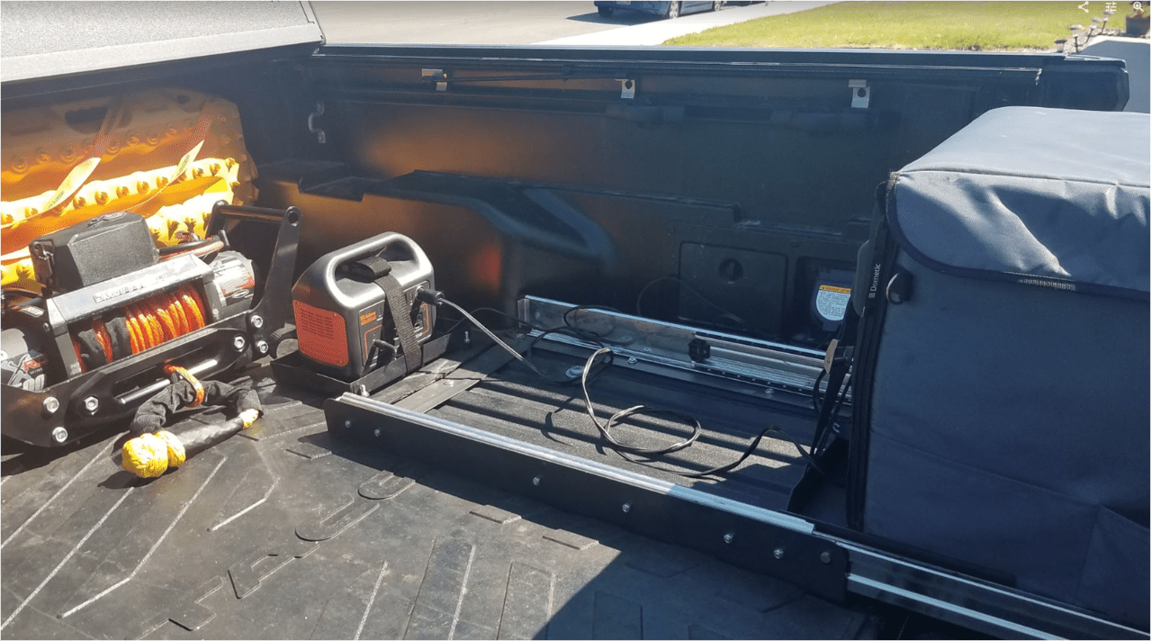

    This is what it looks like in the truck.
    Even when the bed outlet is set on 100w it charges just as it would in my house.

    wow, envious... where did you get the rail system, that is what I plan to do after this trip... don't have time right now.
    do you ever have a hard time with the fridge working from the Jackery when it is hot out, like now.
    I imagine keeping the windows down in the back help but still. My fridge looks like its speced to run up to 80 and I am sure will run hotter than that but will be less efficient..
    gesh, love the rails!! thanks for the photos
