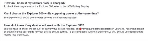

    Here is what the manual states...

    They need to make it clear in the manual then. They are misleading people. They need to design a proper charge controller to handle what the manual claims it will do. It should be possible to do a thermal incorporated sensor design that in some cases limits how fast you can charge if you are also discharging. They could use two banks and alternate with intermediate cooling, they could use a super cap to act as a 'buffer'. there are all kinds of engineering solutions they could pursue. instead they have lied to their customers. now I either buy the extended warranty and just use the thing or I send it back and look for another solution... but I also have to send the solar panel back as well... unless the connector is universal and I seriously doubt it is. frustrated. I wonder if other users that have done pass thru have noticed any decrease in battery performance??

    Yea. Well it can. I think you are probably fine. The fridge doesn't pull a lot of power and it runs on a limited duty cycle. So majority of the time, you aren't charging and discharging at the same time. Even when you are, you aren't outputting max power while charging so I don't think you're going to damage the battery. But that's just my opinion based on knowing very little about this particular product.
