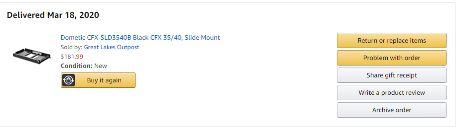

    I've had the fridge since 2014 and never bought a slide because they were too expensive and it really didn't improve anything in my old jeep. But for the truck I really wanted one because of the tailgate. I put it up on https://camelcamelcamel.com/ and got a low price alert back in march so I jumped on it. I'm pretty happy with it. I don't think I would have saved much building my own DIY fridge slide. If you are interested you can see my setup here https://www.tacomaworld.com/threads/high-speed-low-drag.673276/ . It's not much but I take my time and think a lot before I do anything.
    Edit: You got me thinking if DIY would have been cheaper. found this https://forum.ih8mud.com/threads/homebrew-fridge-stove-slide-combo.604751/ . I still think the price I paid was fair though. I don't think they are worth the $300 they ask for them.

    oh that is pretty reasonable, some of the heavy duty slides I saw were 10 times that. I agree, I think I would just pay the 200 to 300 as I don't have time to tinker as much as I used to. thanks for sending that link, that would likely work well for me too. good deal I reckon. thanks
