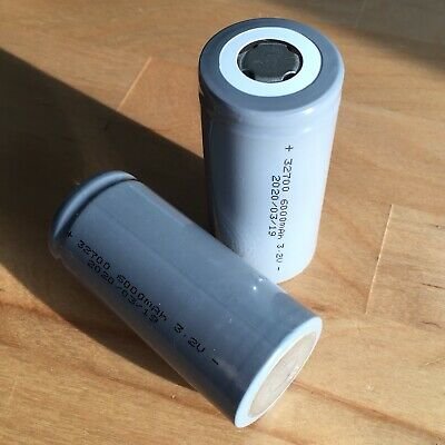

    Yeah... wow. Nice work. So 120AH at 12.8V, or were the ones you actually used 5.5 vs 6AH like the ones in the pic?

    Mine say 5.5ah. I made the pack several years ago and I don't think there were any 6ah available at that time. The rating on the side of those Chinese batteries is almost always "best case" anyway. The guy in the link I posted above put his bank under a 107amp load, and nothing burnt up.... I put a 60amp circuit breaker in mine, enough for a 600w continuous inverter.

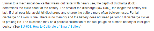

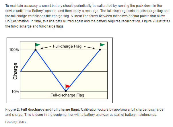

    Edit: some googlefu turned up this page. https://batteryuniversity.com/learn/article/how_to_prolong_lithium_based_batteries
    And looks like they should be calibrated from time to time

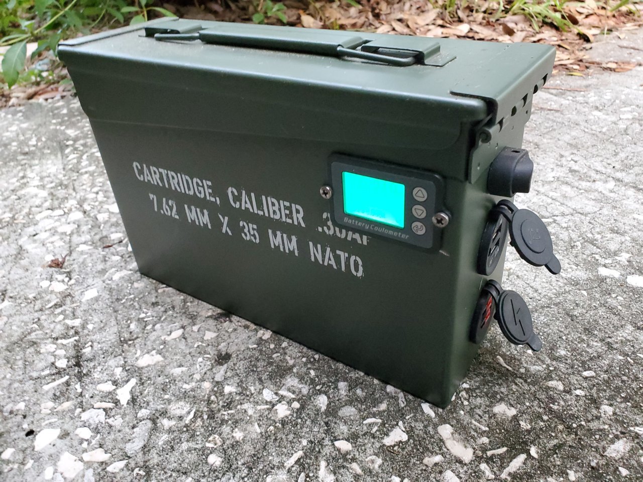

    I also made a 25ah version out of an ammo can....
