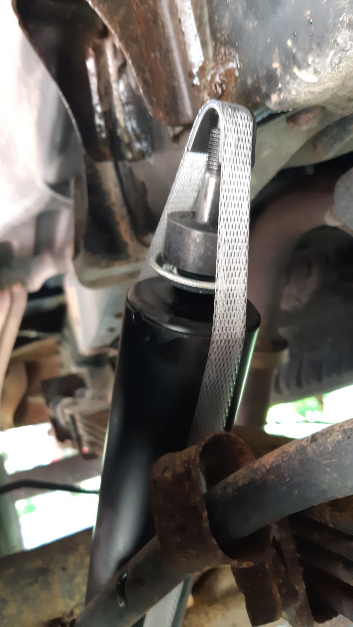

    Pro tip - my new shocks came with a loop of packing strap20200809_124700.jpg to keep them compressed in the box. You can slip this off temporarily to fit the lower bushing then put it back over the shock while you set the lower bolt in, then slip it off again and guide the upper end of the shock into its mount. Saves trying to compress the shock whilst under the vehicle, just don't forget to cut the packing strap of when you're done ;)
