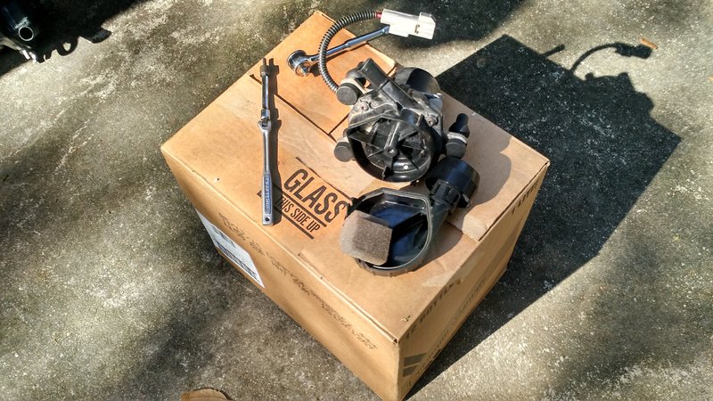

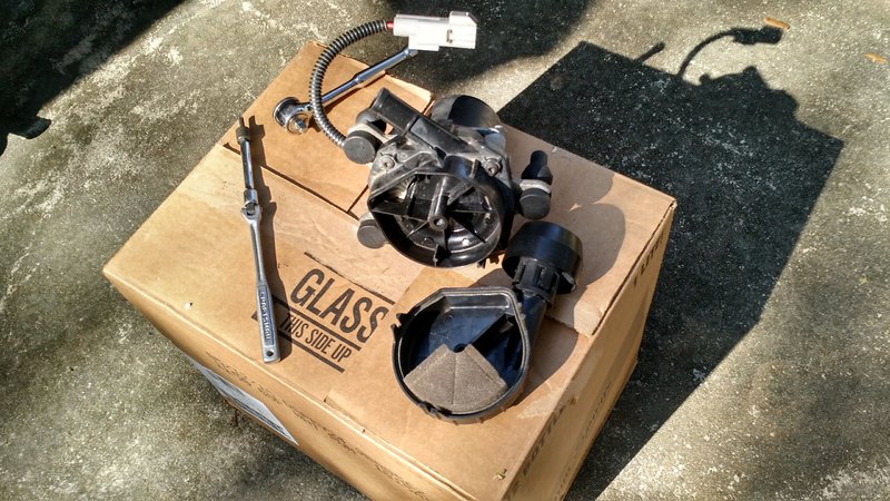

    My air injection pump burn up, I was able to located a used one, before I installed it I opened both pumps. The one that went bad had deteriorated pieces foam jamming the pump impeller, which caused the motor to burn up. I opened the top of the good one, inside is a block of regular foam! I guess this is what comes apart over time and james the pump. IMG_20151113_133554287_HDR.jpg IMG_20151113_133610609_HDR.jpg

    I knew about the foam, I just figure it was a filter though

    Thats exactly what it is for.... i wonder if some wire mesh backing would help it from rotting and falling into the impeller.

    That cheap piece of foam acts as a filter. Over time the foam filter deteriorates and it breaks loose jamming the motor. In which causes the pump to burn up. Not sure if your pump is 8 years or older, if it is suggest to at least get a fresh piece of foam.

    ha! mostly plastic with a motor / fan in it with a piece of foam .. but from what I've read it's the labor that costs so much

    After 8 years that shitty piece of foam starts to crumble. I suggest to just replace it, or remove it and run the intake pipe from the throttle body intake tube. That way it's drawing clean air from the trucks air filter. Another option is purchasing a by pass kit, it only works if the system is completely operational at the time you install it! https://www.hewitt-tech.com/store/

    I wonder why in the hell they didnt do that in the first place!
    I might consider preemptively removing that foam piece and running a crank case breather or something of the sort on the intake of the pump.
