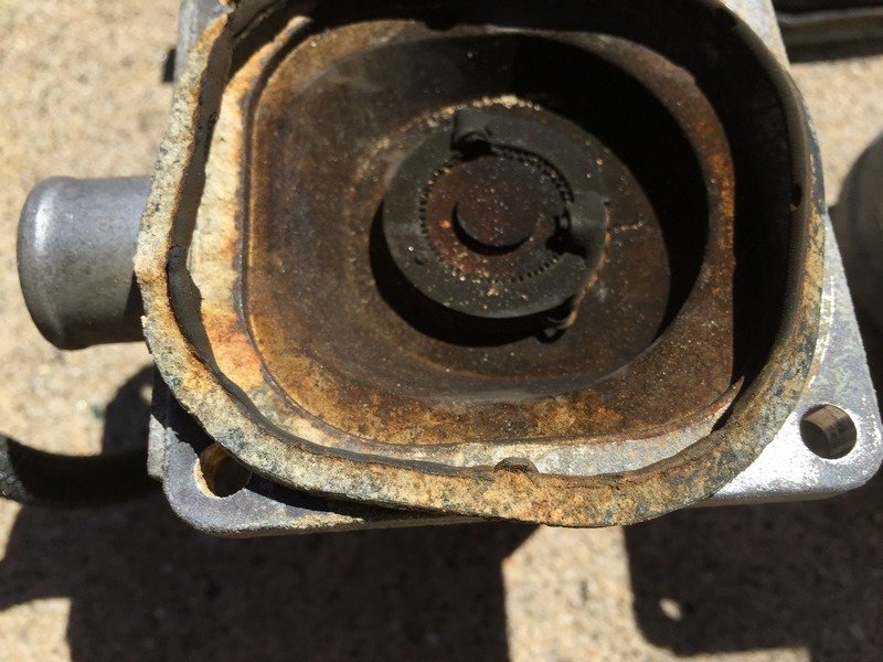

    I replaced the valves today on my 2012 4.0 @ 62K. It was a pretty simple and painless process. The exhaust flange bolts for my front valve were heavily rusted under the head, and they snapped almost instantly when I tried to remove them. Thankfully they broke off in the bracket which was being replaced. Picked up a couple M6x20's at the hardware store. Other than that everything dropped into place. I cleaned and re used the exhaust gaskets as they still looked good as did the exhaust pipe mating surfaces.
    I ordered PN "25710-31022 DIVERTER VALVE" from Toyotaonlineparts.com for $434.18. Great service from them. That part number included both valves, the mounting bracket, the rubber "F" shaped manifold, and the metal hose connector to the pump hose. Everything was assembled and ready to drop in. Total out of pocket is about $460 and about two hours time.
    When I removed the valves I dumped out roughly a cup of water. Upon inspection, the valves are junk. The bolts were all seized, the gaskets are hard and covered in corrosion, the seal on the plunger is all burnt up and will flake off when touched. I can't move the plungers at all.
    Left valve is #1 (closest to front of engine) right valve is #2 (closest to rear of engine).

    YAY! Add me to the list..light went on yesterday..I took the top off the pump and noticed the foam was wet and under it sat water in the little ponds in the plastic molding. Today, I took it everything out and valves look similar, but not quite as bad as THE_END. Guess new valves for me.
    One question though, I understand now why it goes bad, but just replacing will not fix the issue, it's the air pump design that is allowing moisture into the system that causes, correct? Technically, I should either replace the pump with the new design or just do the bypass(more likely).
    2012 with almost 70k. Removal was a breeze for me. I have the pump on my desk drying out..also took all tubing apart to clean

    The way I understand it, the pump bringing water into the system isn't really the problem. Anything bringing in atmospheric air will bring in water to some extent. The main issue is that the pump never runs on shut down to clear the water out.
    It is my understanding that 2013+ trucks run the pump both on start up and on shut down. This clears out the water and decreases the issue. Though from what I've read the 2013+ trucks are not immune.

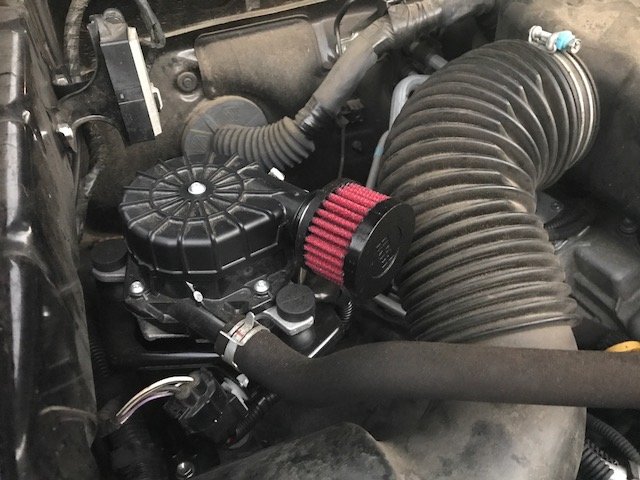

    I removed the foam piece and replaced the filter. I'm really hoping this helps prevent another failure. But it sounds much louder at start up than before I changed the filter. Is that normal?IMG_4133.jpg
  16. Apr 10, 2017 at 9:16 AM
    #296
    vssman
    vssman Rocket Engineer
    Jun 17, 2013
    #106440
    10,570
    Paul
    Naugatuck, CT
    2013 SR5 double cab
    Yes

    The 2440 and 2442 codes are for malfunctioning valves. In my case they were both stuck open, which put my truck in limp mode. I'm not sure why you have a P0418 code after replacing the air pump. I would put your stock one back in, clear the codes, and see if the P0418 comes back. The danger of clearing 2440 and 2442 and continuing to drive is that they may stick open and allow hot exhaust to reach the plastic pump impeller and damage it.
    According to several members the Hewitt bypass requires that your valves are in working condition when you install it.
    Adding the unifilter to the air pump won't fix any problems. It's a preventative measure to stop the stock foam filter from breaking down and getting stuck in the pump fins and burning it up.
