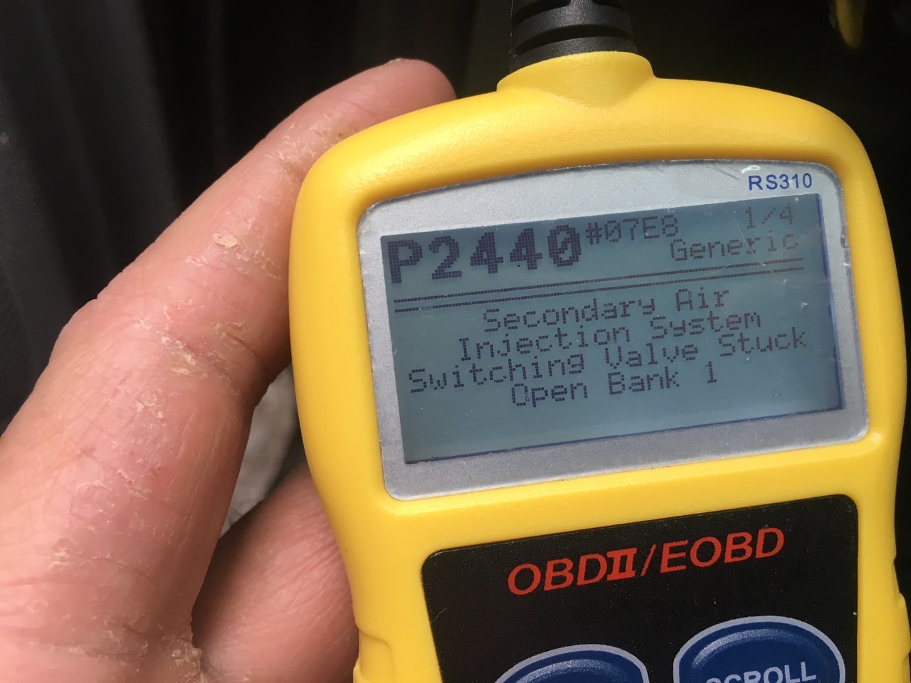

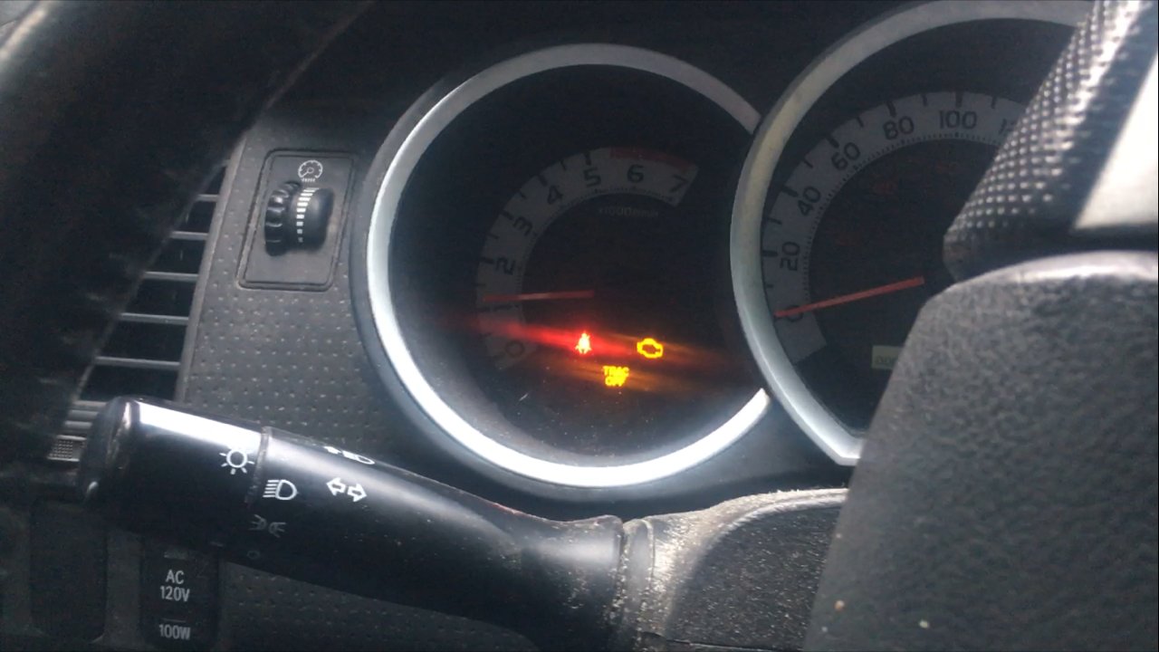

    Talked with my Toyota dealer again with them now saying that they cant see any codes now. I did clear the codes with a borrowed scanner once the vehicle was driven for 45min and warmed up. When I arrived in the neighboring town (usually 1.5 hour drive away)i purchased my own scanned from Canadian Tire with it still showing a permanent error code with no CEL light on. I mentioned this to the Toyota dealer and he told me that after a few starts the vehicle will auto delete permanent codes if it sees no trouble again. This really doesn't sound right to me . My big issue now is if Toyota Canada does start warrantying this air injection system like the USA i wont have any error codes to get my refund. I do have photos of the scanner plugged into my truck with both codes and a photo of my trucks dash with my CEL and traction control light off light on.
    I have contacted Consumer Matters with Global News regarding this matter of Toyota USA warrantying a part but Toyota Canada refusing. At this point i feel like i don't have anymore options. IMG_5408.jpg IMG_5435.jpg

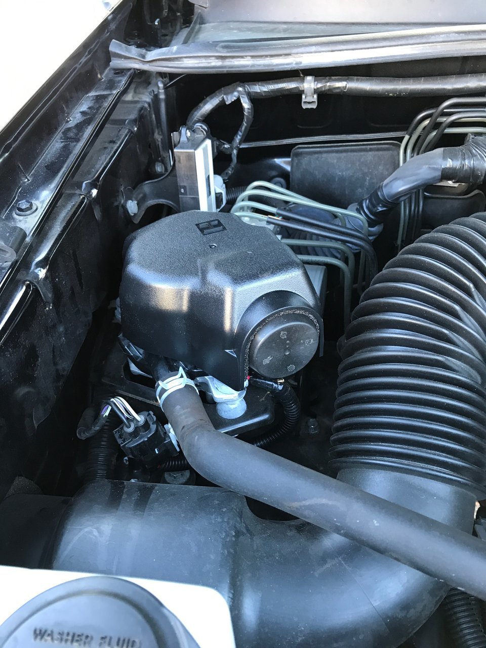

    Agreed. BTW, I just got mine done, of course free of charge. As previously stated, you need to either limp in to the dealership or have proof that those codes were there (if you decided to clear them, as I did). Here is the new setup:
    175908[QUOTED] likes this.
