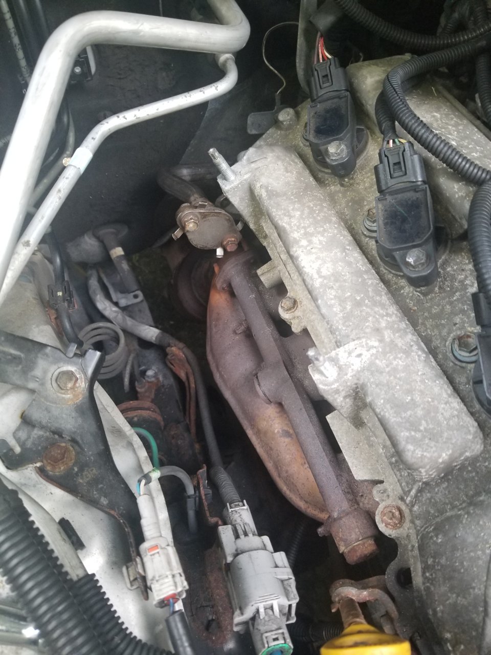

    Shouldn't be an issue, but there is a bolt on the back of the engine just below the intake manifold almost directly center of the engine. It's not easy to access but it's back there.
    From some of the research i have done it seems like the 05-11 headers will fit and block off the ports. But I can't personally confirm that as I don't have headers.....yet. I want to do cam gears first.

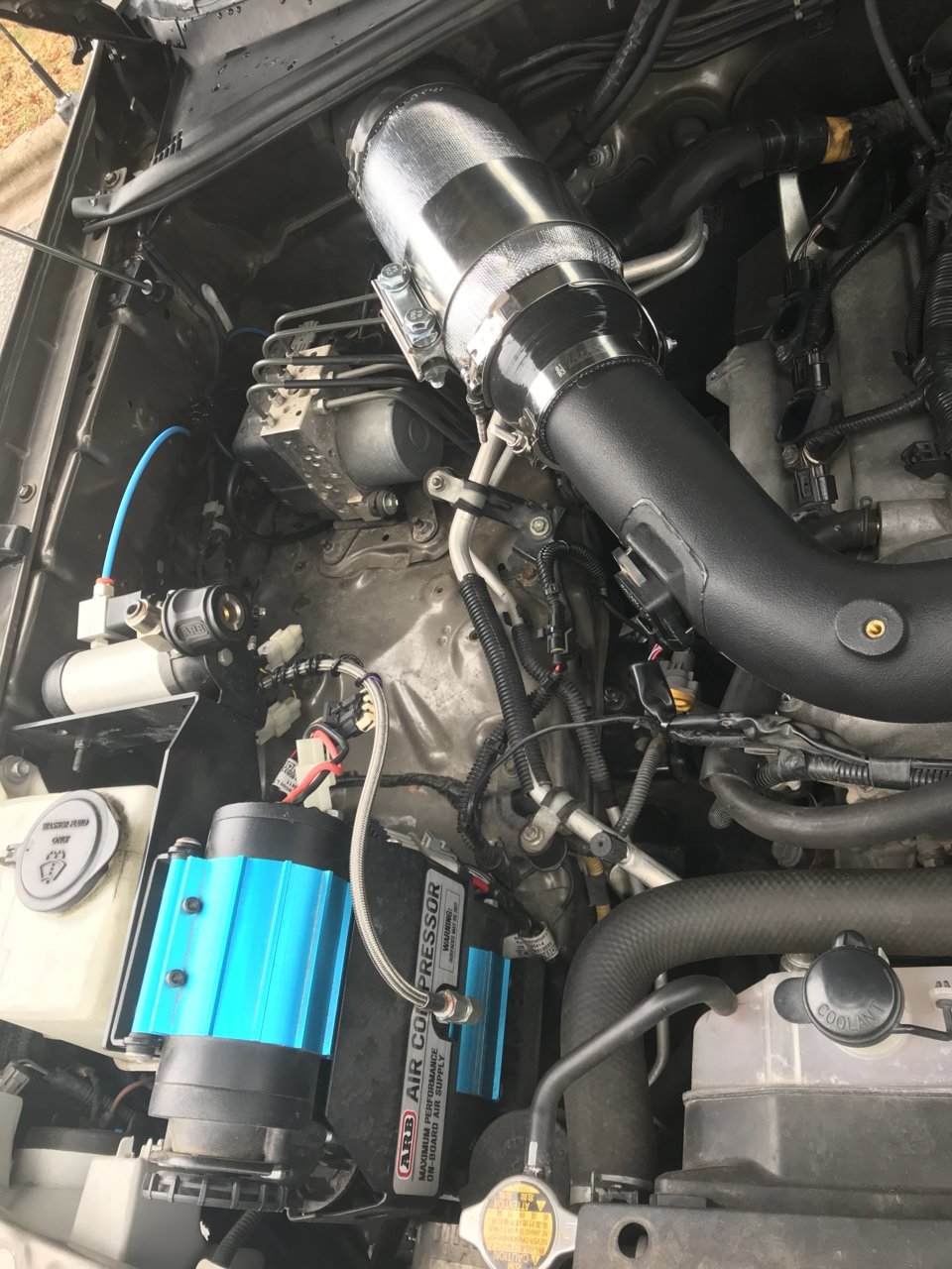

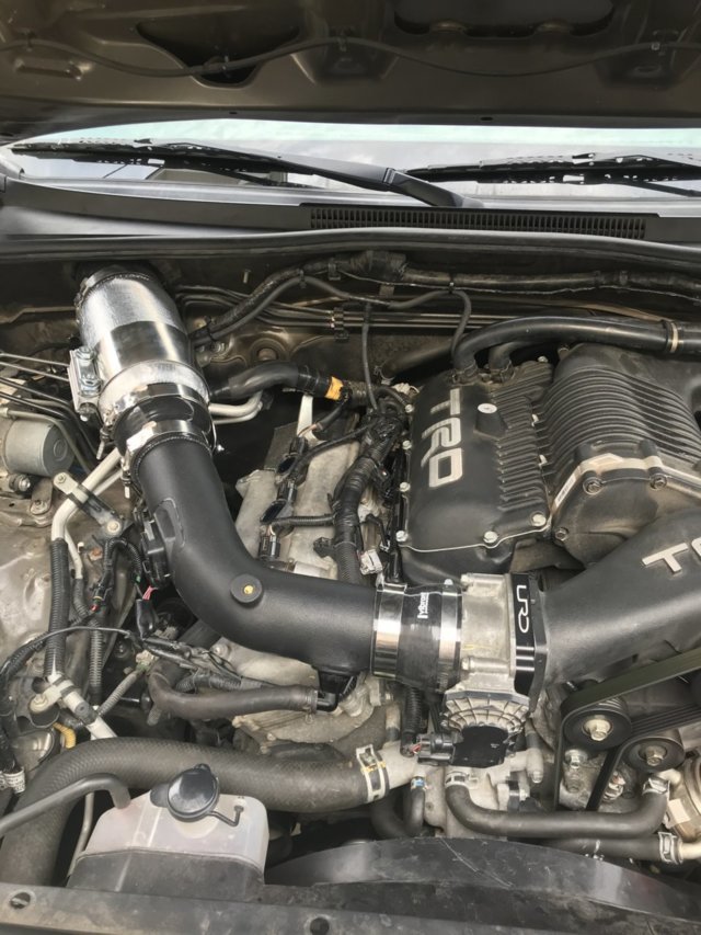

    Can I ask what intake this is? I also have a SC and deleted the SAI. But this intake looks fun

    Looks like it is based on this type of cowel snorkel.

    Shit bolted onto other shit, and junk.
    1 part, FJ pre 2011 K&N
    1 part Spectre In-line 5” conical filter
    Multiple Amazon silicone reducers, 45 degree bends
    Thermal reflective covering wrapped around upper intake
    1 5” exhaust band clamp
    4” cowl hole cut into firewall
    Custom valve cover support bracket
    Tundra throttle body
    URD adapter
    I think that is about it

    Couple guys have done this. My understanding is you need the 12-15 gaskets, which should block the holes.

    Thanks for posting that, cool setup curious though the thermal tape is to help keep the air cooler while in that part of the engine bay?

    Yes. That bulge is where the 4” tubing encompasses the 5” conical filter. It also sits right over top the Bank 1 headers. Being metal, I tried everything I could to shield it from ambient engine bay temps and keep the fresh air coming in as cool as possible.

    Did you mean to write 05-11 gaskets? Those come with the headers then, don’t they?
    so 05-11 guys could also just bolt on 12-15 headers if some were a good deal used?
