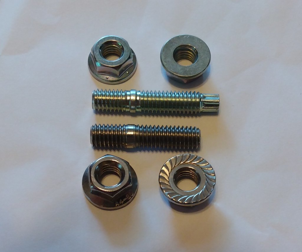

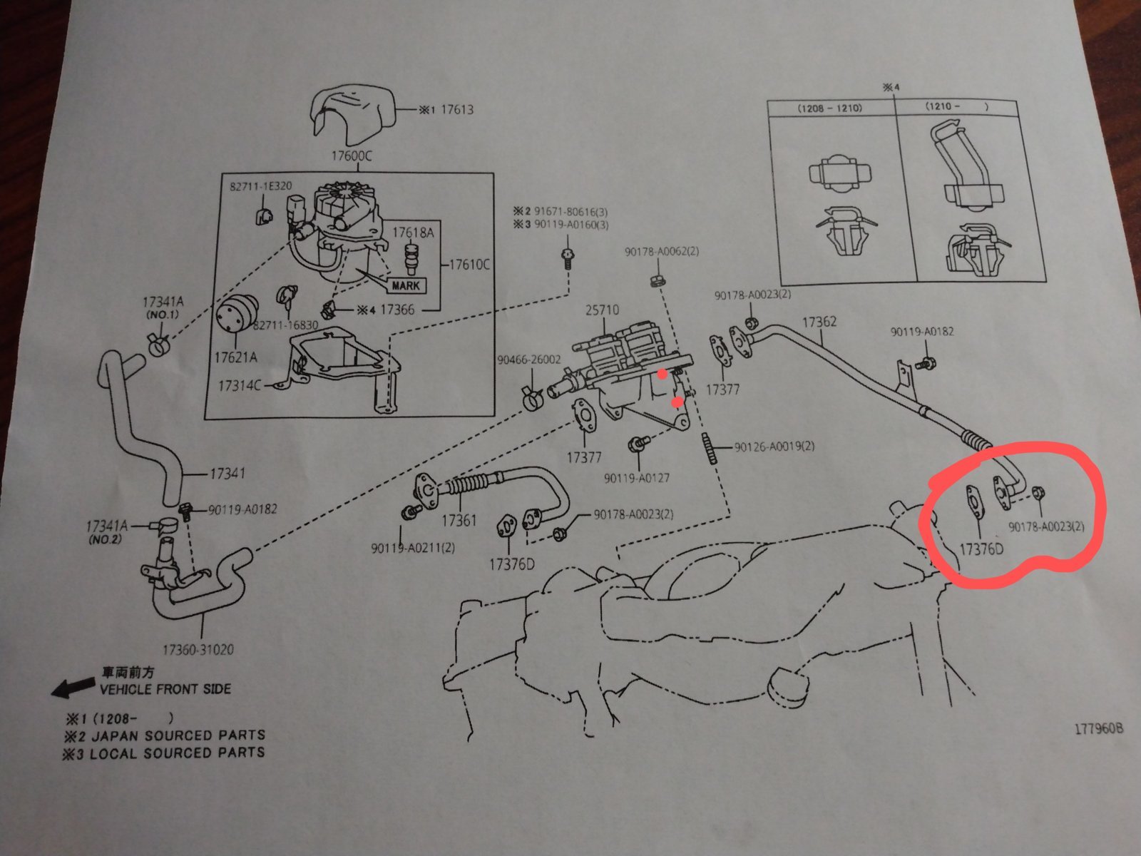

    @TacoFergie, @zippsub9 Any chance you guys happen to have the parts #'s for the studs and nuts located in the OP's pics? I wanted to buy the 4 OEM replacements of each before I install the Hewitt Tech kit. The studs and nuts on the driver's side and the lower one on the passenger side are pretty bad. The torx head of the stud is an E6. D9F468DF-F145-484E-869D-9D48B30E546B.jpg 0CDBAC6D-0589-4AAF-A45C-7AA82AC85F8A.jpg
    I found Toyota (90126-A0019 Bolt, Stud) and (Toyota 90178-A0062 Nut, FLANGE), but would like confirmation before ordering from my local dealer. Good diagrams are hard to come by from most dealers online. Toyota Parts Deal was the closest I could get, they had all the parts listed under the Manifold Air Injection System fit category after putting my VIN# in.
    Anyone else having the part #'s, chiming in would be greatly appreciated.
    Thanks, CY
    **UPDATE** Part#'s above are for the Studs (x2) and Nuts (x2) to mount the entire Air Switching Assembly.

    Why are you wanting to replace the nuts and studs? All the Hewitt kit does is replace the air pump. The valves have to stay in place or you're spending another $250 a pop for their simulated sensors.
    If I did it again, as I've said before, I'd just get the HP Tuner and turn off the SAIS reporting and delete the whole system. The heaviest part is the valve bank, and without spending another $500 with Hewitt, you have to keep it.

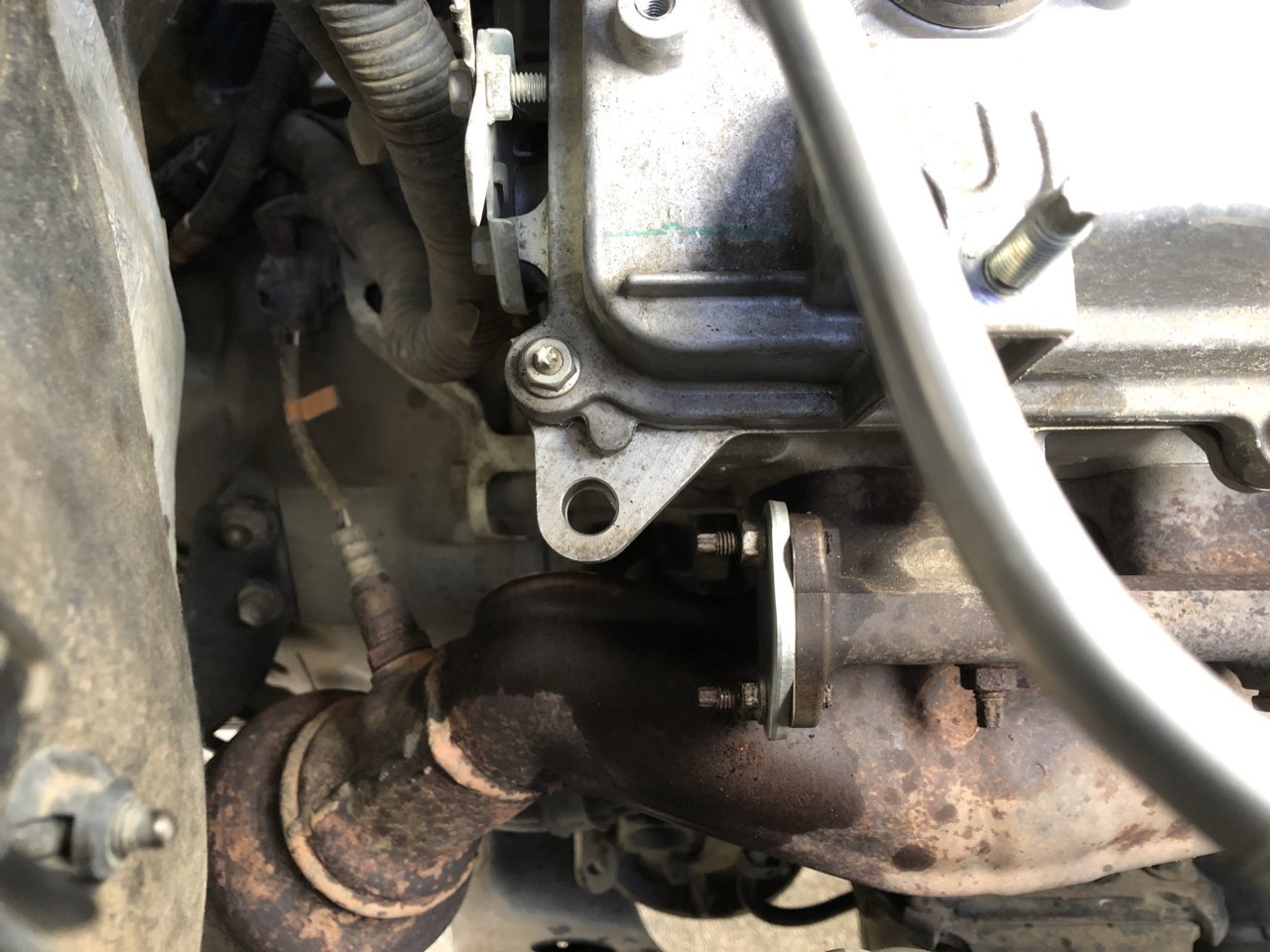

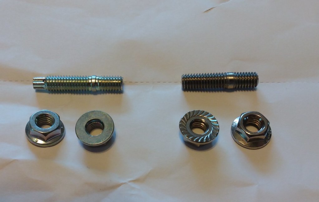

    I bought the whole kit including the simulated sensors, so I can do the full delete(removal) of the SAIS system. The lower studs and nuts where the block off plates go need to be replaced as they are rusted pretty bad. I don't want to start the job until I have what I need. I have the nut part# 90178-A0023 from the exploded pic below, but the stud part# is MIA. I ordered an OEM stud that may be the one, but will post when it is confirmed. Ultimately going to check thread pitch, length, and replace with stainless steel hardware. If anyone needed the gasket, that part# is 17376-50010. IMG_20240820_102754359~2.jpg
    **UPDATE** The correct OEM Toyota Stud part# is 90126-A0014 and comes up as
    Bolt, Stud(For Oil Strainer). The Stud has an E6 torx head and is an M6 x 1.00 thread. The corresponding OEM Toyota nut part# is 90178-A0023 and comes up as Nut, Wire Adjusting and is a 10mm. You will need 4 of each for the block off plates.
    I have found Stainless Steel hardware that I will be using to replace the stock stud/nut combo. The closest to Toyota spec stud I could find was 18-8 Stainless, had no torx head, so a stud install/removal tool will be needed. The nut is a 316 Stainless Steel serrated flange locknut.
    Mcmaster dot com
    18-8 Stainless Steel Vibration-Resistant Stud, Threaded on Both Ends, M6 x 1mm Thread, 27 mm Long Part# 92386A914. Quantity of 4 for the block off plates.
    316 Stainless Steel Serrated Flange Locknut, Super-Corrosion-Resistant, M6 x 1mm Thread, Pack of 25. Part# 92773A101 Quantity of 4 for the block off plates.
