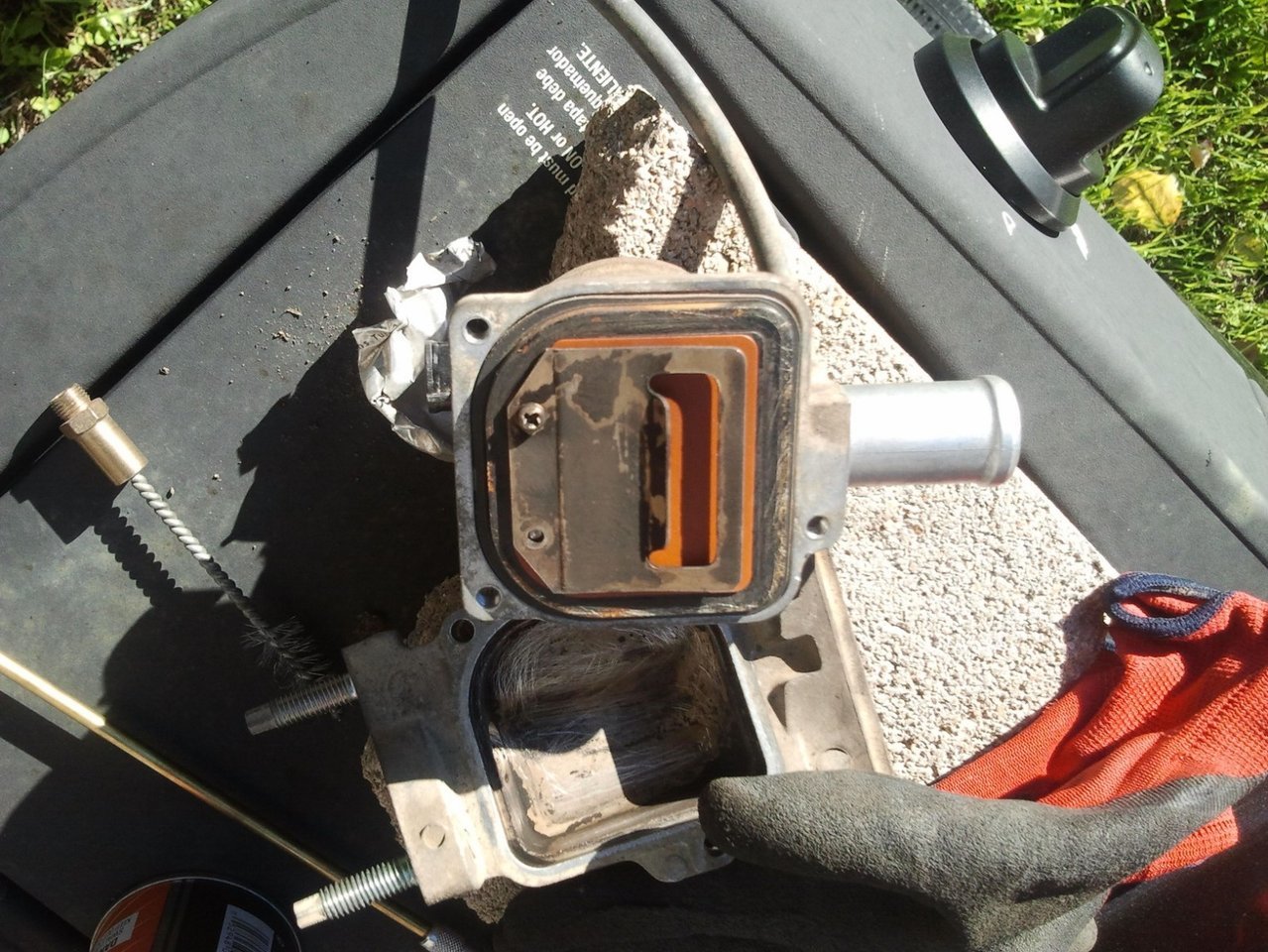

    Well... I took apart the Air Switching Valve. Tried to get it inspected and this is what I found....
    I cleaned it and re-drilled and tapped the screw that I broke off... THESE are the most flimsy screws I've ever seen in my life. Took it to a vehicle inspection place and guess what? My Air Switching Valve code is still coming up and so is my VSV code.... Texas is so retarded with vehicle regulations....

    I had the same issue. P0441 code I think. It would come on randomly at startup during the colder months, but not when temps were really cold. I took mine apart and cleaned it like you did. I ended up replacing it because cleaning didn't really seem to fix it. I'll still get the error code every once in a while but not as often as before. I think toyota rev'd the part at some point because I ordered one and it wouldn't fit on my truck b/c of my DT headers. I had to send it back and get the older part no. Maybe the newer ones are more reliable. I think it's the solenoid that causes the problem.

    Hey afd23a! Yea after I cleaned it I haven't had a CEL come on at all... but, after my failed inspection I plan on replacing the part regardless. I have ordered a rev'd part. I am hoping your DT headers are aftermarket? Which is probably the reason they do not fit? Hopefully my air switch will fit! I think it is the solenoid. I did bend the little copper piece back towards the solenoid though. I might try to get it inspected again and see if it flies this time.

    Got the inspection done with the old part on it. The new part will be put on this weekend. Apparently a little bit of cleaning and it gets the job done. BUT, I still have the new part so I might as well replace it. I guess it is the updated version of the old one.
