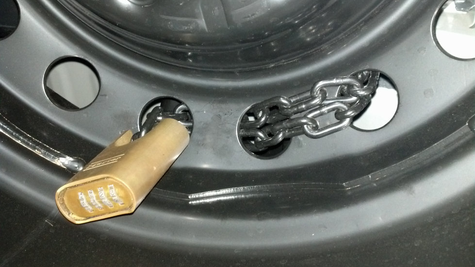

    Is there are way to lock the spare beneath the truck?

    You can get a spare tire lock OEM or aftermarket. I believe it's just a keyed end to the arm that you rotate to lower the tire.

    Padlock on chain:

    There's not a large market for small tires on steel rims, only a desperate thief would bother to steal a tacoma spare

    My spare tire is a full size spare.

    So is mine, but how many thieves are going to check that? Thieves are looking for the easy score, not a $50 tire that will take 5 minutes digging under a truck to get out.
