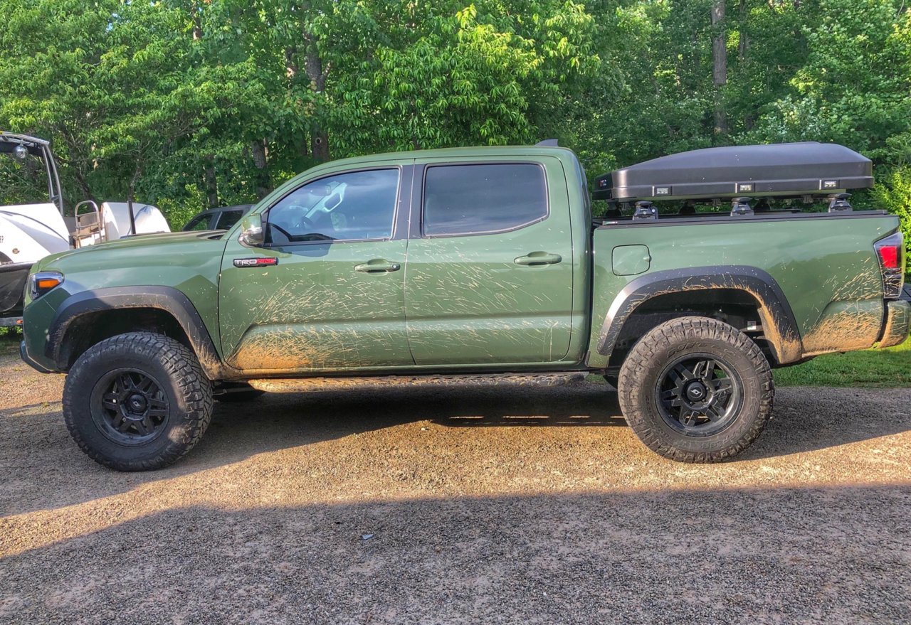

    I have the Dobinson 111-R rear leafs and I am really impressed with how they hold the weight and how they ride completely unloaded. The picture below is with about 500-600lbs of weight to give you an idea.

    Nice setup

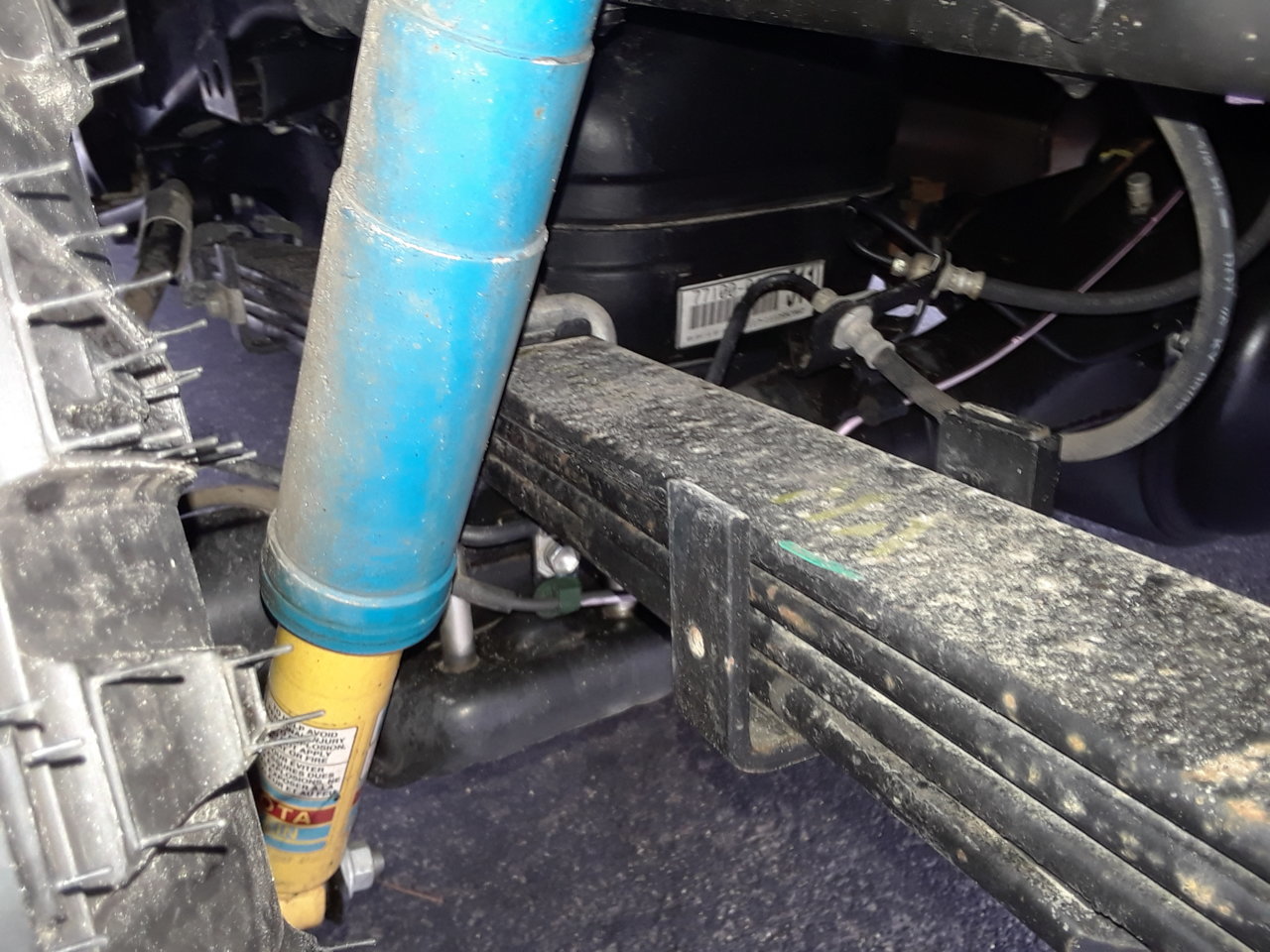

    I'm considering the same. getting ready to lift my truck and saw my rear leafs are flat with almost nothing in the bed20201110_081206.jpg

    I remember seeing some posts about the retainer bolts scratching gas tanks for some users. It was a simple fix to switch the bolts around but something to keep an eye on.
