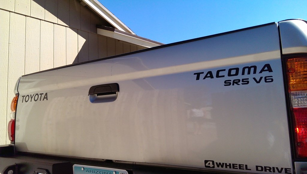

    Nice! What sliders are those?
    And I really liked your vinyl stickers I had to do it myself!

    That's awesome! The black vinyl looks so killer with on the Lunar Mist, very classy sir. The sliders are Trail Gear since I had an Amazon gift card and they were on Amazon with free shipping, I couldn't pass it up. I've seen horror stories about the install of the TG sliders, so I hope I don't have to endure the pain others have expressed.
