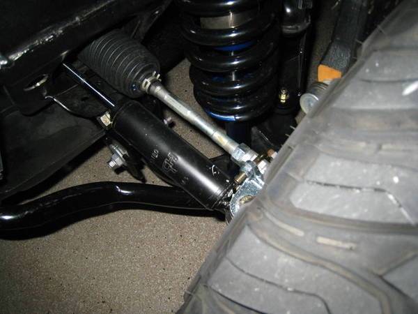

    Steering Stablizers:D:D:D:D:DGot them today and man what a difference very happy with them. :D I posted some pics

    More info?? WHat brand, what kind, where did you get them? How did you install them? etc etc etc.

    A little more info, please. I had a stablizer on my old 4x4 s-10 (steering gear box). Until your pic, I did not know if rack and pin steering could use them.

    Alright Boyz here is the deal-o there are made by FABTECH there not really out yet but coming soon!! There not even on the website nor you will find them on google!
    If you are running 33 inch tires or an aggressive tire that grabs the ruts in the road you truck wonders and don't tell me it doesn't because its f-ing does I hate it!!!!!!! All I can say is IT WORKS REALLY WELL. I had some friends that worked at Fabtech and they hooked me up Not sure what the retail price is I think like 350.00 installed kinda of expensive but worth it.
    See my pics and there is more pics

    I doubt the steering stabilizers will help... Steering stabilizers = shock. It's the same thing as a shock absorber. It's only effective when the wheels are jerked to one side or the other. Same as shock on the rear of your truck dampens the rear when you go over a bump.
    The *wandering* issue you have is probably related to allignment.
    LIft kits will always require a slightly different allignment spec than a stock vehicle. If you take it to the dealership - they'll allign it to 'stock' specs and that won't necessarily help.
    If I had to guess - you probably need a bit more caster and different toe settings.

    Sorry bud but your wrong! When you put agressvie tires say 33inch Toyo MT they will grab the grooves in the rode and your truck will wander, you can actually watch the steering wheel going to the left then right rapidly, then on smooth highway there is no problem.. Your right When you lift your truck with a 6 inch lift then put 33" tires on it you would NEVER set your alignment to a stock OEM setting it would be off majorly. I did these stabilizer's and I can't believe how much better and soild the steering feels. I got hooked up and only paid 236.00 Installed, but i would of paid 500 to fix this problem.

    First of all....he's a she, Janster.
    Second, alignment is EVERYTHING! If you have too much or too little toe and/or caster your truck will wander with stock tires. It is greatly magnified with larger tires.
    Stabilizers only mask the problem, they may help off-road, but if you are wondering all the time, time to check alignment.
    Third, when you lift your truck, you need to set your alignment back to STOCK settings, as that is the best ride. If you don't set them back to stock settings, then what the heck are you setting it to? Just some random numbers???? I'd love to see what would happen if you went to get your truck aligned at a shop and said "don't align it to stock, it will be majorly off"
    The best bet for anybody to get back to stock alignment specs is by adding UCA's, which will greatly help with getting the caster within specs.
    For the record, running 285/70/17 BFG MT's, truck tracks straight as an arrow and CO has some of the worst roads/highways due to the harsh winters

    Brandnew 2008 truck, New rims, new tires, New Lift, and it was
    professionally aligned once when they were done lifting it and again for the re-torque after 500 miles. Trust me anyone on this sight with a LIFTED truck and has oversize MT tires knows what I am talking about, your truck is stock 285/70/17 thats stock!!!!!!! I am running 33x12.5.18 Sorry there pumpkin but you have know have no idea what's happening here. I dont work for fabtech so i dont care who buys them. I know what is was like previous to have them and know its fixed. I never said my truck didn't drive straight!

    Is there a shock mounted on both sides or just what we see from the pic?

    It's all about the allignment.... A steering stabilizer is a bandaid to mask another problem. I'm not doubting the product. It's actually pretty neat... For $350? That's WAY overpriced. What exactly is in the kit?
    I've dealt with my share of larger Mud Terrain tires on the roads and I've dealt with my share of fine tuning & drivability issues.....mostly on a solid front axle Jeep - but I did have 32" tires on my 96 tacoma and never had 'wandering issues'. My 96 was alligned using a Rancho allignment spec for their 1.5" lift kits they sold back then (2000). I don't even know if they still have that kit or have those specs floating around. Lots of tacoma guys would use those specs to allign their trucks.....
