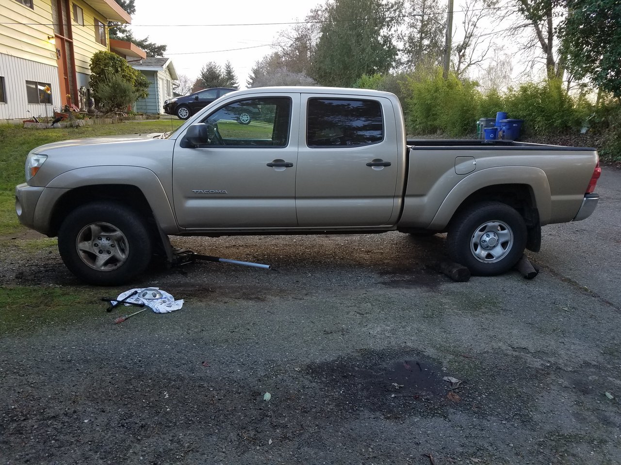

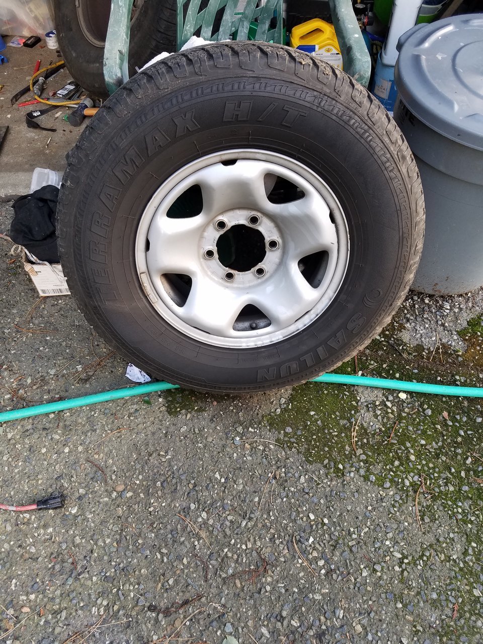

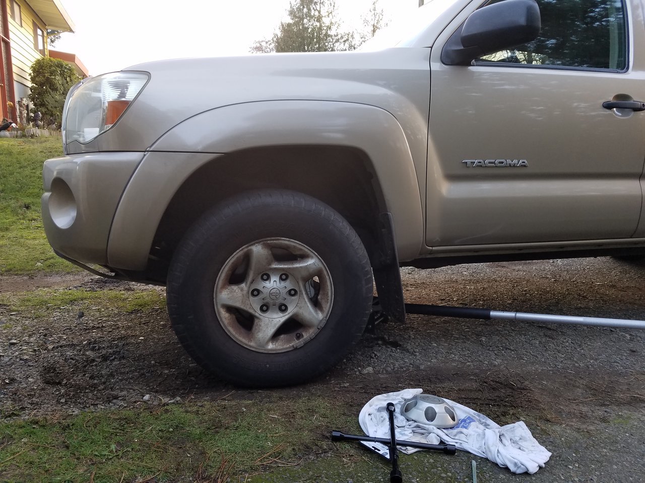

    For a base line I weighed my stock steelies with some 1/2 worn Terramax HTs in 245/75r16 (stock) and the combo comes in at 63 lbs. I ended up picking up a set of used 1st gen Tundra wheels with old Primewells on them for super cheap knowing they had to weigh less, (and I think they look pretty good on 2nd gen Tacos too). So those weighed in at 55 lbs for the combo, a nice 8 lb difference. This is also with them being a size bigger at 265/70r16.
    I just had the rubber pulled off the Tundra rims this week and I was pleasantly surprised that they weigh in at 23 lbs. They also just look damn strong the build on them.
    Anyways so now I'm tire researching and I've found a couple ATs I like, one is 38 the 36 lbs. So I could have an all in of 59 per with 265/70 16s all terrains, which would be fairly feathery.:)
    I will admit it feels a little funny being a weight weenie with a truck, but I figure why not. I'm definitely used to doing it between my old sport bike and my current road bike (pedal).
    Here's a photo of the situation..(The Tundra rims were super dirty hence the $50 for all 4 price, they've since cleaned up pretty nicely.) I'll probably black them out anyways :rolleyes:

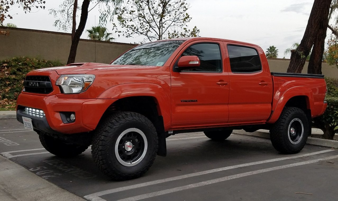

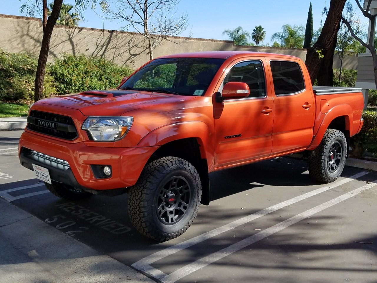

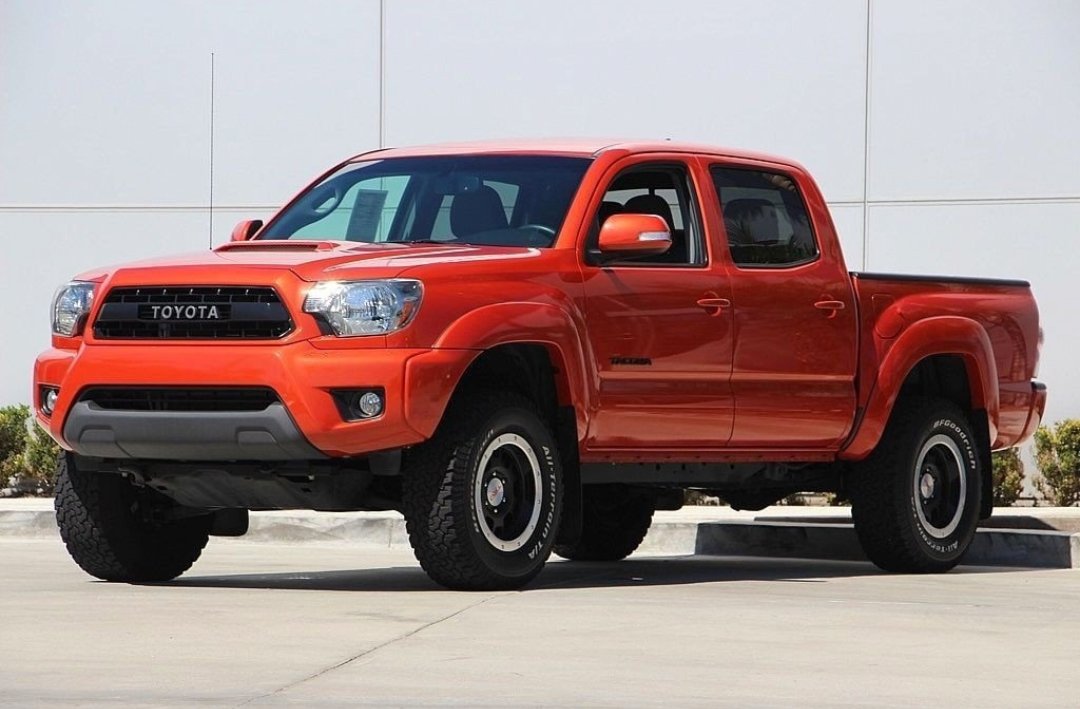

    Nice write up @crashnburn80 ....I went through a similar decision when I went from the original TRD PRO rims and factory BFG tire to the much heavier LT 265/75/16 BFG KO2 load range E tires and I didn't like the drop in perceived performance or MPG's.....
    here's what I found out......my stock TRD PRO rims weigh 23.50 lbs and the LT 265/75/16 BFG KO2 load range E tires weigh 53.57 lbs......so the grand total is 77.07 lbs per rim & tire.
    the TRD 17-IN. MATTE BLACK ALLOY WHEEL - Toyota (PTR20-35110-BK) rim weighs 24.69 lbs and the LT 265/70/17 BFG KO2 load range C tires weighs 45.72 lbs.......so the grand total is 70.41 lbs per rim & tire.
    so the 17" rim and tire combo weighs 6.66 lbs or 8.64% LESS per wheel.....that seem pretty decent.
    So needless to say I sold my stock TRD PRO rims with the almost new LT 265/75/16 BFG KO2 load range E tires for $1,200 on here and bought the TRD 17-IN. MATTE BLACK ALLOY WHEEL - Toyota (PTR20-35110-BK) and the LT 265/70/17 BFG KO2 load range C tires. I switched over the TPMS but I had to buy new lug nuts. It probably cost me around $800 or so to make the switch after factoring in the $1,200 I got from sell my old set-up but I love the new look and it seems to perform better.....I haven't driven much to see if my MPG's went up but I suspect they might.....
    Here's the photos with the original TRD PRO rims and factory tires and the TRD PRO rims with the LT 265/75/16 BFG KO2 load range E tires and also the TRD 17-IN. MATTE BLACK ALLOY WHEEL - Toyota (PTR20-35110-BK) and the LT 265/70/17 BFG KO2 load range C tires....
