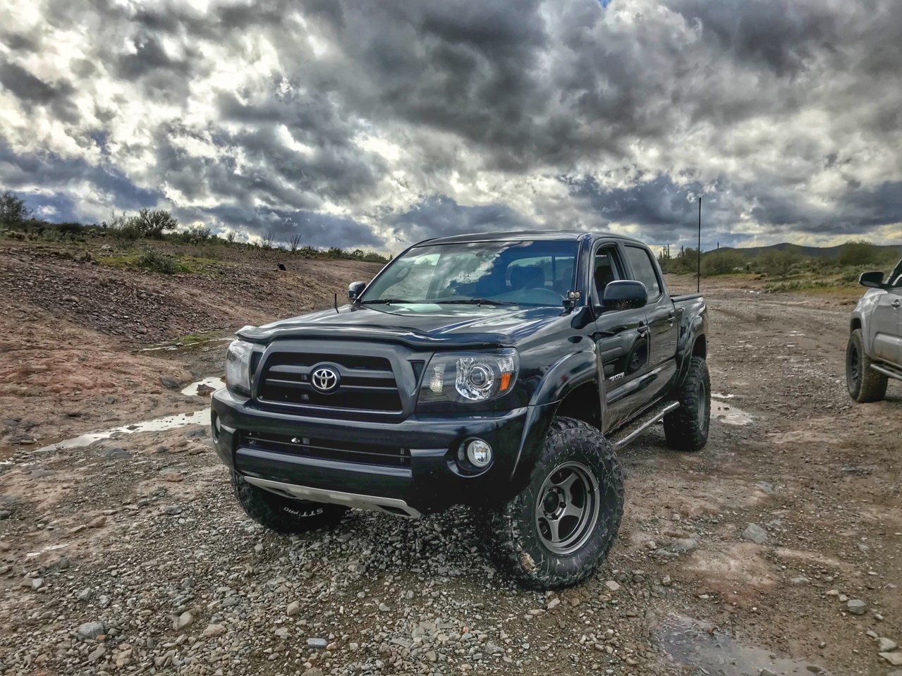

    That last one is a great photo!

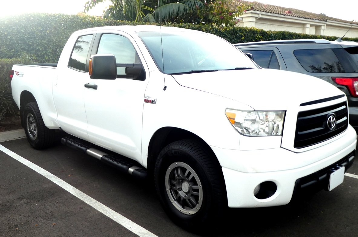

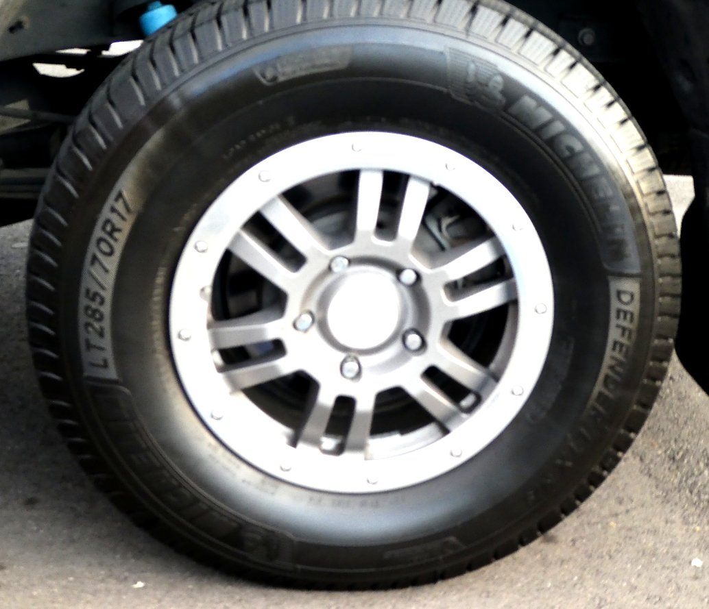

    I decided to order a matching spare Rock Warrior wheel, since these wheels require special lugs, I thought it would be ideal to have 5. Turns out these 4Runner Rock Warrior wheels are a "VIN locked" part, meaning you need the VIN of the vehicle the wheels came on to purchase. Which is not my Tacoma VIN since I bought them NIB off Craigslist. This is like a special club Toyota has created to ensure the most desirable parts are only sold to those who's vehicle came with them, to keep their exclusivity. This seems like a ridiculous business practice. But I was able to track down the original owner of my wheels, whom I purchased them from 4 years ago, he was a little surprised that I still had his contact info and he was happy to provide me with the 4Runner Pro VIN to order a 5th wheel. But it doesn't stop there, after giving the VIN to the Toyota dealer, they have to pass it up the Toyota chain of command to ensure others have not used/abused the provided VIN to order wheels, which then results in the VIN being blacklisted. So I need to wait for 1-2 days for approval from the higher chain of Toyota command before I am allowed to give them money for one of their products.
    Gs4x46mt and lo2hi like this.

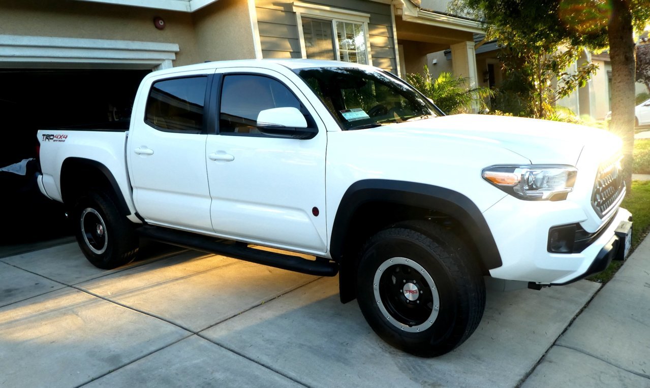

    EEA50262-FB9C-463D-895C-A165CA2E6BE0.jpg 85D5EC34-71AD-442F-814B-567D7A5D2C68.jpg I wanted to post up my setup to this thread as it was a big part of my inspiration/research for my tire choice.
    So I was pretty much ready to pull the trigger on Falken wildpeaks for a long time. Then the night before I was going to order them up I read a few bad reviews and a thread here on TW about them having some issues. I just had a bad feeling. Like a bad juju about it.
    So my decision went to my second choice BFG KO2s. I’ve always loved the look and reputation of these tires and the only deterrent was the higher price for me (hence the Falkens, because they’re cheaper). However sometimes I think what you pay is what you get / buy once, cry once really does have some truth to it.
    The problem with KO2s was they didn’t have the size I wanted in the load rating I wanted: 265/75R16 in a C Load. So I began trying to source some 4 runner trd sema rims but soon realized I was stretching my budget too much to do these and KO2s.
    So I basically went back to the drawing board and came back here first. I then started looking at Wrangler Duratracs and Toyo Open Country AT2s. After some number crunching on tire weights and specs and some review reading, I decided on the Toyos.
    My local tire shop quoted me about $160 more for the set of Toyos compared to the Falkens. But they highly recommended the Toyos and, Toyo as a brand, over Falken in general. Even the owner of the shop runs Open Country’s on his truck. A lot of tire shops that I called did push the Falkens as well so I don’t really know though...
    Anyways, I’ve had my 265/75R16 load C Toyo Open Country AT2s on for about 500 miles. I took them on a long highway trip and then off-road in some high desert sand and gravel. So far they’ve been amazing. Definitely a more comfortable ride than the stock wrangler kevalrs that come on the 3rd gens. The differences/positives I notice are:
    More stability
    More response on off-road features like bumps, off camber sections and ruts.
    On highway - slightly less “bounce” on bumpy asphalt.
    Another interesting thing is that I feel like the 1” I gained in tire height makes the truck stance noticeably better, makes it look more aggressive and I feel like my transmission actually shifts more predictably! This one was unexpected for sure. I might be crazy but it feels better to drive.
    A couple downsides (but these were expected):
    They are louder than my stock tires, but not my much.
    They did seem to drop my gas mileage by about 1-2 mpgs so far but I haven’t had enough miles to really confirm this yet.
    Anyways, stoked on this new setup and wanted to share with anyone who’s looking into this option.

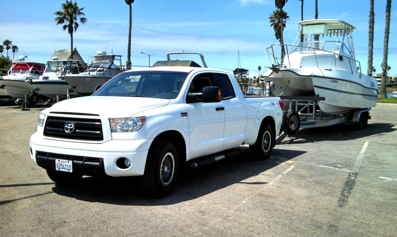

    Tow Dos Gatos.jpg FRONT RT.jpg WHEEL LT REAR.jpg Recently sold my Tundra Rock Warrior-had the terrific wheels on it. A 2010 with 52K miles on it-actually miss it. The size was just too big for a DD, and I have a whole bunch of other cars that I regularly drive, hence the low miles.
    Just bought a OR4WD, and due to nostalgia's sake, when they had their TRD 40% off sale, picked up the faux bead locks. Nostalgia is expensive.

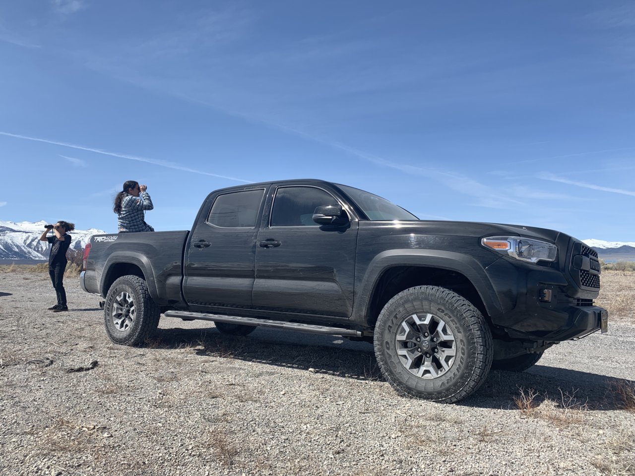

    RT FRONT.jpg RT REAR.jpg REAR EXHAUST.jpg Sorry about the multiple pictures, am a newbie here.
    My new truck. BTW, note the dual exhaust, which is another story for another day...
