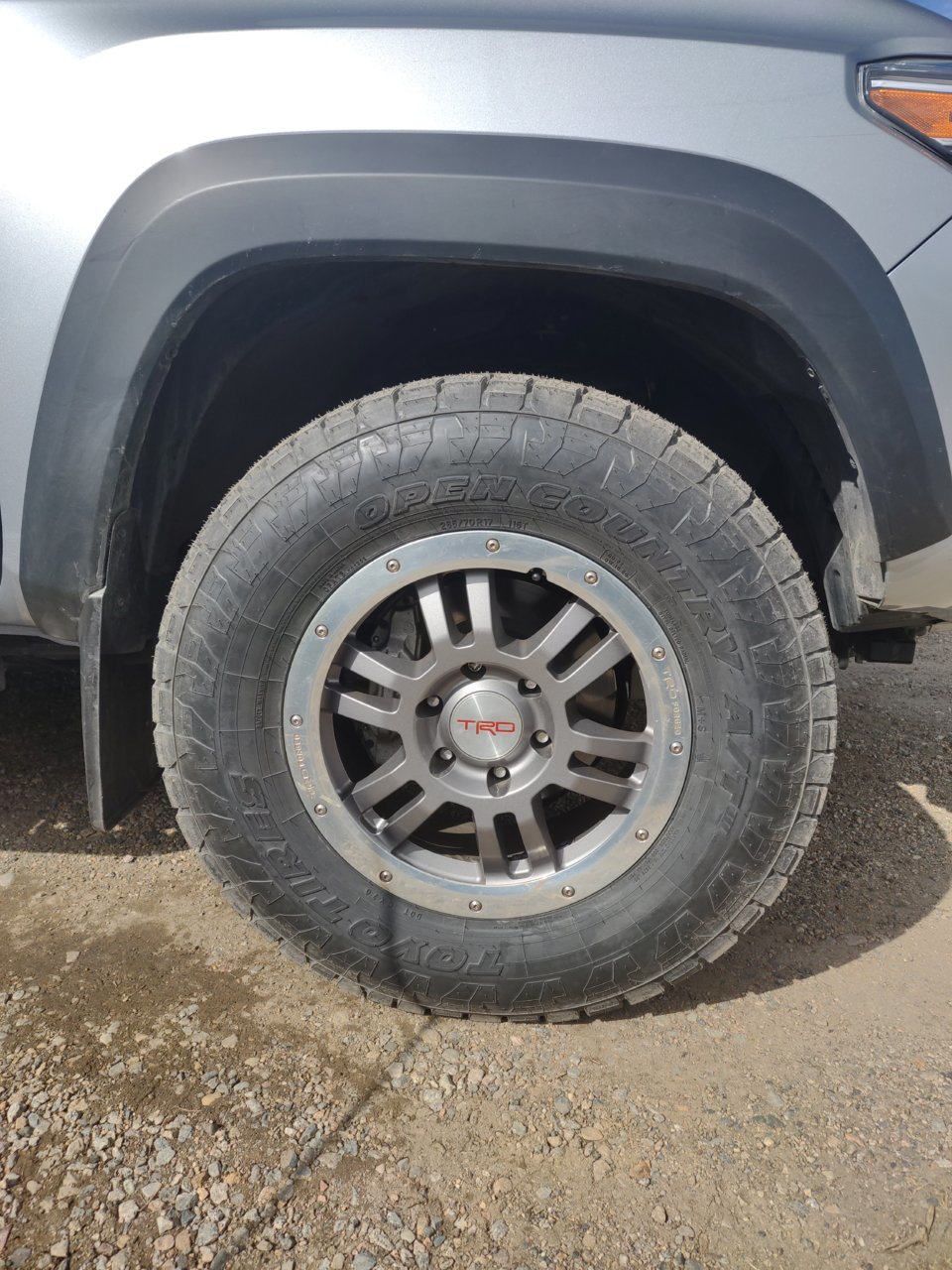

    I run the Toyo ATII's at 265/75/R16's in the "P" rating, according to Discount Tires website they are 40-49lb/each. Was surprised to see the BFG's are 44lb in C rating. Solid.

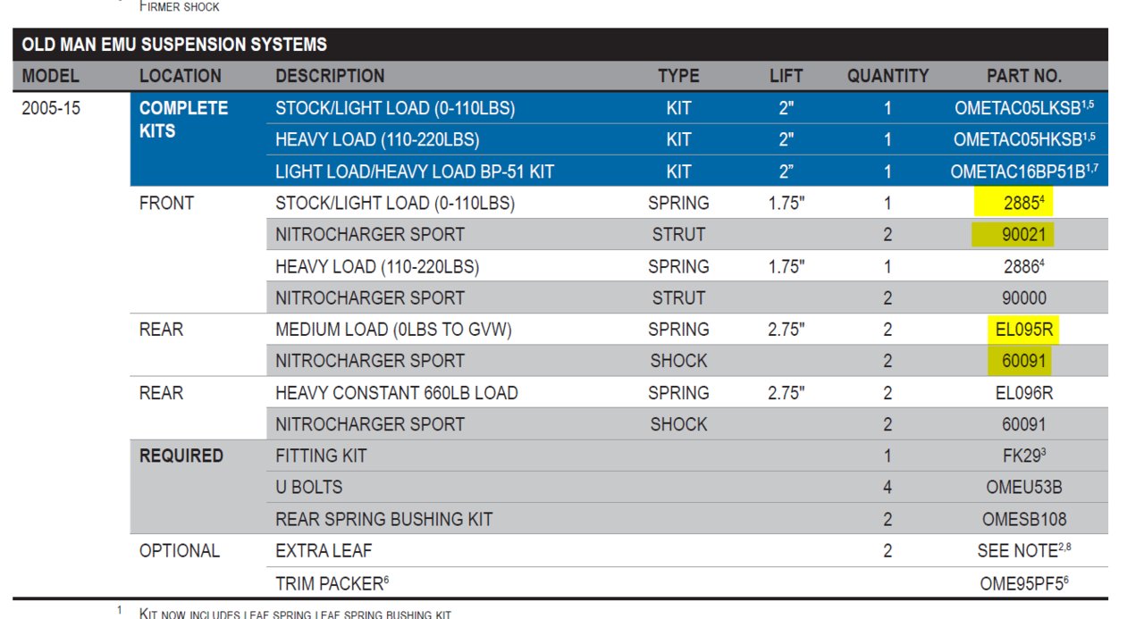

    As I indicated, I opted for a complete kit with 2885 coils and complete rear Dakar replacement leaves. Even with this data, I am still not certain about the level of lift to expect. This is complicated by the fact that I will be adding the following pieces of light 'armor' which may have some impact on the lift, hopefully marginal:

    I took some measurements of the current lift on the truck from the center of each hub to the fender and got the following:
    Rear (left & right) ----> 22"
    Front(driver side) ----> 20.5"
    Front(passenger side) ----> 21"
    I am assuming the divergent front measurements are attributable to a full gas tank and/or the Tacoma lean.
    With these numbers, what is your educated guess about the lift after installation of the OME kit? To forestall any unpleasant surprises, I may opt for the SPC UCAs.

    I have the PT75835080 "Baja" wheels with Toyo ATII's in "P" rating tires. Discount Tire has the weight range for the Toyo's at 40-49. Assuming since my tires are the P rating and should be closer to the lower end of that weight range (assume 43lb/each?) that would put my total wheel/tire weight rating at 66lb/each. I should remove a wheel and weigh it to see how close it is.

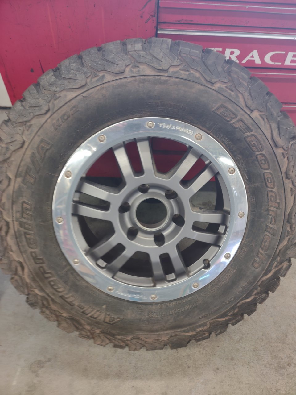

    Brand new 2019 255-75-17 BFG KO2 C rated on the 17" Rock Warrior weighed 72.5lbs on my scale.
    BFG says that tire weighs 45lbs.

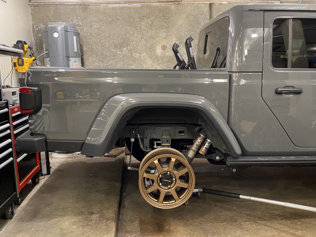

    I’ve been doing a lot of hunting for light weight wheels lately and thought I would share this one. A light weight option to consider for Tacoma 16” is the 16x8 +0 Vision Flow 351. Reasonably priced and only 21lbs, they are 2lbs lighter than the stock 2nd Gen OR 16x7.5s. My old TRD Rock Warriors were 17x7.5 +6 offset. So the Vision Flows at +0 will move the wheel 6mm further out to the fender.
    https://www.visionwheel.com/wheel/14765/VisionWheel/351 Flow?finishID=3293
    The wheels have a hub bore of 110mm vs the Tacoma’s 106.1mm, so hubcentric rings for 110mm->106.1 are recommended.
    I went through the same for my JT dropping weight for 17s from 24.4 to 24.0 while moving the wheel out 7.2mm toward the fender and increasing wheel width from 7.5” to 8” to support 37s with the Vision Flows.
    Warning Jeep pic!

    They aren't horrible. They just really look like aftermarket wheels. One spot where TRD carries a lot of weight is at the wheels (PUN definitely intended.)
