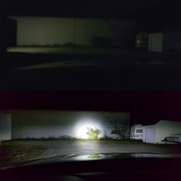

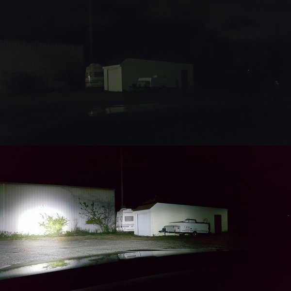

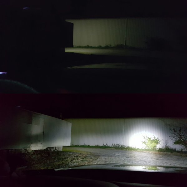

    Another output shot with the Cali Raised 5D Combo with stealth brackets. Just regular stock headlights on second picture

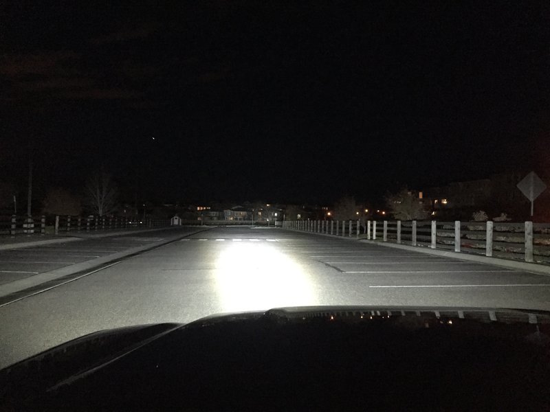

    Looks like your bar needs a little bit of aiming.

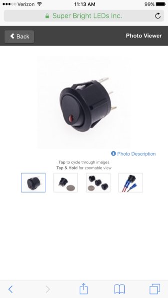

    I'm pretty sure they look like this... I didn't get the light bar but, I did get the ditch lights and harness and the switch looked like this.

    oh ok thanks. I was looking on google and found these. [​IMG]
