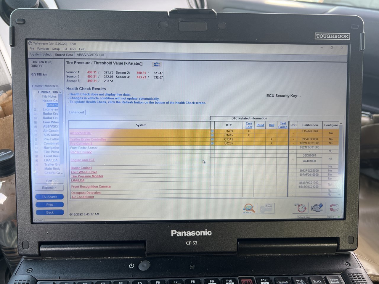

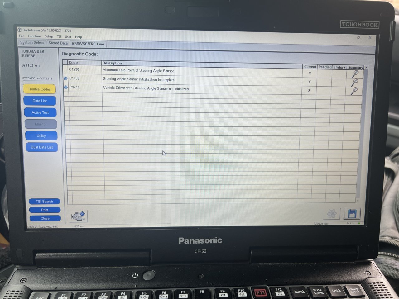

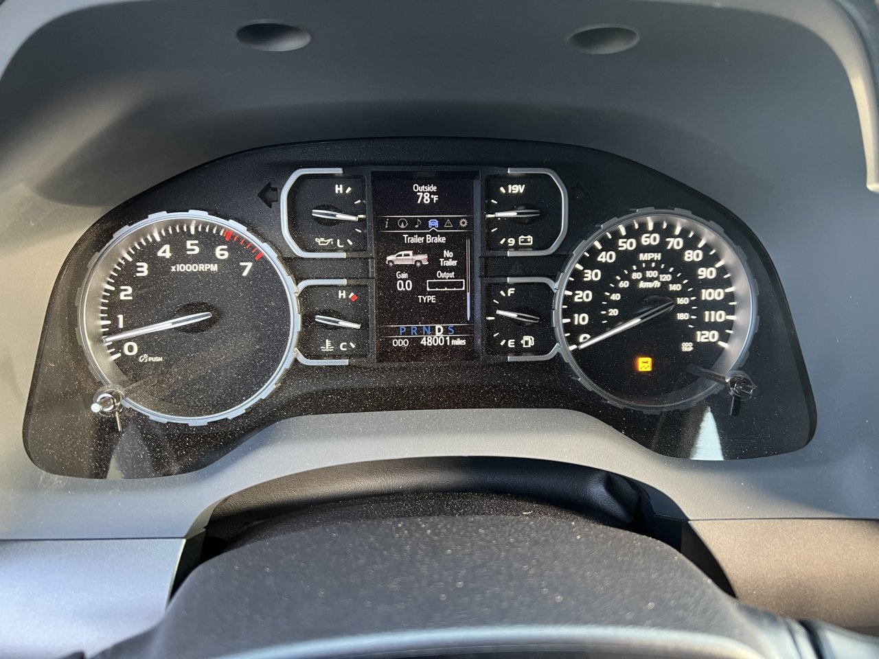

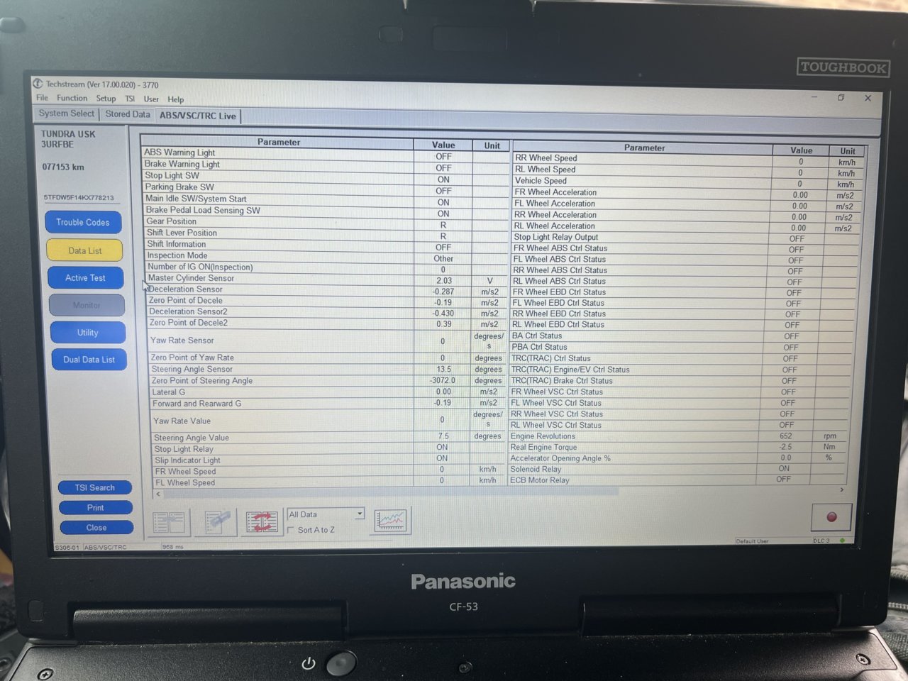

    Original problem started with a bad cell/replaced battery but, due to low voltage this kicked my steering angle sensor no longer any good. Replaced with new but tech stream shows per readout -3072.0 degrees still after replacing new part these images below are what is currently happening Im not sure where to start.. driving for 10 minutes or so the VSC intermittently shows up once or twice on dash and then the pre-collision kicks on along with the trailer brake. They can be cleared but will appear after a short drive.
    maybe this forum could lend some help!..

    Ok different code
    Set up the exact same way as before.
    Set parking brake
    Clear all the codes
    Do a signal test
    Redo 0 point.
    Double check no codes before you drive it.

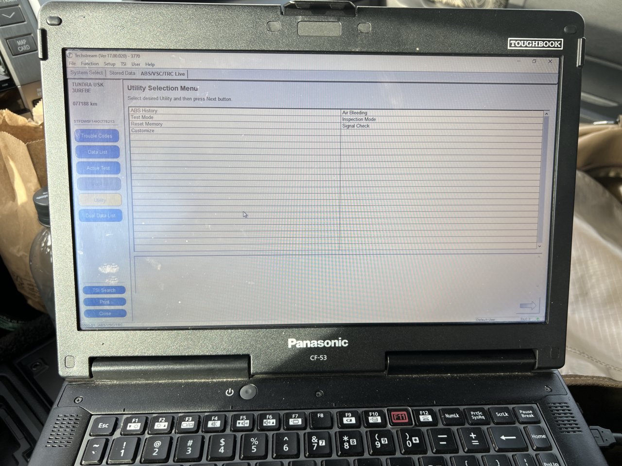

    how to perform signal test? This is The cluster per VSC6B519086-AE3F-47DE-9994-CE705D5F6FA0.jpg
  11. Jun 17, 2022 at 6:35 AM
    Tacoma Mike
    Aug 6, 2011
    #61230
    31,151
    Southern Maine
    It’s in the techstream Same page where you did the zero point

    For these different tests in the utility selection menu- ABS/VSC/Trac per reset memory, test mode, and signal check. What exactly needs to be done first, how each one requires a specific key on and key off cycle or a driving procedure needs to be done during.
